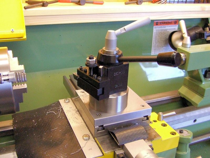

                    If you haven't yet a design in mind have a look at my ** Cross-Slide Toolpost ** for the WM250. Fabricated from steel and doesn't use anything quite as big as 6" x 6" x 3" Article is quite lengthy but also covers fitting a QCTP.

                      I recently made two tool posts based on the above designs. I used steel as I avoid cast iron unless necessary, due to the mess. A significant improvement in rigidity especially with parting. Well worth doing. Materials from M-machine.

                                            Bit less machining in this one! Link in post above.
                                            Can be used with either a QCTP as shown or with the original 4-way toolpost.
