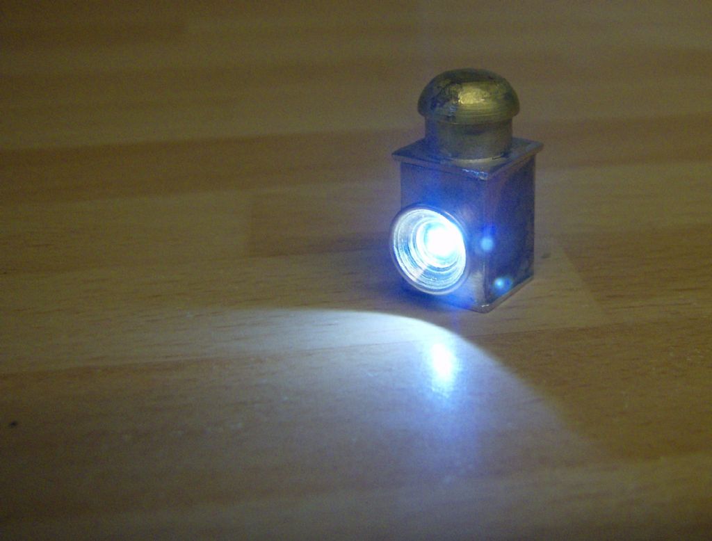

                            #319052
                              Here's one I made earlier
