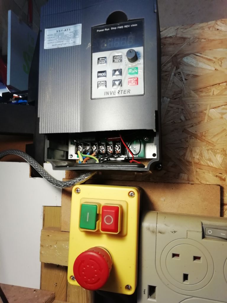

      I have an issue in that when I start my lathe the readouts start incrementing without me doing any machining. Could it be an earth issue? I know all my wiring is correctfor the lathe to run with the vfd.

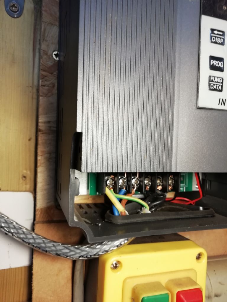

                OK, both have screened cables and the dro works normally with the vfd switched off, also with it on but motor not running.
                vfd connections are as below:-

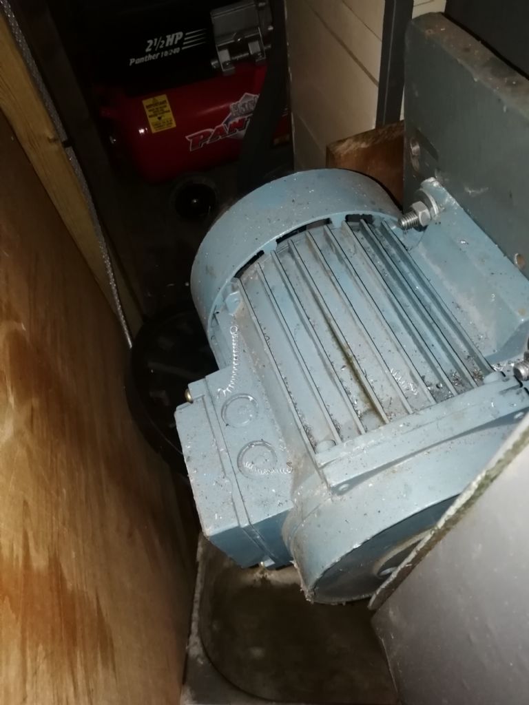

                and the motor is earther inside the box

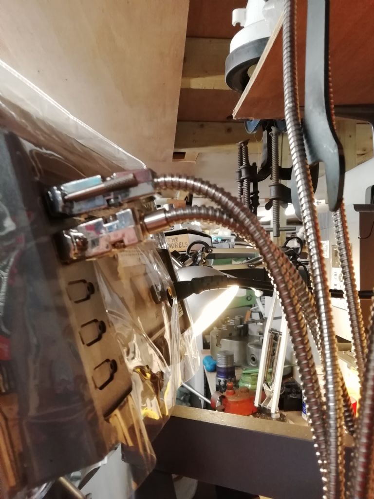

                DRO screened cables:_
                These are both plugged into the ring main in the workshop.

                        Do you have a suitable EMI Filter between the mains power and the VFD?

                          Do the DRO reader head cables run parallel to the motor cable from the vfd?
                          If you disconnect each DRO reader head in turn does it still happen?
                          Where is the DRO display situated in relation to the VFD and motor?

                            The motor cable is running in the opposite direction to where the DRO cables are.
                            I'll try that when I'm in the workshop tomorrow.
                            The display is approx 18" (1650mm) away but at the same height.

                              Rodger, If all seems OK with the motor not running, then its likely the problem lies with the connection from the VFD to the motor, or the VFD/container grounding. If the motor is not running, then the VFD is not producing the "modified" drive sinewave outputs (actually composed of square waves). The edges of these square waves are usually what produces the interfering harmonics, so if the motor is not running, then any interference is much reduced.
                              Make sure the earth(s) you mentioned are made, then check that the motor cable (which appears to be screened in your photos), is firmly connected, and that one or both ends of this screen are also grounded. If that doesn't have any effect, then I would try re-routing the motor cable. These are the simple possibilities, and must be eliminated before moving on to more laborious checks, otherwise you could do a lot of work for nothing.

                                  The problem is the VFD.
                                  You need to connect the screens of the mains and motor cables to ground. This ideally needs to be done for the full 360 degrees of the screen, not just a pigtail. Ideally this is done with a metallic cable gland at the wall of the metal box the VFD is in. Or SHOULD be in. as an alternative some VFD suppliers sell a metal plate that screws to the drive and has separate metallic clamp for mains, motor and control cable screens and earth terminals.
                                  You are wrong to assume that VEVOR areapproved because you boght it from their UK webstore. It must have been a while ago as you will find that currently they sell NO electrical equipment from their UK webstore. This is because it was being stopped at the ports and destroyed or sent back for non-compliance. My personal view is it is dangerous junk.
                                  Apart from that NO VFD of this style can correctly be CE or UKCA marked because they are a component, not a finished product. They need enclosures, filters (some are built in) fuses, cable strain-reliefs (or properly rated connectors) and controls. Your installation does not meet basic safety requirements.
                                  As a minimum you need a proper filter on the mains input and earthed screens as above. To meet accepted safety standards vhe VFD must be in a box. Ideally this shoud be metallic but as a minimum it must have a bare metal plate with the filter and VFD mounted on it.

                                        The mains lead 'looks like' screened cable, but has holes in the braid big enough to put your head through and will leak like a sieve unless there is also a foil screen we can't see.
                                        The VFD is in a plastic case so no screen.
