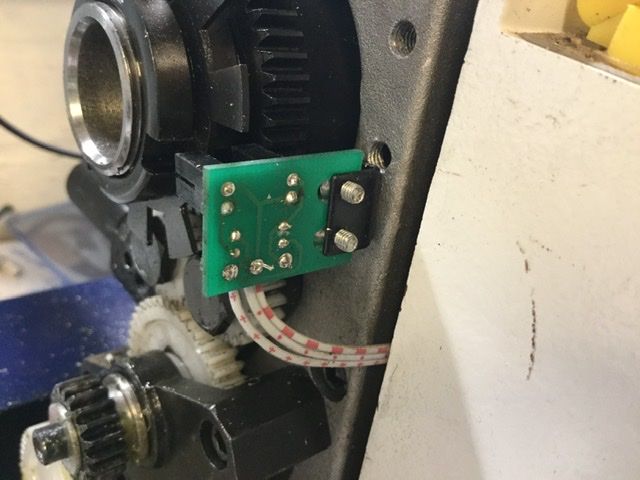

                              Stuart Smith 5
                                @stuartsmith5
                                Colin
                                I have the same lathe as you. I have taken a photo of the opto sensor board and measured the voltages.
                                As you can see, the cables are marked with a '+', a dot and a long dash (left to right) . I have confirmed that they are + 5 volts, ground, and output (left to right again).
                                Output is about 5 volts when power is on but lathe is not turning. ( the output is biased to 5 volts by a 10 k resistor on this board.) It is pulled down by the sensor when detecting pulses. With the lathe turning, I measured the dc voltage using my multimeter and it was about 2 volts and dropped as the speed was increased. This would be a simple check if you don’t have access to an oscilloscope.
                                There are 2 resistors on this board. The top one ( nearest the sensor) is 10 k and is connected between + 5 volts and the output to bias the output high ( ie to 5 volts). The bottom one is 300 ohms and is the current limiting resistor in the feed from the 5 volt supply to the LED of the sensor.
                                I don't know if this is any help, but at least you will know what to expect at this board.
                                I don't think that the diagram posted by Steve earlier can be the power supply circuit for this type of speed sensor as this would not provide enough current for the LED with a 10k resistor in circuit.
                                I am going to be dismantling my lathe in the next few days to change the gears and bearings, so if you don't resolve the problem by then I can measure the volts and take some photos on the circuit boards on mine.
                                Stuart
                                #449935
                                Stuart Smith 5
                                  @stuartsmith5
                                  Colin
                                  Just an extra point to my previous post, with the lathe on but not rotating, the output is just under 5 volts when one of the vanes is between the sensor and about 1.3 volts when a space is between the sensor.
                                  Stuart
                                  #449951
                                  John Baron
                                    @johnbaron31275
                                    Hi Guys,
                                    That makes sense, the opto device is the same as can be found in almost any printer made. From memory the LED in them requires around 5 ma which would mean that the PSU shown has the wrong value for the 10 k resistor if that is the correct circuit diagram.
                                    If the wiring markings are as shown in the picture, is shouldn't be difficult to trace them back to the PSU.

                                      Stuart Smith 5
                                        @stuartsmith5
                                        Colin
                                        Correction to my previous post, typo crept in . Should be :
                                        With the lathe on but not rotating, the output is just under 5 volts when one of the vanes is between the sensor and about 0.13 volts when a space is between the sensor.
                                        Stuart

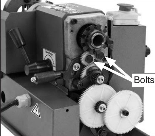

                                                  Colin LLoyd
                                                    @colinlloyd53450
                                                    Hi Guys – sorry about silence – but a few other jobs have got in the way. I tried to supply 5v to the Digital display – but without success – perhaps the digital display board itself is the culprit. In the meantime I have added a magnetic proximity unit to the gear cover with a small rare-earth magnet on one of the vanes of the rotor. This seems to work fine – although it does mean another wall plug for the supply. I will continue to investigate – but the immediate problem i.e. not having a digital RPM meter has gone away.
                                                    Stuart – one of the first jobs I did was to exchange the bearings for angular contact bearings – although I was advised (too late) to actually install taper bearings. I also did an experiment on the effect of pre-loading on the temperature increase in the bearing housing – see the following
