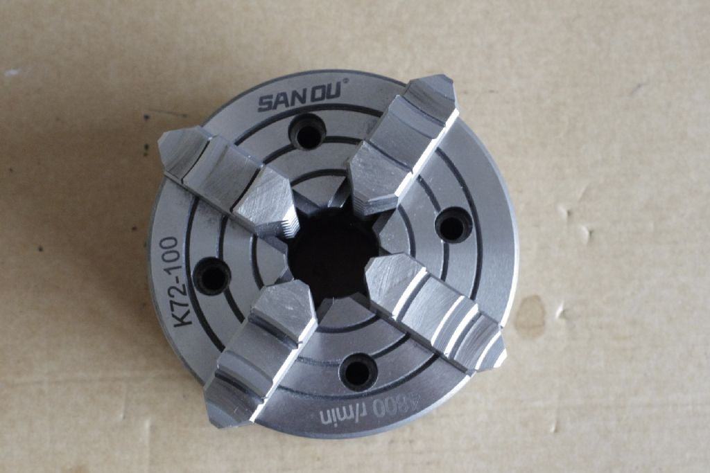

                              _igp2582.jpg_igp2581.jpgI bought two chucks for my 7 x 12 lathe because the originals were poor quality, an 80mm three jaw scroll which was a direct replacement and a 100mm four jaw independent which needed some machining for it to fit. The sizes are perfect for such a small lathe and the chucks, both Sanou make are much better made than the originals which had a Spanish name, but were made in China. Having another lathe which can easily hold 100mm made it easy to modify the four jaw to fit directly. The Smart & Brown model A at the museum is a 9 x 20 which is perfect for a 5" three jaw scroll chuck, we have a 6 3/4" Pratt with serrated jaws for it, but it rarely gets fitted because of the size.

                                                    Nick, the 4-jaw that you show is quite a slim body version and if I remember them right hollowed out at the back and direct mounting.
                                                    The one the OP mentions is not so slim and also has another 15mm or so of backplate thickness to add to the mass that needs to be got moving. Total thickness with backplate is likely to be 70mm or so.

                                                      Hi JasonB, yes it is fairly slim body, which in itself is quite light, but the jaws and the fixings are a reasonable weight, but I did have to make a backplate for it to screw onto, to be able to fit it to my mini lathe and in all it weights around 256g whereas the 80mm chuck weights around 146g.
                                                      Here's a photo of the back side of the chuck with the Backplate that I made for this and couple of other small screw-on chucks.
