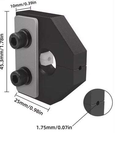

      Sometimes when printing, we come to the end of a filament reel and need to feed a new reel in, mid way through a print.
      Normally I just feed the new filament into the extruder motor port while the printer is printing and this works, but until the new filament is completely through all the way to the nozzle, any filament retractions cannot work – all that happens is that the new filament retracts inside the Bowden tube but obviously doesn’t pull the last piece of the old filament back.
      Can anyone suggest a way of successfully joining filament ? I have tried various plastic glues and hot-gun glue, but none seem to work.

          Is that really a problem? As long as the feed pressure is released the material extrusion should stop as well. As for joining filament the simplest and safest option is to melt them together. here are some ideas:
          How to Join, Fuse or Splice Filament Together

            There a quite a lot of filament joiner tools around. They just hold the filaments to be jointed in the correct position. You heat the ends to join them. The tool can the be opened to get the filament out.
            Joiner There a few ideas on thingiverse. Useful for people who make filament from plastic bottles. Search for “petamentor” if interested. There are other projects also with their own ideas.

              Quite a few on Amazon under < filament joiner >.

                Ah, thanks all. It never even occurred to me to ask Mrs Google !
                What Fulmen and SteveF found looks to be just the job !
