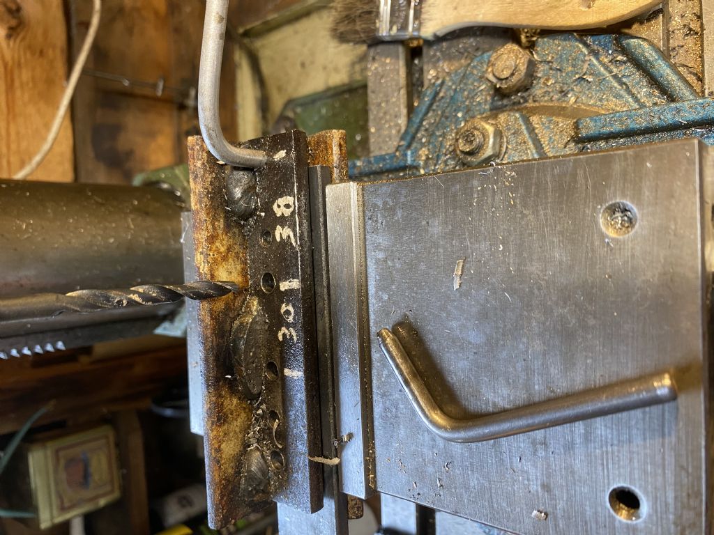

      This is mainly for beginners who may be faced with a repetitive job and how a simple drill jig can help.

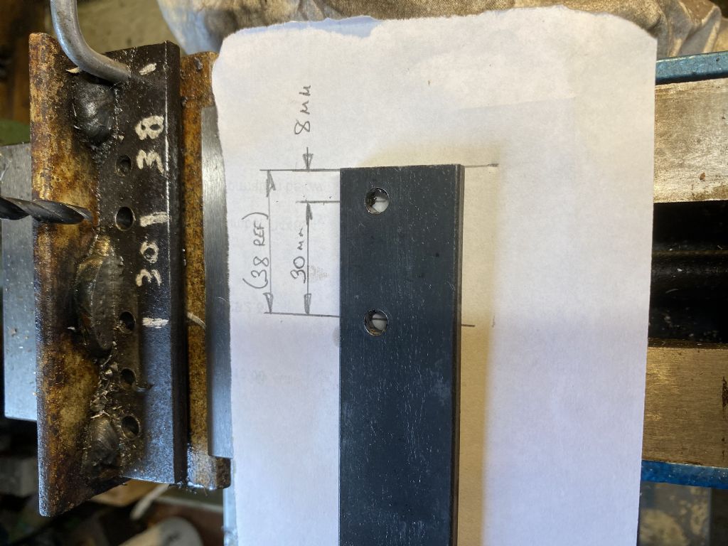

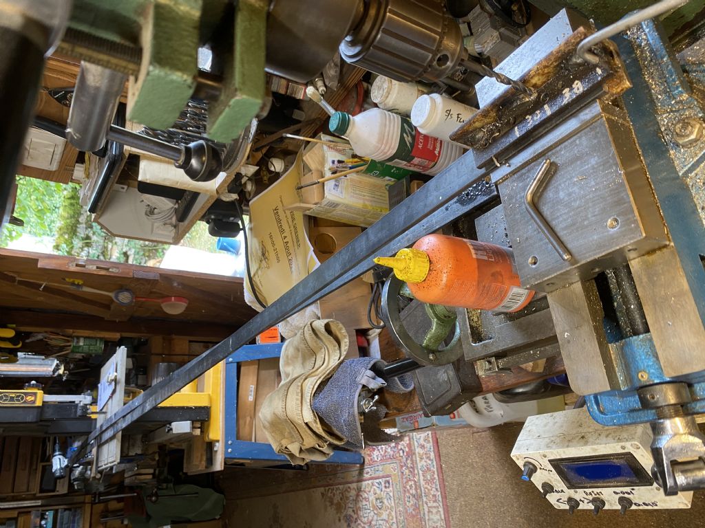

      Faced with drilling a few hundred 6 mm holes in some 30 x 6mm steel rail, I made a simple drilling jig. The object was to have a jig mounted on the Mill/Drill and not move the jig, just the rail section. Each end of the rail needed two 6mm holes so that sections could be "fish plated" together. In addition, the same jig would be used to make the fish plates and also used to put holes into the sleeper ends.
      Back to the rails.
      The first photo shows a rail section in the jig waiting to be drilled. It is pushed up against a removable dowel pin on the right.
      jig - drilling 3.jpeg The next shot shows the measurements of where the holes are required
      This one shows the first hole being drilled 38mm from the end of the rail. The rail is hard up against the dowel pin.
      The last shot shows the rail moved to the left and a second dowel pin located into the first drilled hole (38mm from the end of the rail) ready for the second hole to be drilled 30 mm from the first hole.
      All that is left is to turn the rail about (remembering that the holes are offset to the bottom edge of the rail !!).

              Sorry, me being a bit thick tonight.
              I presume that the distance marked as 38mm on the jig is not the distance between centres of the two holes (which it is for the 30mm dimension), but is actually 38mm plus half the diameter of the dowel pin between centres.
              If not then the first hole is going to be 38mm minus half the diameter of the pin and that would not correspond to the drawing?
              Or am I missing something!
