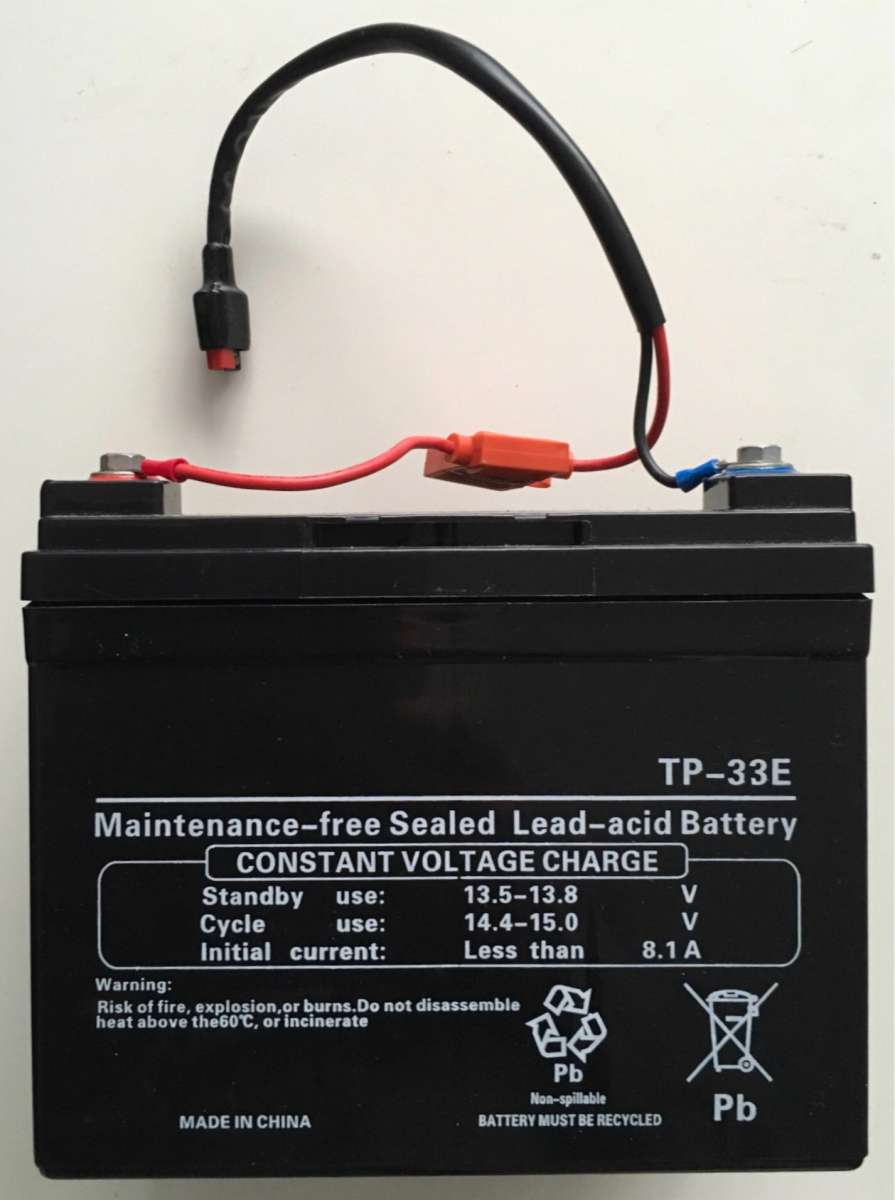

                                      @ Robert & John [and anyone else who might be interested]
                                      It looks like I am well on the way to having a decent standby system:
                                      This battery, which I bought [with its charger] cheaply a while back, is holding charge nicely … and the 33Ah capacity is perfect for use with the Victron 12|250 pure-sinewave Inverter

                                      #769733
                                      John Haine
                                        @johnhaine32865
                                        Looks good Michael.
