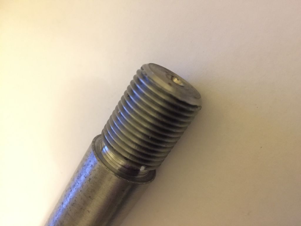

      Thanks for clearing up my measurement confusion Jason – all is now clear.
      I tried using the Kkmoon (cheapo) inserts with the angled topside feed method – marginal, if any, improvement. I then had a rummage and found a Glanze tool which I thought I'd lost. This has a smaller insert which probably wouldn't cut deep enough for a 2mm thread, so I did a direct comparison between the Glanze and the Kkmoon at 1.5mm pitch. The Kkmoon thread looked much as in my original pic but this is what the Glanze produced:
      This was at 65rpm. Not perfect perhaps, but acceptable for my purpose. So there is certainly a problem with the cheap insert, at least in the way I'm using it. I'll buy a better 16mm insert and see how it goes.

      #382135
      Pete Rimmer
        @peterimmer30576
        I can't see any reason why you would be unhappy with that Robin. Looks perfectly good to me.

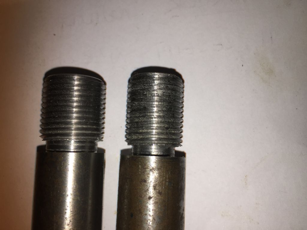

                Will, having never never used a thread chaser I can't comment on that, but…..
                I ordered a 16ERAG60 insert from JB tools, as suggested by JasonB. It arrived today:
                On the left is a 1.5mm thread cut with the JB, on the right with the Kkmoon. Same stock, speed (180rpm) &c. The JB thread isn't perfect by any means, but it's OK for my purpose. As someone said earlier on I can always finish with a die. I just got curious as to what was going on with my first attempts on the lathe – I've learned some stuff by making these experiments.
                It took almost a week for the insert to arrive from JB – an enquiry as to when I might expect it elicited no response, but when it came there was a note from Jenny saying she'd put an internal insert in the bag as well. I thought that was pretty dashed sporting of her so a yes from me. I don't think I've bought from the firm before and I was beginning to get disgruntled by the delay, but now I am – well, regruntled I suppose.
                Anyhow, I think I'm sorted now, thanks for all the advice/comments.

                  Using carbide then you must use the right speed 600 rev at least ,preferably 1000+ then you will have a nice shiny finish. look up the recomended speeds and be shocked at work we would cut that size at 2000RPM no problem.

                      Posted by Alan Wilkinson 1 on 10/12/2018 15:11:47:
                      Thanks Alan, just for the hell of it I'll give it a go at 1000rpm – with a suitably generous relief of course! For the actual application I had a 4mm relief, so for 2mm pitch that's two turns of the work, which at 1000rpm gives me 120ms to snap the half nuts open. Hmm. Maybe a good glute workout technique though. Presumably the 2000rpm you'd use at work is with CNC machinery?
