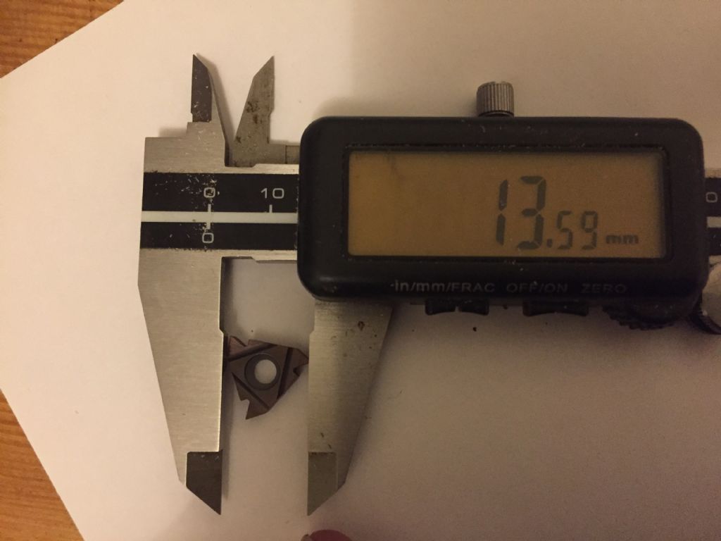

                                Well, to report back on suggestions, I've now tried upping the speed (250 rpm instead of 65), using EN1A instead of EN3B and taking spring cuts. Still in badger's ar*e territory. I'm reluctantly forced to think that it must be the 'poundland' inserts – **LINK**
                                I don't understand the codes for inserts – can anyone point me to a source of decent inserts which would fit this holder?
                                Robin

                                  Robin, measure the side of the insert, it will be 16, 11 or 8mm, the tip code will have that dimension included in the code number along with an E for external, an I for internal and R or L for right hand or left hand threads.

                                      From the Bangood link you need a 16mm, External Righthand, 60 Degree , Partial form insert = 16 ER AG60 for a mid range try JBcuttingtools which is likely to be Kennametal.
                                                Thanks Jason. Your link is actually to the NR (N=iNternal?) insert, but  obviously they do ER (presumably External Right) as well. However, following Emgee's advice to measure the edge of the insert I'm still confused – which edge? This is one on the Kkmoon inserts:
                                                I can't find any dimension close to 16mm. Maybe I should just buy the JB tool and inserts and write this off to experience?

                                                  I understood the size dimension was the diameter of the inscribed circle the insert would fit into. Without doing the math i'd guess the example above is 16mm.
                                                  (edit.. looking at that again I probably mean 12mm???)

                                                    Its the length you would get if you carried the edges on until they meet at a point. not the inscribed circle." L" on this drawing.
                                                    Link should have been to ER  which I thought I had done.
