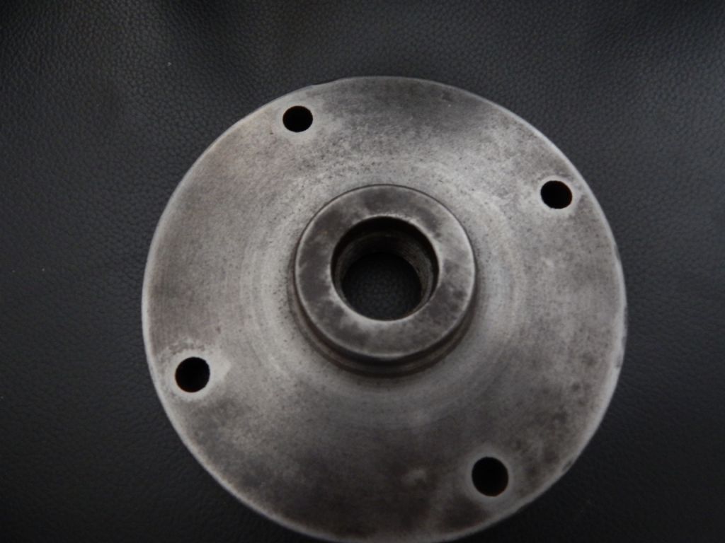

          Hi everyone . Thank you for the comments
          I think the ML7 must be 1" x10tpi . Am pretty sure that mine must be 1" x 8TPI. I might buy a RDB one to see if it fits better which is 1 " x 8TPI. I am hoping they are all not rubbish cast iron I have to confess the one i bought it didn't screw right on as far as my original chuck I am guessing the thread differences was the problem Live and learn ML7 is not Drummond
          Am sure this might sort it out. Have been busy with other bits with my chinese pump and cutting liquid conversion so haven't had time to get one yet have been in correspondence on eBay RDG to check the cast iron is not cheap rustable version with steel in it. but will wait till i find out.

            That's an odd one. I thought Drummond M Type was 1" x 8tpi, not 12tpi as the ad in the link says. Either way, lot of extra overhang there. I think a proper Drummond backplate from lathes.co.uk would work better.
            OMG dont but one I bought one from Myford it was dreadful didnt fit properly at all was as bad as the ML7 backplate fitting it could be it was wrong TPI . Myford said they had lots of probs its possible its not as listed but clue less here and refunded great company.

              You need to be aware that the ML7 chuck thread is 1 1/8" and 12 threads to the inch. This is not something I think is correct, I know it and I have checked it by measurement. It is not difficult to check the diameter and the pitch, and anyone who tries to fit a chuck by guesswork rather than measurement is likely to have problems. If you do not have a thread gauge, get one.
              And do us all a favour, please. Next time you have a problem, TELL US what the problem is about. Your message implied that it 'just broke' when you now say that your chuck never fitted properly in the first place. So, we suggested all sorts of likely causes, and some unlikely ones, when you knew what the problem was likely to be, and it was not a problem with the chuck itself, most likely, but the fact that it did not match the lathe it was fitted to.
              I'm sorry I wasted my time. I'm sorry you wasted my time. Don't do it again. Most of us have little enough of it left.

                  I think your right . I bought the back plate not with the chuck am still learning about this threads as they are very hard to know the difference by eye and all look similar.
                  I found a tale piece for drummond b and its listed as 1" x 8tpi.

                    Hi everyone By the way i do have another 80mm back plate marked up v1012 but cant find out who made this or what threads are in it i measured the thread part which is 1/2" and 5 threads there in with the blank unthreaded section 1" dia  would this infer it is 1" x TPI 10?
                    M

                      Can I suggest you take a few measurements of the spindle nose before investing more money?
                      It isn't hard to measure how many full threads are in an inch, if 8tpi they will be exactly 1/8 of an inch apart.
                      #352732
                        Martin what is that 10tpi thread gauge photo in your album measuring, looks like your spindle nose to me so why try an 8tpi backplate?
                        Anyone else think this thread looks a bit long?

                          Yes, threads are not always easy to check by eye. You need to get to grips with this, though, as you will come across threads which all look like 8mm or 5/16" diameter, and might have 40, 36, 25.4, 24, 22, 20.32, or 18 tpi, and that is just the common ones.

                            Well i just tried measuring my other plate and it would concur that its 1" x 10TPI

                              If the gauge is correct Jason then It cannot be a Drummond B, lol. It was much modified before i got it . If ML7 is 8TPI it would explain a lot why this failed.

                                Well the gauge looks like it fits correctly so you have a 10tpi spindle nose.

                                  If you have an 80mm backplate with a 1" x 10TPI internal thread it should be a perfect fit on the spindle nose in the photo, which appears to be 1" BSF. However, if the thread in the backplate is only 1/2" deep it will not screw fully on to the spindle frown
                                  If the damaged backplate was either 8 or 12 TPI that would explain the stripped threads . . . I would just be grateful that the spindle thread seems to be still intact!

                                      Not only that, but the ML7 spindle thread is 1-1/8" major diameter and yours apparently is 1". How it even held together for as long as it did is a minor miracle.

                                        The possible consequences of such a mismatch of threads rotating at a high speed don’t bear thinking about, I think you were extremely lucky to avoid serious injury.

                                            I was lucky enough to buy a 1" 10tpi 5" backplate and its a sweet fit like my other badly interfaced chuck which is 4.5" So am now looking for a sweet 5" bernard or pratt chuck that bolts right through. I did buy one but hermes messed up delivery and never got it as the seller got cross as hermes made no attempt to deliver at all . I must add of late Hermes have gotten better..
