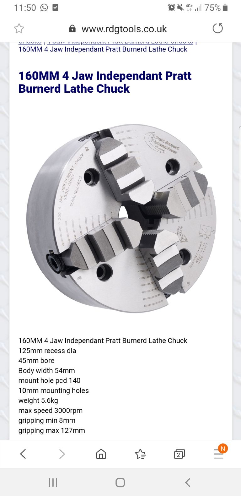

                      Not sure if its classed as one of the slim type, it's exact the same chuck as this.

                        I think I'll keep hold of it, I use the collet chuck for smaller items but for larger stuff I'll use this. It wont be on the lathe permanently and looking at the Warco website their 125mm chucks aren't a lot lighter anyway. My WM250 lathe is the type with the inverter and didn't sound or appear to struggle spinning the chuck up. Thanks for the advice and opinions.

                            Nice looking chuck but jaws look on the chunky side for a slim body / light duty type. For ME work the true light duty type with slimmer, more pointed jaws are generally much better. What you loose on ultimate holding power you gain in the ability to hold smaller, trickier parts.
                            Given our, generally, lighter machines we probably can't take the sort of cuts, especially the clunk-clunk-clunk interrupted ones, that need the grip of a normal duty or even heavy duty 4 jaw. But we can get seriously frustrated when the part is too small or oddly shaped to get all four heftier jaws gripping.
                            My light duty 8" PB is very good and looks to have slimmer jaws than that one but, even so, one day I shall get round to mounting up a slim body 4" on a 5C arbor for the teensy stuff.
                            It would be a great help if chuck suppliers give jaw dimensions. Regrettably now the numbers of professional buyers of manual lathe chucks in our size range have dropped so much there is no pressure for the more niche types and everyone goes for the middle market.

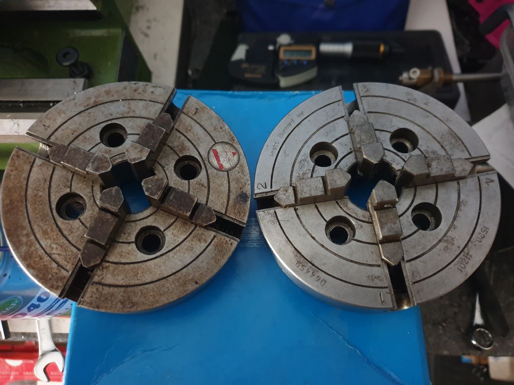

                                    I've a couple of PB 110mm independent 4-jaws that are tiny by comparison. The one on the left is really nice, the one on the right has a couple of tight spots. Not sure if I'll ever use them but they were cheap enough and perhaps they'll come in handy one day.

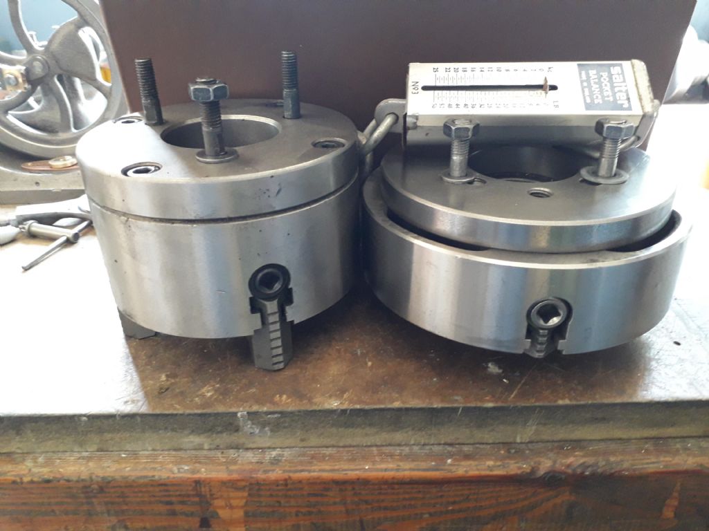

                                      I have a choice of two 4 jaw independent chucks on the S&B model A. A 160mm Chinese and a 6" Toolmex lightweight originally intended to screw directly onto a Myford. The Toolmex weighs half the weight of the Chinese one, and the jaws are half the size, so the size the workpiece dictates which chuck is used.
                                      I bought a serrated jaw Burnerd of 6 3/4" which is as heavy as both the four jaws put together. It only gets used occasionally, no worries about speed as it is Ductile iron and the lathe max speed is only 1400 rpm and the plain bearings are easily able to cope with the load. I always check clearances and set stops if necessary whether or not the chuck is in danger of fouling parts of the lathe.
                                       One slight drawback of larger chucks is that you loose length which can be a problem with shorter machines, the model A is only about 21" between centres.

                                                Thats a lovely picture of the two lightweight PB chucks. The jaw proportions are very much the same as my 8" lightweight.
                                                Comparing them with the brochure picture of the new 160 mm four jaw in your earlier post shows the jaws to be seriously smaller on the older chucks which, as Jason says, makes a huge difference on tricky jobs. The older style chucks are vastly more suitable for folk like us. It might be expected that the smaller jaws and screws would have less gripping power but I've never found it a problem despite my S&B 1024 being a considerably heftier machine than most folk have. The heftiness has, on occasions, been exploited with serious cuts on moderately optimistic work. Which didn't come loose.
                                                I'm not sure that I ever want to tackle a job that needs the extra holding power of my heavy duty one!
