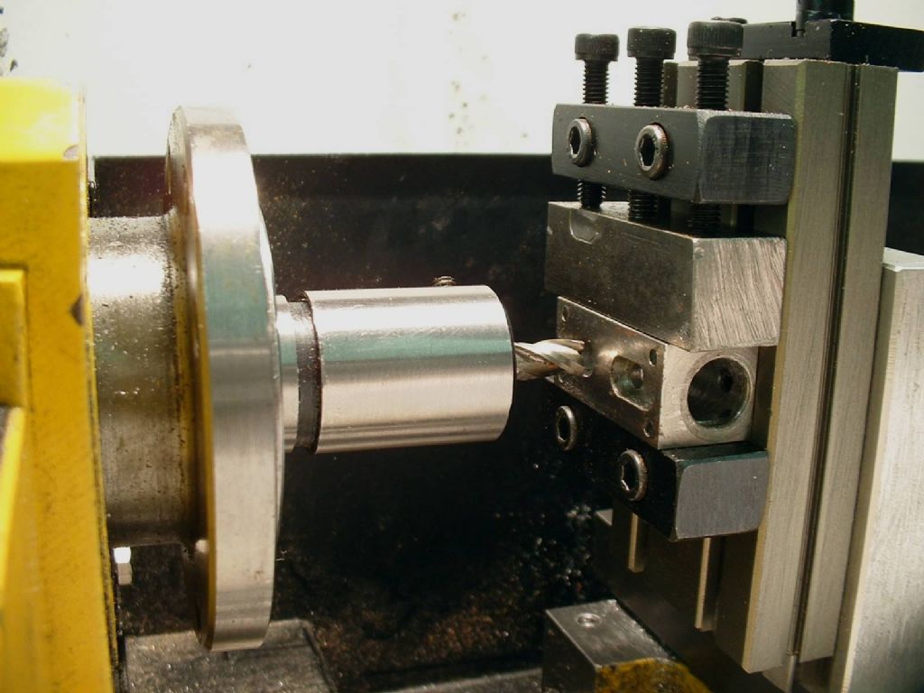

                                        #247770
                                          Mine was originally a Clarke CL300M. I got it cheap as a return and a few bits were missing (but rapidly supplied).
                                          Over the years that model has changed relatively little compared to some other mini-lathe designs. If I was buying one again I would try and save up for a brushless motor version with a 16" bed.
                                          If/when I get a new lathe it will be 4" centre height, I have a few in mind, either a Boxford or an import, but that's way off as the only thing I would want to turn I can't is an 8" flywheel -for which I would blag a borrow of a bigger machine.
                                          I have a Taig/Peatol vertical slide, it needs a raiding block fixed onto the topslide fitting for maximum benefit on a mini-lathe. I made a 'machine vice' using a moving jaw from a loose block with two t-bolts on it rather than use the screws direct on the work.
                                          Best improvements were the roller bearings (addedconfidence!_) and QCTP.

                                            Ajohnw
                                              @ajohnw51620
                                              You should post that in the vertical slide thread Neil – but how did you set a cut depth? That seems to be the sticking point on chinese lathes. The Peatol slide will position the bottom of the milling table past the bottom of the block it runs on so there may be some scope for mounting it on the compound side.
                                              I often used the screws to hold odd bits also machined a step directly into the jaws so when plate like work was mounted it had to be axially square to the lathe splinde.
                                              #247775
                                                Easdy enough to leave the half nuts closed and rotate a gear on the leadscrew, 127T on a 8tpi thread is close to 0.001" per tooth. Or just make a simple "dial" to go on the right hand end of teh leadscrew and turn it manually
