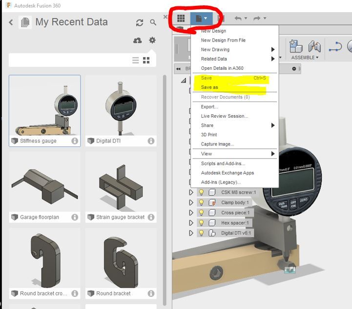

                        Posted by Dave Smith the 16th on 04/05/2016 02:14:32:
                        Had a play with Fusion 360 and it appears to be easier than 123D Design, although quite similar.
                        I managed to created a block with a dovetail groove and threaded holes. It wouldn't let me save it though?
                        Only option was to 3D print it where it sent it to Print Studio whjich just had a blank page and no item. Or to Meshmixer or Makerbot. Sent to Makerbot and the threaded holes were just plain holes.
                        Threads not transferred.
                        Weird – no idea what the problem could be. Was the "save" option greyed out? Never had that problem. It's only greyed out in the example below because I haven't changed anything since the last save I did. Usually it will autosave periodically anyway and save at exit unless you tell it not to. You sure it hasn't kept your work?
                        STL is under "export" rather than save – how did you get to that?
                        The save option is in the pull down under the folder icon shown (or press Control S) and the recent data (projects) panel is displayed by clicking the 9 black squares. Here's an example:
                        Hope that helps!

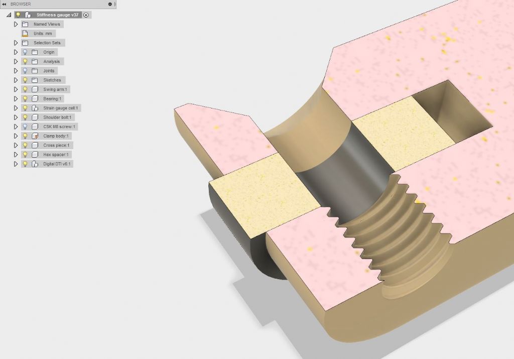

                          Not so with Fusion 360. When defining or editing a thread feature, you can tick the "model feature" box and the thread will be created as a true helical path (see below). This is useful if you want to export to STL etc. Of course, if you want to use Fusion's rigid tapping or thread milling operations you can pick up the thread in CAM without modelling it.
                          For normal drawing purposes, the default is a cosmetic but non-modelled thread.
                          That's one area where Onshape is weak – last time I looked, they still wanted you to cut your own threads by doing a helical path and cut extruding a cutter along it. Ending the thread cleanly was a pain too. In comparison, Fusion is a dream – and you get the CAM stuff as well….
