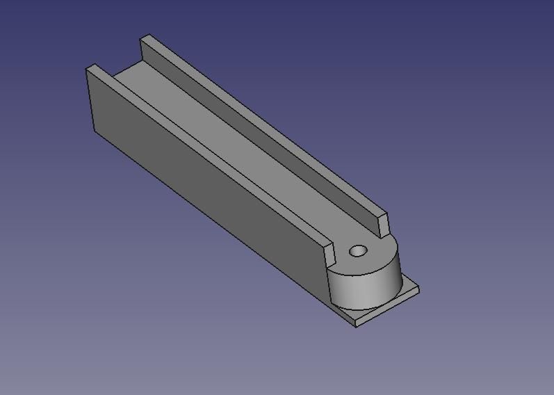

  • #268835
      Another bad day in my workshop!
      I'm trying to make this item (part of a jig) out of 18x18mm mild-steel bar:
      I attempted to make the item by offering the end of the bar up to a 20mm 4 flute cutter. Once aligned with the cutter, I pivoted the bar on a 4mm bolt through the hole. The bolt went through a similar bar clamped in a mill vice with a nut underneath.
      I did half the radius with no problem but doing the other side required climb milling. Almost immediately I had a violent dig-in that damaged the work, bent the pivot, and moved the vice.
      What's the best way of making a part like this? My method was too exciting!

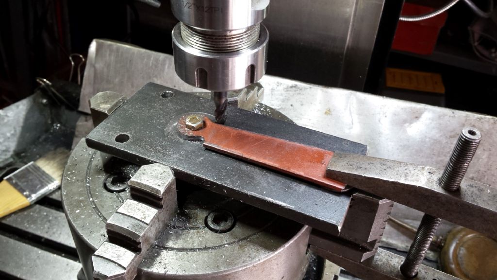

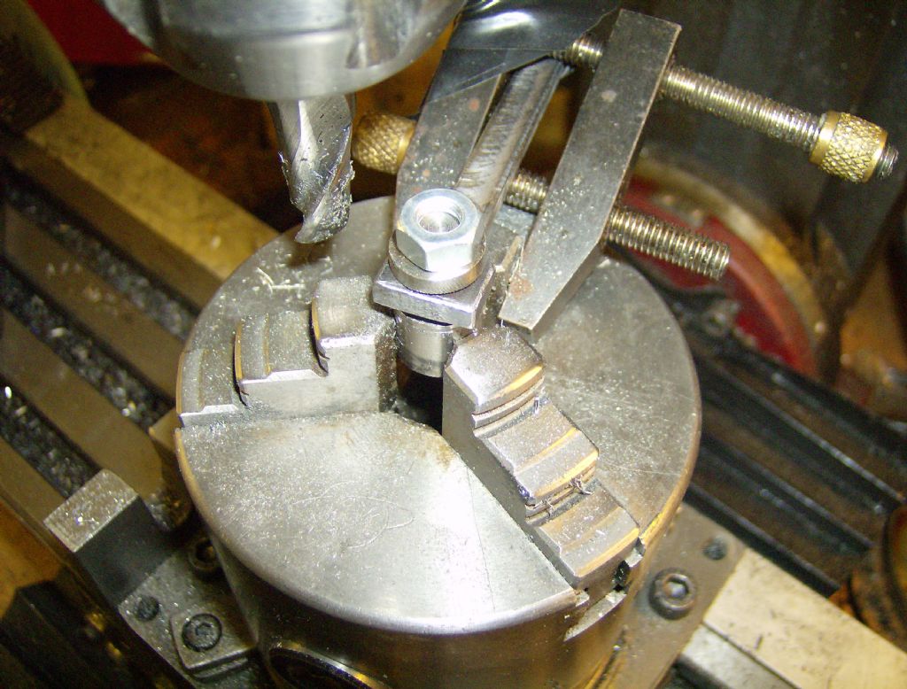

                #268846
                  +1 for John's suggestion.
                  This is how I rounded the end of connecting rods. The rod is nutted up to a threaded mandrel held in the chuck – the round bit you can see is a sacrificial washer:

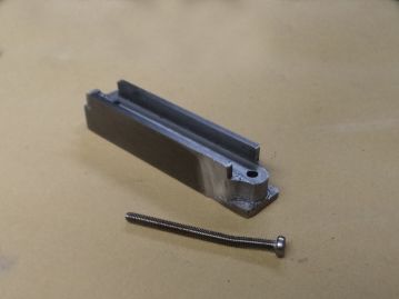

                              #268882
                              Paul Lousick
                                @paullousick59116
                                Scrap plate mounted in chuck on a rotary table (or directly to the RT). Job held with bolt and clamp.
