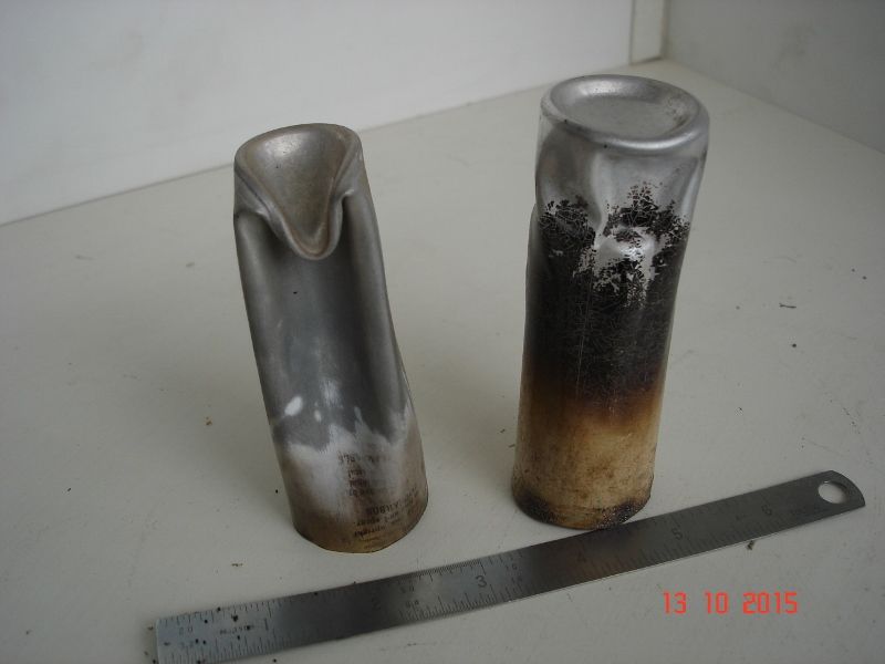

                    Arm your self with a 6" / 150 mm rule and head to the super market, tinned food / pet food areas. Keep clear of aluminium. In one of his articls in ME on building a hot air motor James G. Rizzo told of buying a type of soft drink in UK that was in a stainless steel can, and how he always tried to take a number of them back to Malta each time he went home..

                        The Robinson motor has a very shot displacer, length and diametre are about the same, and the hollow displace is packed in this case with steel wool. In the long type displacer the ratio of length to diametre is about 3 : 1 and the displacer (in smaller motors) the sides of the cylinder acts as a regenerator.
                        On the Robinson the displacer has holes in each end, so there is no pressure build up caused by heating so the metal can be even lighter than a sealed displacer, food cans are ideal, just no aluminium.

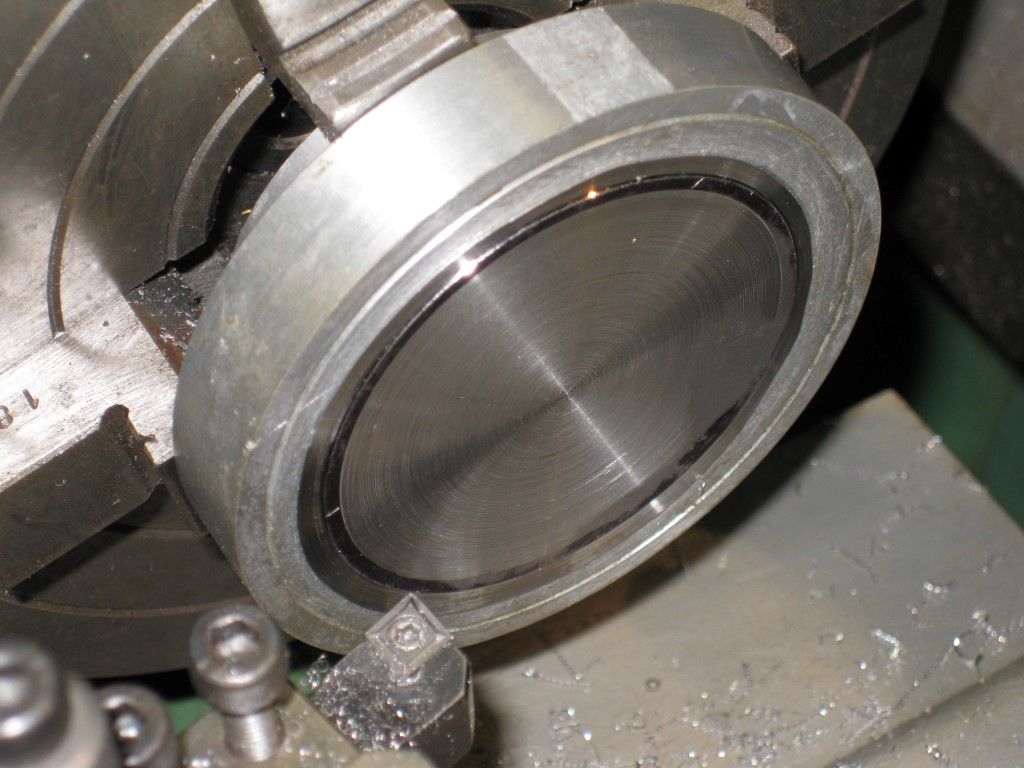

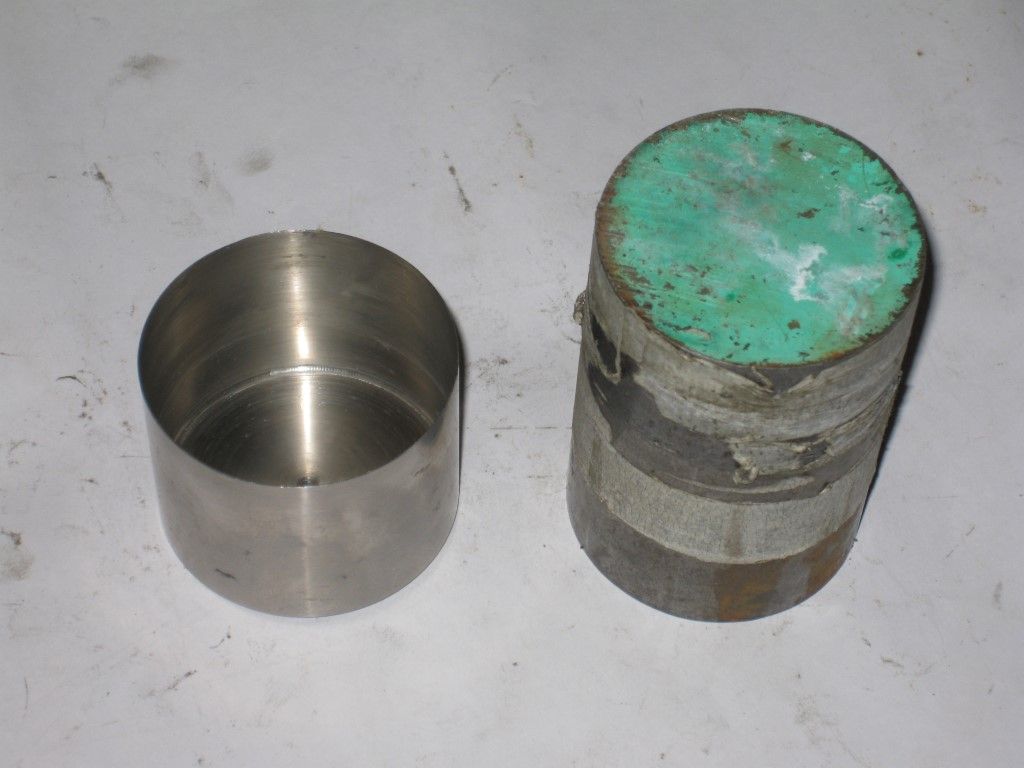

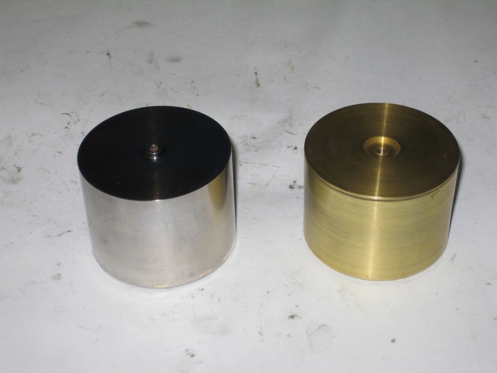

                          Following on from JB's suggestion, I turned up a new displacer piston from 316 stainless steel. I was aiming for 10 thou wall thickness, but it turned out to be more like 8 thou when finished and the top even less.
                          The original displacer weighed 93 gms and the new one was down to 34 gms – quite a saving, and hopefully the heat transfer will be a lot slower, enabling the Robinson to run for a while without external cooling.
                          In the end, I decided against a regenerative displacer, as this one seems to be a great improvement on the original brass one.

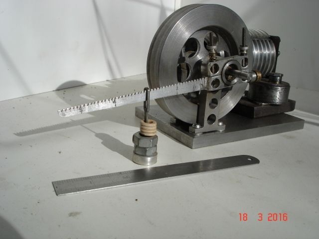

                              If you are interested in finding out the value of regeneration, you could make two displacers, one with and one without built in regenerator, could be quite interesting. That's the sort of thing that happens with my hot air engines.
                              Here is one of my flame lickers rigged with a Prony Brake to test the torque(had that motor out today, it refused to go!). There is 1 oz on the beam at 3".
                              Ian S C
