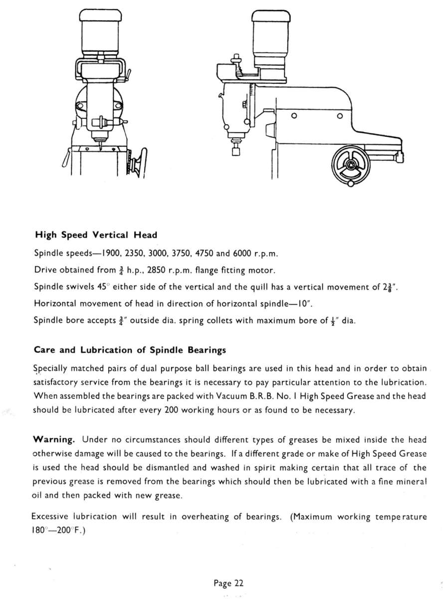

      Hoping for a bit of advice. I’m tooling up for a new-to-me Alexander Master Toolmaker (= Deckel FP1). I will have the luxury of the high speed vertical head, but won’t have the regular vertical head. In a vertical setup then, my slowest rpm is 1900.
      Where does this leave me in terms of viable/reasonable facemills and flycutters for surfacing parts? All the feeds/speeds calculators seem to indicate that, for example, a 100mm diameter indexable facemill with 45° lead angle needs to go much slower than this head can manage. Am I really limited to approx 50mm inserted cutters with 1mm DoC?
      I completely understand I could use the horizontal spindle to access the slower speeds, but I’d like to try to understand where the theoretical limits of this vertical setup lie.

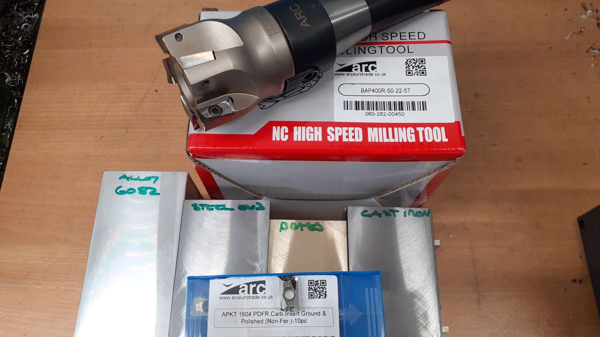

            No need to experiment I have done it for you ramp it up rather than dial it back.
            63mm insert face mill with inserts intended for non-Ferroius will spin happily at 2000rpm on all the common model engineering metals. So if you come down to a 50mm head then you could run at 2500rpm for iron and steel and if you have more available then use it on non ferrious. Go for a 5 insert rather than a 4 insert then you can feed a bit faster for the same given chip load.
            See the copies of my MEW articles here and here.
            You can also wind it up with solid cutters too.
            An insert lathe tool in a flycutter will also run at similar speeds but you need to have it well blanced, downside is your feed rates will be slow a sit only cuts once per revolution
            I’ve run the 80mm at 5000rpm on the CNC so not sure where Dave gets his idea high speeds are only for small solid cutters, I’d be running them at a lot more if I did not max out at 5000rpm.
            All at 2000rpm with a 50mm dia head, feeds upto 400mm/min

              Is the high speed head capable of handling  large diameter cutters,  i assume it probably is ok with a 63 mm facemill but not sure. Unfortunately my Alexander didnt come with the high speed head . Heres the manual page for it.Page 022
              #769924
                If you are going to be limited to a 12mm straight shank arbor in a collet as the above suggests then 50mm would be about as big as I would want to go on steel and iron and shallow cuts too.
                Speed is not going to be the issue, it’s that small diameter mounting so VFD to drop the speed may not help as you will still have a less than rigid setup.

                      Once again Dave I assume you have not even  looked at my articles or the videos as your comment “though what machine and alloys were tried we haven’t been told” is a figment of your imagination as what I put clearly gives the alloys “From Left to right the samples are 6082-T6 aluminium. 070M20 (EN3) steel. CZ121 Brass and GR17 cast iron.” and numerous times it is mentioned that the Sieg SX2.7 is being used.
                      There are no gears in that head so again how you can say “Asking a geared up head to drive a big face cutter though is questionable” make what you say more questionable.
                      My suggested use of inserts meant for non ferrous significantly reduces the amount of torque needed as these inserts are far sharper so don’t need to be pushed through the metal. Most will say the imported machines lack torque but my suggested methods are a way to use these tools without the need for much in the way of low speed torque.

                      Often it is said that carbide can be run at 3 times the cutting speed of steel. So now that High speed head has a max of 6000rpm which in my book is about 3 time sfaster than the usual top speed of around 2000rpm found on many an industrial or hobby machine. I’d like a 20K rpm head for using small carbide cutters when doing things like engraving and fine 3D finishing paths, so 6K is not really that fast these days.
                      So that 1/4″ HSS screwed shank cutter that was being run at 2000rpm back in the day can now be replace with a reasonably priced plain shank carbide one and run at 5-6000rpm on steel or more on non ferrious.

                          At work we use 63mm face mills with aluminium specific tips, and usually run between 4000 and 6000 rpm, depending on whether the machine has enough torque. Then we got a bigger 5-axis machine with a 20,000 rpm spindle, so thought we would go a bit faster. 15,000 rpm on the face mill worked well, until a tip/screw broke and shattered the door glass. At over £700 to replace it we gave up on that experiment!

                                  How would I establish whether the head is “capable of handling  large diameter cutters”? Other than trying, and destroying the bearings to establish that it’s not capable…

                                      Just to check – Al tips but cutting steel? Rpm range appeals, will have to look at the torque topic

                                            Yes the non ferrous inserts cut steel and Cast Iron and put less load on the machine.
