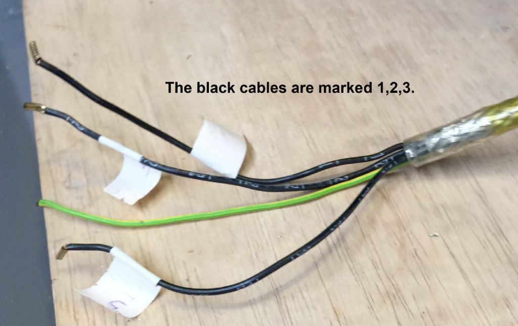

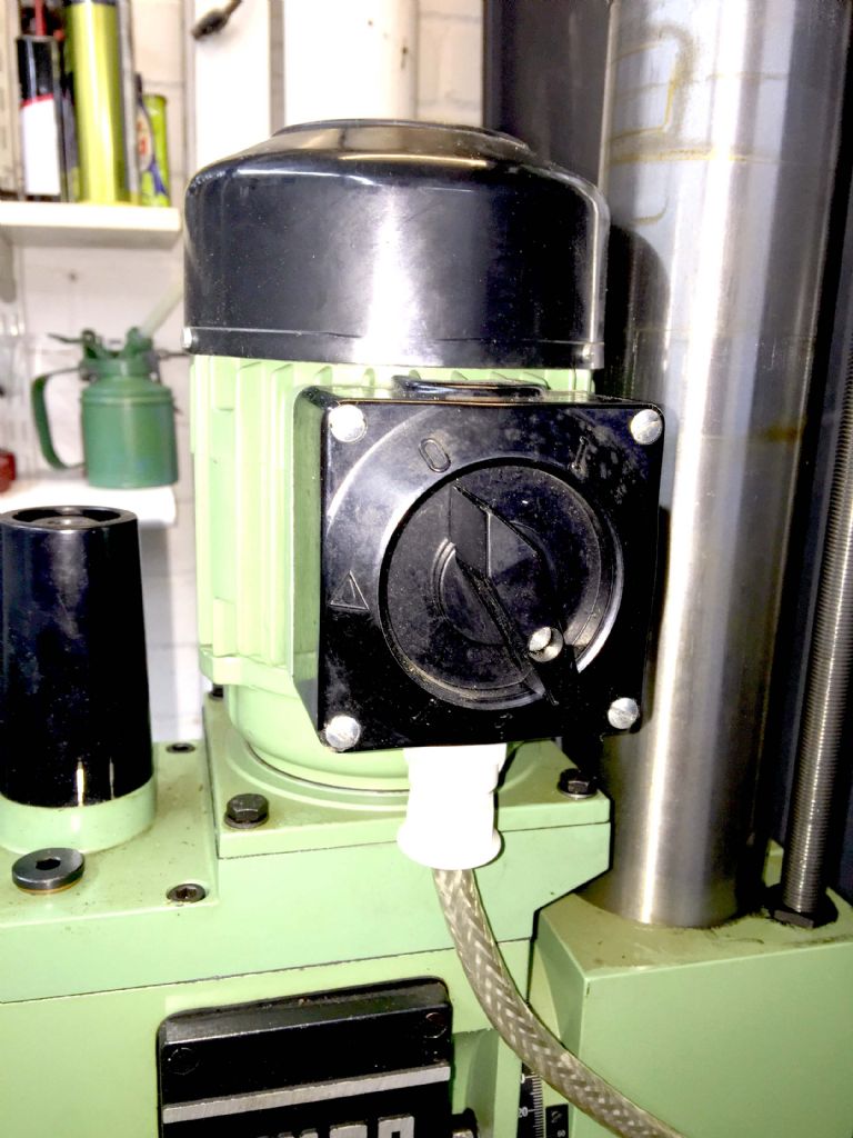

      motor plate.jpgemco fb-2 mill.jpgcapacitor.jpgblack cables.jpgHello, I am hoping that I can get some help with an electrical problem.

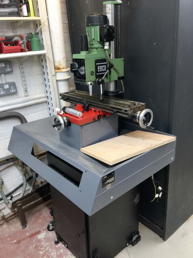

      I have an Emco Maximat Super 11 which had the FB-2 milling head attached to the back of the lathe bed 220/240v.
      I have been able to buy an FB-2 type stand with table and have fitted the head to the Milling table.
      Unfortunately, all the manuals refer to electrical insulation as a mill head attached to the lathe bed, the capacitor being installed within the lathe electrics, the on/off switch being integral on the side of the motor. head
      The cable that comes out of the Motor/Switch housing has three wires which are marked 1,2,3 what I would like to know if anyone can help as to how I can wire the capacitor in and then a live and nutural feed into the circuit?
      If anyone has experience with this I would appreciate your help.

          Richard, do you have the lathe manual, and does it have a wiring diagram in it? If so then that should be enough to trace the connections. If you don't have a schematic then it's a matter of tracing the wiring out to work out how it was connected and therefore how it should be. Maybe if you can take the cover off that switch and posted a photo of how the wires were connected inside it would help?

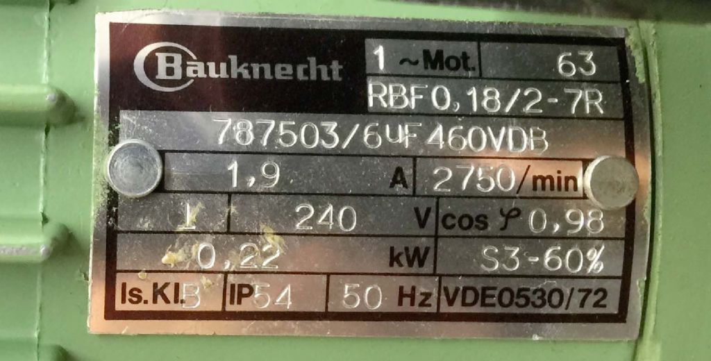

              I just looked at the rating plate in you pictures and see that yours is a single phase motor so ignore my VFD ramblings.

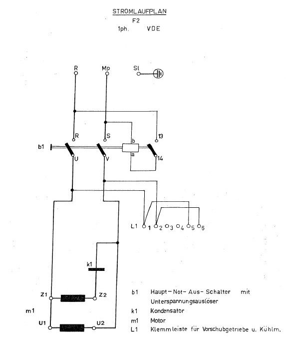

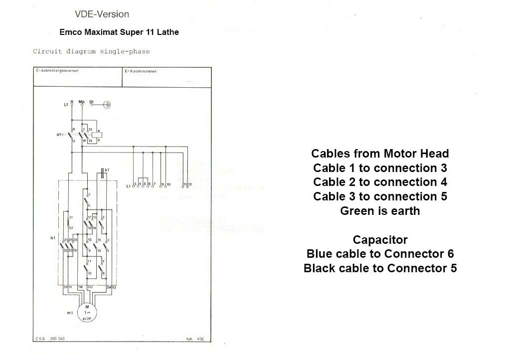

                  Wiring Diagram 1ph Vde Maximat Super 11Hello thank you all for your replies, I have uploaded the Maximat Super 11 Lathe Wiring diagram.
                  The wires that come from the motor head and the capacitor where they were connected are shown on the right-hand side.
                  I will also upload a few of the photos that I took when I disconnected the milling head from the lathe.
                  Any help is appreciated.
                  thanks, Richard

                    Emco motors are a bit peculiar and their schematics leave much to be desired. I've had two of the 4 speed milling heads, one 3 phase and one single phase. The single phase motor was actually a 3 phase delta connected motor with the line and neutral connected to (any) two of the wires and the capacitor connected between line or neutral (depending on which direction you want the motor to run) and the other wire. To confirm, use a multimeter to check the resistance between the 3 black wires, 1-2, 2-3, 1-3, they should all be the same. Daveb

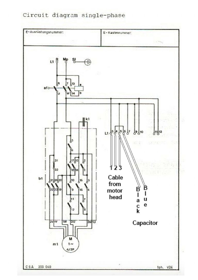

                      I believe this is it…

                          wiring dig.jpgHi Joe, I am no Electrial Engineer, so no I am still looking at the emco wiring diagram that is above, and I may have worked it out, as I have shown the lead that comes from the milling head has 4 cables three are marked 1.2.3 which connect to 3.4.5 on the Capacitor Black to 5, and Blue to 6.
                          Please tell me what you think?
                          Thanks Richard

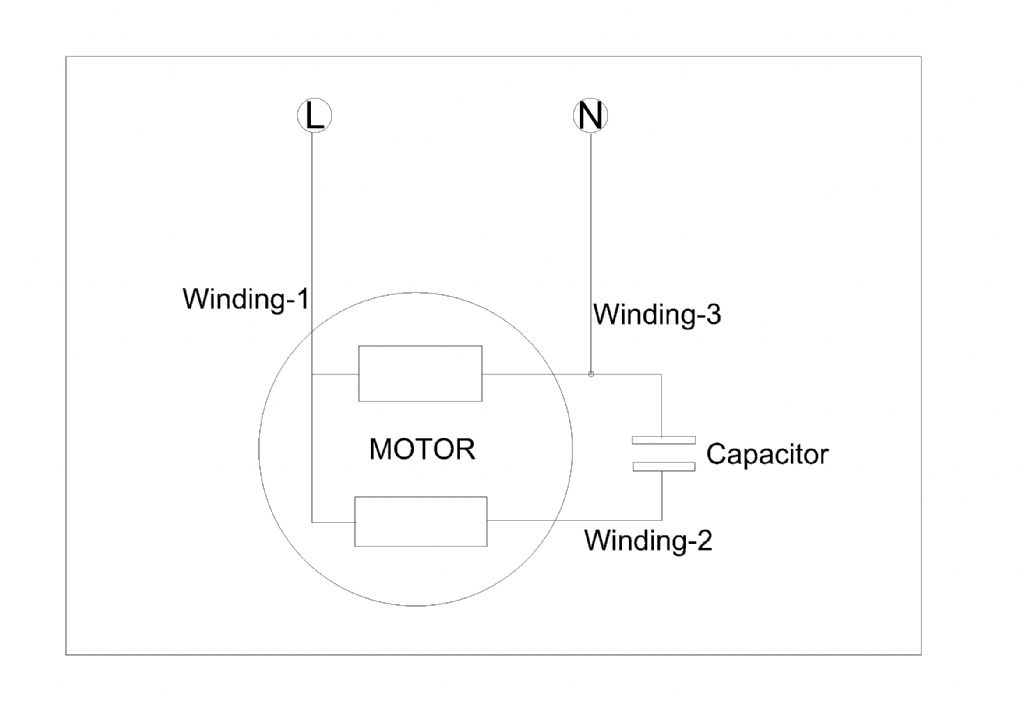

                            Hi Richard.
                            I am not sure what the issue is now…
                            You already gave that diagram ( 3 diagrams up) with the text that indicated which wire number went to which connection number. In the drawing you have now provided, you have shown exactly the same, only diagrammatically this time. Both are valid/correct. From that diagram, all I did was extract a simple connection diagram.
                            connect MAINS LIVE  to motor winding labelled 1
                            connect MAINS NEUTRAL to motor winding labelled 3
                            The capacitor -( wire colours are not important) simply connect one wire to motor winding 2 and and the other to motor wire 3.
                            And connect the earth wire to ground, of course..
                            I have not included the control switch in my diagram – I see in your photos the (rotary) switch is on the motor side. I assume the 3 wires labelled 1,2 and 3 from the motor already have the switch in line, so just connect the wires as I have described and all should work.
                            Joe

                                Hi Joe, I have been looking at the wiring diagram and notice that Emco mark incoming lines as R and Mp do you know why they don't use L Live and N Neutral?
                                The Emco FB-2 manual that I have says
                                Mounting the plug for Electric Connection Single Phase Version
                                The yellow-green wire is connected to the grounding contact,
                                The Blue and Brown wires (Mp,R) are connected to the other contacts.
                                So is it that Mp = Neutral (blue) and R = Live (brown).
                                Thanks, Richard
                                #386111
                                Joseph Noci 1
                                  @josephnoci1
                                  Hi Richard,
                                  Yes, Blue is Neutral and Brown is live – so I think you have it correct there! The motor won't care if you swap them, but as normal, make sure the LIVE is the one that is switched – I think in any case the rotary switch on the mill motor switches both live and neutral, ie, it is a dual pole switch.
                                  Joe
