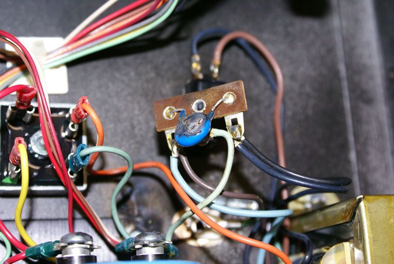

        I own a nice Colchester Master 2500 which has run very happily for the last 8 years or so. I had it wired through a plug and socket which allowed me to swap the power with my grinders. I acquired a changeover switch to make life a little easier and set about installing said switch. The cable from the lathe to the switch contains 4 black wires ie 3 phase and neutral (I'm sure you can all see where this is going) I had all the cable ends labeled but I must have got a phase and neutral crossed. Started the motor, it sounded like a bag of hammers, stopped it very quickly thinking, its running backwards, change two phases. Did that, still the same, then I made the mistake of switching the DRO on to see if that was working. Loud bang and everything in the workshop went off as the RCD tripped.
        Net result, blown transformer on the control side and blown fuse and I think it is a capacitor next to the fuse in the DRO box 9blue, about 12mmdia with two wires. The transformer is not a prob as I have located one and sent groats across the airwaves for a new one. My question is does anybody know a) is it a capacitor and b) what value. I have taken a pic but I'm not sure how to post it.

            That component looks more like a surge/spike arrestor. Depending on the working voltage they can be bought from the likes of CPC.

                  You appear to have stuffed 400 volts across the DRO. The blue thing is a Varistor or VDR by the looks of it, and won't prevent the DRO from firing up.
                  As Chris says, check all the fuses, and depending on how fast they ruptured you may have got away with a cheap repair, but I somehow doubt it!

                      I agree with Andrew that it looks like a varistor. If the fuse that blew was a small one just feeding this transformer I am surprised that it destroyed the transformer.

                            The picture is of the inside of the DRO console box showing the fried component. The transformer in question is in the main control box behind the lathe headstock. It is a 50va 415/110v unit that supplies the contactors for the motor, pump and electric brake. The 415v obviously comes from two phases (L1 and L2 I think) with the input disconnected and measuring across the input terminals on every resistance scale on my meter I get 0 ohms, no fractions, no small numbers just a plain 0. I have located a replacement which thanks to the wonders of the internet is on its way to me so I should be up and running again by Tuesday.
                            The DRO however is another (expensive) kettle of fish. I spoke to Darren at Goodwin Technology via the link kindly supplied by Nick. He reckons that the chances of of retrieval are slim but is willing to have a look. They work on a no fix no fee basis so I have nothing to lose by trying. If fixable they charge #110+vat if not then #245 for a replacement guaranteed for 6 months.

                              I can't see how your error could have damaged the 415 to 110 volt transformer. I found a circuit diagram of your lathe on the web and it does not use neutral. I suspect the neutral is only used to feed the DRO with 230 volts. (I expect the DRO is connected between one of the phases and neutral.) I am assuming the picture is the inside of the DRO. I assume that the mains live (One of the phases.) comes in via the fuse that blew (And possibly a switch.) to one side of the transformer primary and the neutral goes directly to the other end of the primary. I also assume that the varistor is directly across the primary. Are these assumptions correct ? I have tried to find a schematic of the DRO on the web but failed. If you gave some rough idea of your location to near some major town (Do not give your address.) then there may be someone who lives near to that could help you.

                                      DRO is fixed !!!laugh I got a call from Darren at Goodwin technology today. They managed to fix it and it is on its way back as I write. Cost a lot less than the replacement I was braced for. Super chap to deal with, thoroughly recommend the company.
