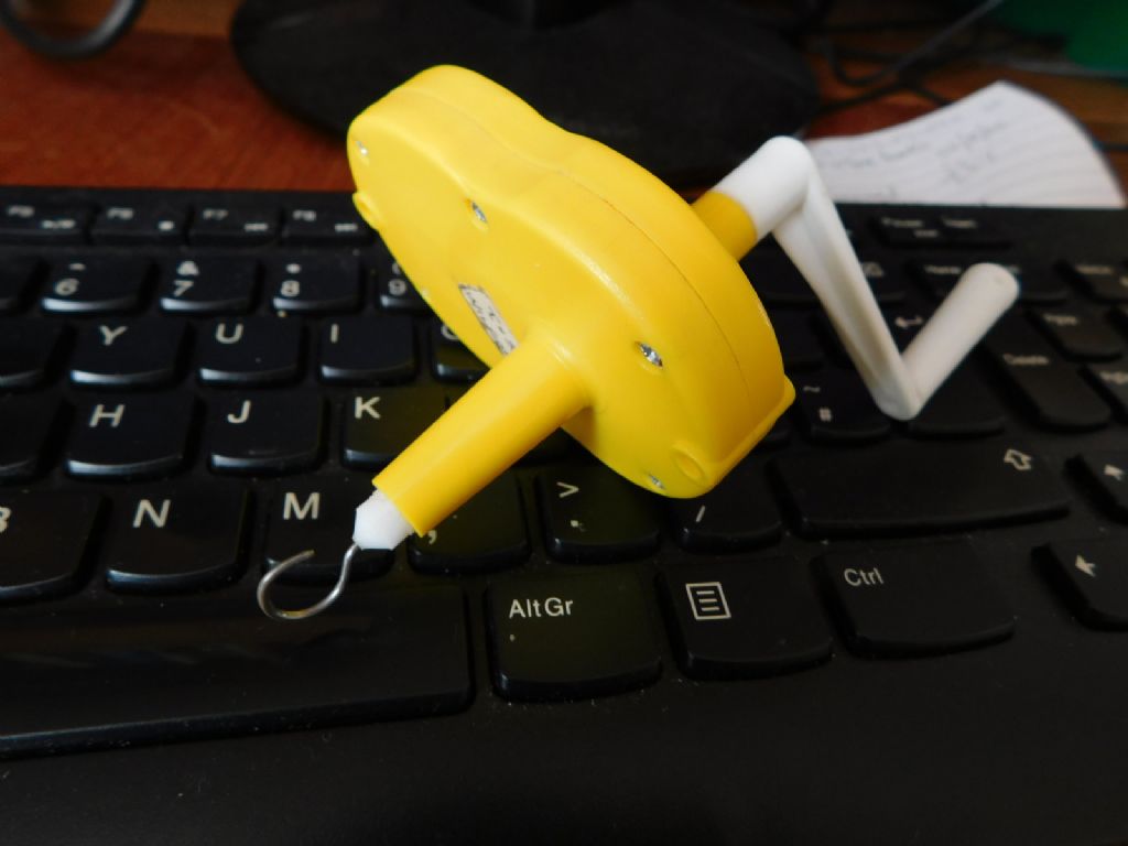

                    #613909
                    Ramon Wilson
                      @ramonwilson3
                      Well you are in luck Cap'n but only sort of as this is a much simpler version than you show but it will I assure you will work just as well at the kind of level you need for the rubber section involved if you make a simple torque meter to attach the rubber to when winding if measuring/gauging torque is required.
                      It's always best to wind off the model anyway as I'm sure you are aware.
                      Sue and I used this for years of indoor flying back as far as the early eighties. Unfortunately all of the indoor 'stuff' collected over that time was passed on to someone who was so-oo interested who then passed it on to someone else who was much the same – totally wasted I'm afraid.
                      I do have a fair amount of 36 x 2 1/32 balsa of varying grades that you are welcome too as well – not actual 'indoor' quality, never the less it was well chosen for the purpose.
                      If you are making your own kit for the hobby and you have not made a beam balance yet then theres one of them too sitting up the loft. I can't do it today now but I will take a pic for you next week.
                      There is little left of our involvement in indoor flying but what there is you are welcome too – it is extremely unlikely it will do anything but languish where it is for posterity so it would be good to see it go to someone who will get some use out of it
                      The Williams book was a game changer when it came out – I saw my copy quite by chance in a local book shop. I still have it but gave away the others I had – none were in the same league though.
                      We flew locally and occasionally at Cardington which was an awesome experience.
                      Best – Tug
