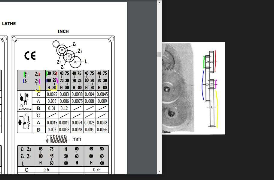

      Has any body here have a Warco290V lathe?If so is it possible to advise on the changing of gears for screw cutting.

          Youve got it.I,m finding it difficult to understand completely the drawing in the manual.
          i have gone through the process of changing gears etc so i,m ok with the assembly etc but what goes where to achieve the specific thread is baffling me.

              Rather than look at the side view of the gears shown in the manual it i sprobably easier to relate the numbers on the chart to the sides of the gears as you are looking at them.
              So if you look at the image below The top pait of numbers relate to the top two gears, left and right
              The second pair of numbers relate to teh middle pair left and right agaon
              The last line will be a single gear on teh end of teh leadscrew which can be on one or the other side depending on teh gear train.

                Thanks Jason
                Certainly a different way of looking at it.i will give it a try.
