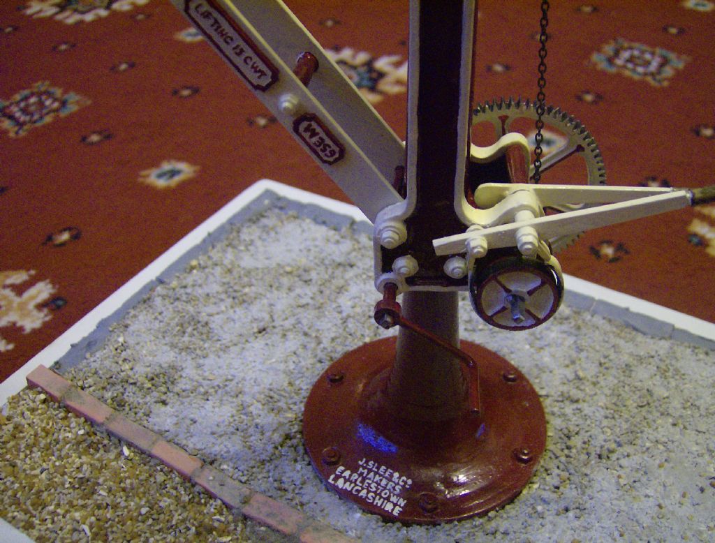

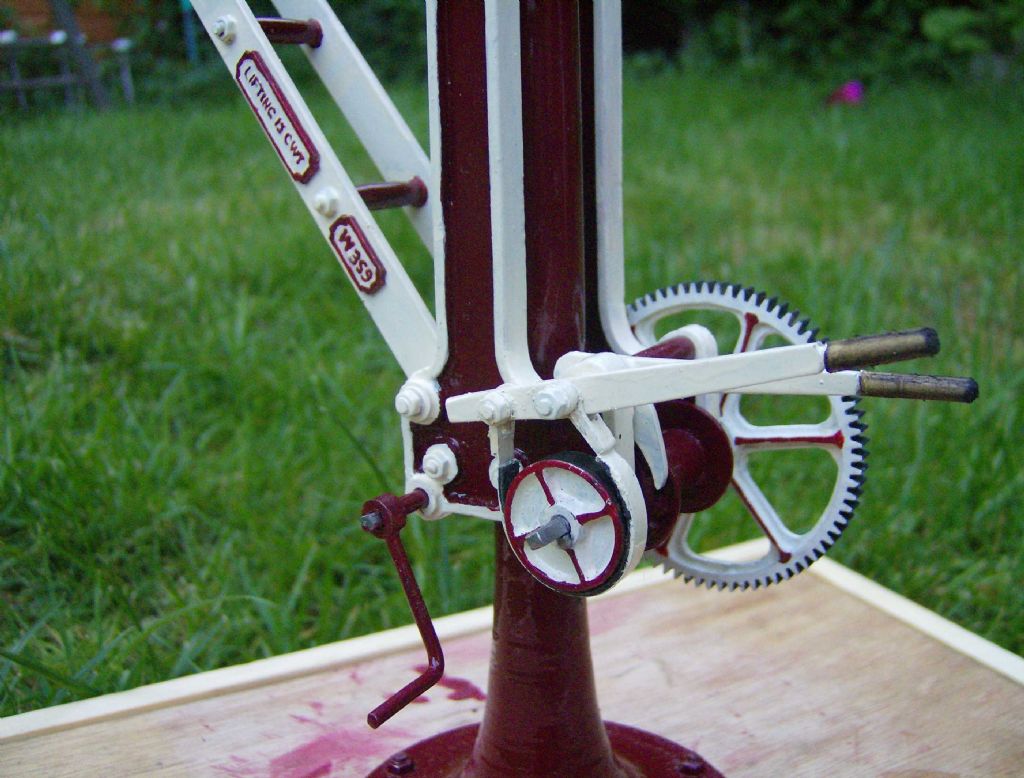

      The crane is nearly finished – just needs a suitable chain and hook.
      You can see (just) how I dealt with the missing pulley problem – its at the top, but offset.
      This nasty box is going to become a short section of canal towpath, with a cement base for the crane and DAS clay stones along one edge.
      The flash and the close up aren’t too kind to my paint job!!

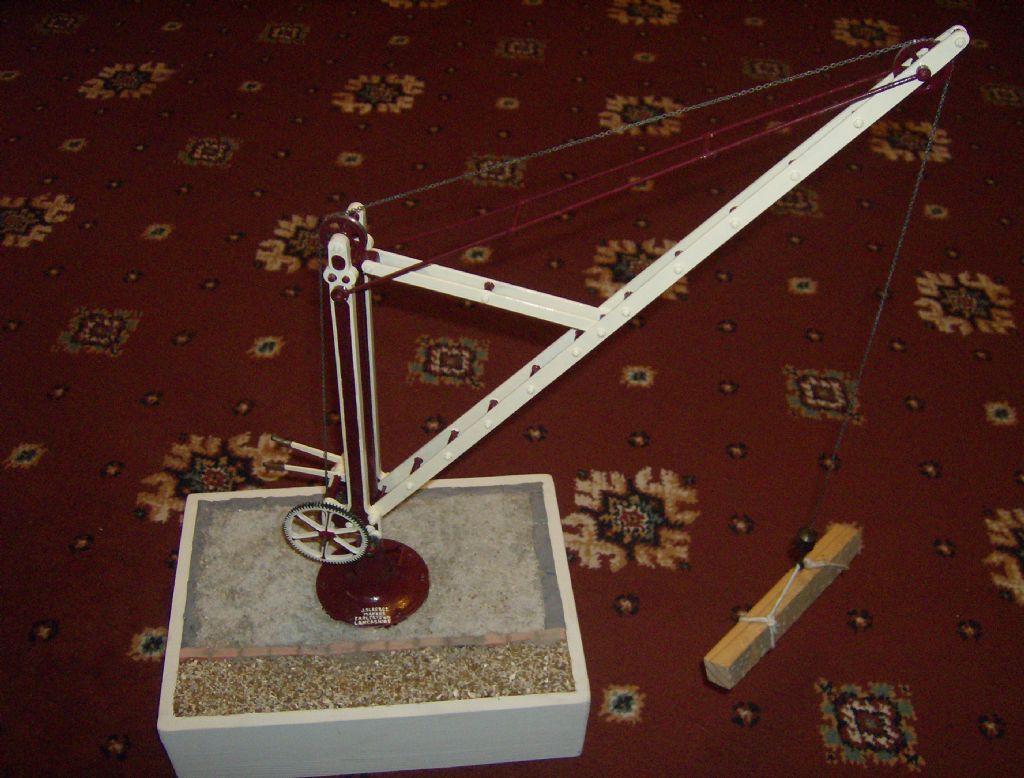

            Crane now finished! It works too, using winder, ratchet and brake, as long as the hook is holding a couple of ounces.
            The chain is brass, but I got Jenoloite Koldblak to work on it.
            Thanks to all who gave advice and ideas. My daughter says its cool, so that’s something

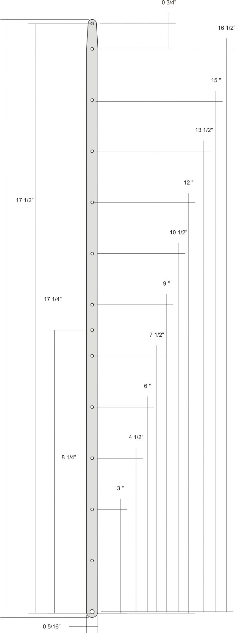

                Question for Neil or anyone here who has built this from his plans: the jib is shown as a bit over 8" long on the plan, which is clearly incorrect based on the column height. Are the published dimensions for this 50% actual? In which case is the jib thickness still 1/16" x 1/4" or should it be 1/8" x 1/2"?

                      I think rogue auto dimensioning may have meant that one version of the plans had wrong dimensions when the jib was scaled to fit the page. The plans have been revised, these are the correct dimensions:

                              A couple of follow up questions: What's the width of the jib material? It's not dimensioned on the plan, but looks to be about 3/8" . Also, the width of the top spacer is shown as 1" while the bottom spacer is 1 1/8" . That difference would make the main frames taper slightly towards the top. Is that correct? From the photos they look to be parallel.
                              #448275
                                Neil, your revised drawing has two dimension lines that don't point to anything, the 3 1/16" and the 8 13/32"
                                Edited By JasonB on 22/01/2020 18:26:39

                                      Bill, that is one end of the 8 13/32" which does not relate to anything.
                                      Also just noticed there are two lines at bottom right with the lower one not related to anything but is one end of the 16 1/2" dimension.

                                        The two orphan dimensions should go to the holes they miss by a bit, both of which are correctly positioned if half-way between the holes on either side of them.
                                        5/16" wide.
                                        Here's a revision, as good as I can get with Corel Draw, which keeps snapping to odd places so some of the lines are poorly aligned.
                                        Not sure overall length is spot on, do it by eye to match the hole, note the taper at the far end which is very important for a good appearance
                                        This is why I use proper drawing programs these days…
                                        Edited By Neil Wyatt on 22/01/2020 19:03:09
                                        Edited By Neil Wyatt on 22/01/2020 19:04:53

                                          Posted by Neil Wyatt on 22/01/2020 18:58:08:
                                          3/16" wide.
                                          But you have added a 5/16" width dimension.
                                          However 3/8" width would seem to work better as that would give a 3/16" radius at the bottom and say 1/8" radius at the top and therefore 3/16 + 1/8 + 16 1/2" + 3/4" = the 17 9/16" overall length from the first revision you posted

                                            Pretty sure it's 5/16, problem is the dimensions are a law unto themselves… some seem to have aligned with centres of holes others with circumferences and then the auto functions rounds them…
                                            The problem is the program doesn't seem to let you edit starting points if snapped to objects and you ahve to zoom out to see the whole extent when you place them which means you can't be picky about where they start/finish.
                                            As I say, this is why I use proper software now…
                                            The main holes are 18" apart on the real thing, 1 1/2" on the model. A quick look at the photos of model or real thing should be enough to get it looking right.
