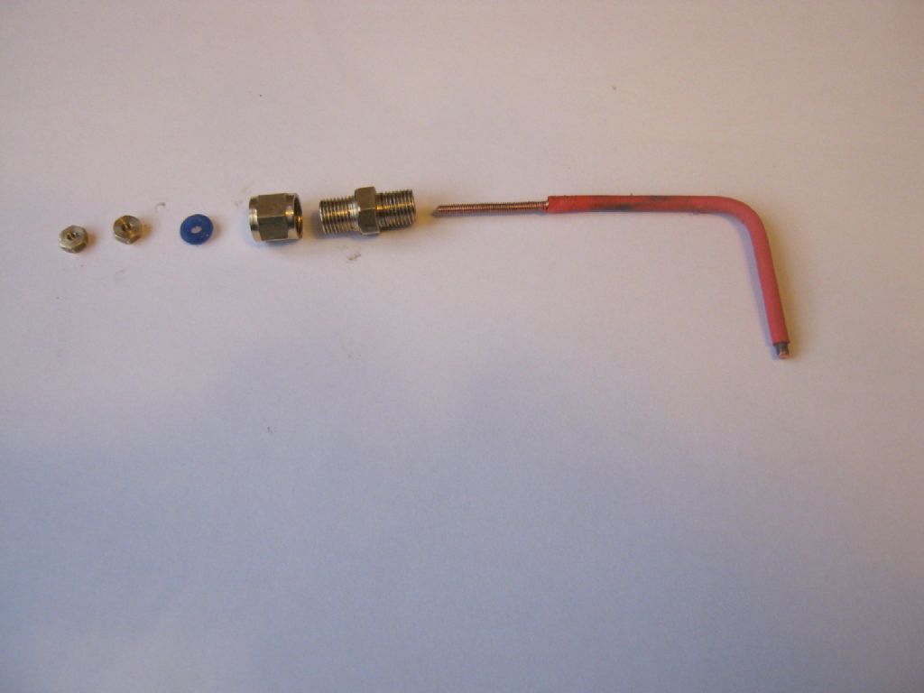

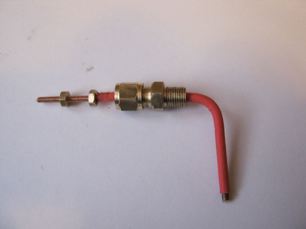

                          #438571
                          michael howarth 1
                            @michaelhowarth1
                            Water level sensormg_1528_1.jpgHaving decided to go for the electronic water level indicator, I have knocked up a sensor which will feed into a spare boiler bush and go about 1 inch lower than the bottom of the gauge glass. When the circuitry is complete an LED will tell me when I have about 1/2" of water covering the tube plate. I had worried about producing an insulator with a copper core which I could bend into a right angle but I solved that problem by using shrink tubing. I now have an early warning from the sight glass and a shut-down warning from the LED. Thanks for the interest.
                            Mick
