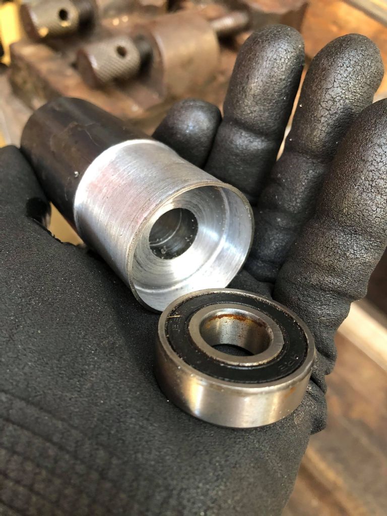

                            More interestingly i made this today. Slowly learning different techniques and getting better overall. Also understanding depths a lot better. One thing i dont quite understand is why the tool takes another cut when im winding back out after the initial cut. If i take a cut, the tool shouldnt cut on the way back, should it?
                            83694413_215803022852439_7365408984196861335_n.jpgThis piece was to re engineer my table saw winding mechanism to use a purpose made crank instead of a re purposed pulley. It involved welding pieces together and turning to make the piece true. Drilling and tapping, chamfering, boring, facing and turning a shoulder. Absolutely love having this lathe.

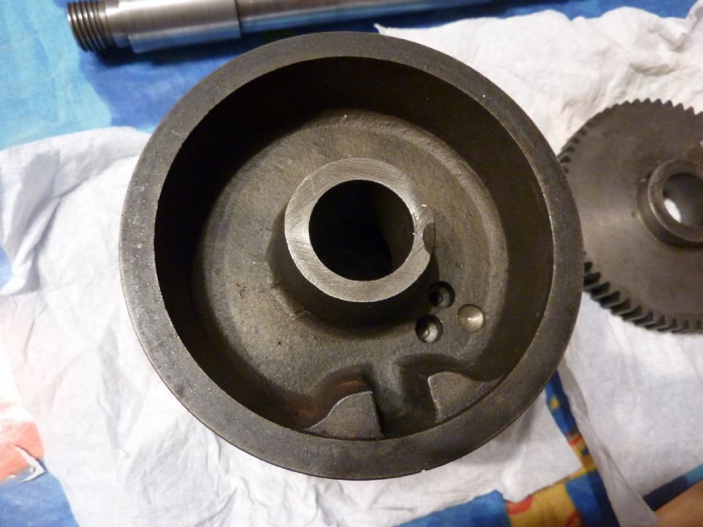

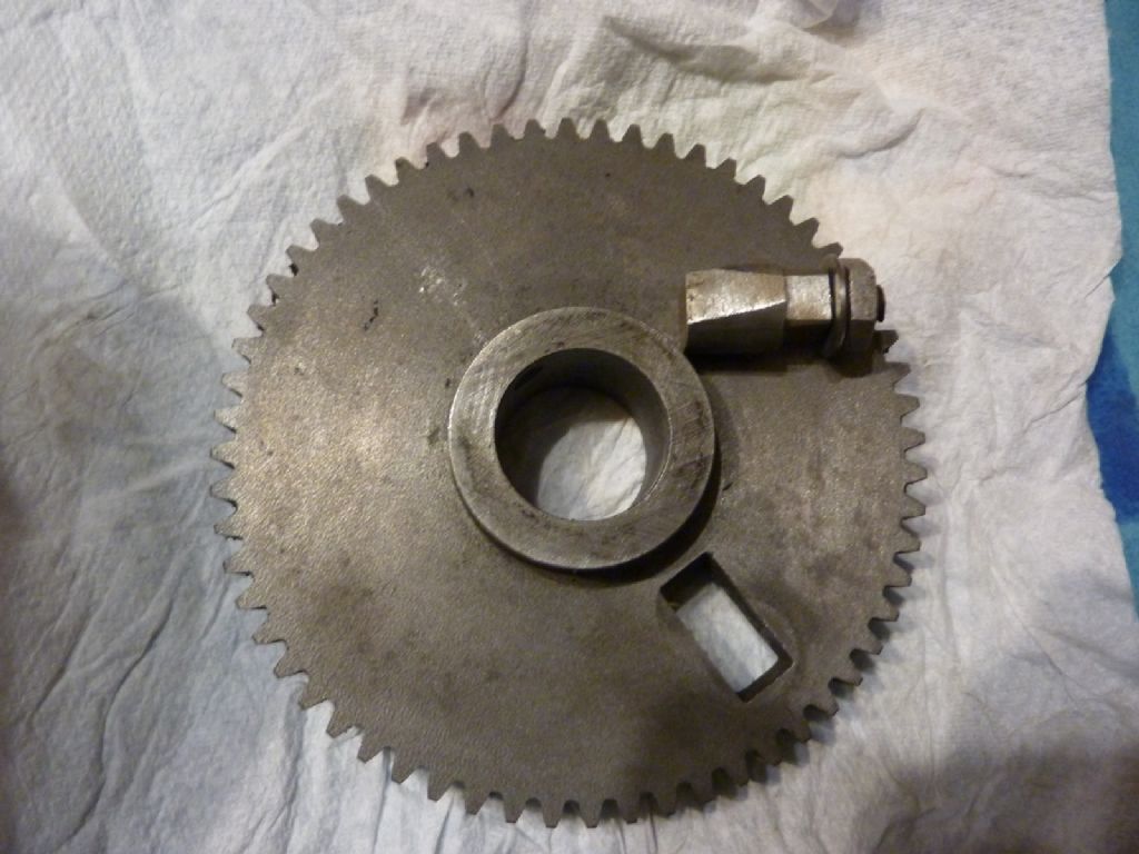

                                    The clunk is most likely from the locking peg on the bull gear (the big one near the chuck). It's a fairly loose fit in a slot in the big pulley casting. The nut just holds it in position on the gear, it has no effect on the part that is making the noise.
                                    If it's really bugging you then you can take the spindle out and take all of the pulleys, collars and gears off it and then wrap some tape around the peg… or (more difficult) make new peg that fits better. I did this (the tape thing) for a while but now I've got used toit and it doesn't bother me.
                                    If you do take it apart then take a photo before removing the peg – it has four possible orientations… only one of which is correct.
                                    I'm not convinced that this part worked out as intended – it has tapers and curves on it which appear (to me) to be designed to make it easy to locate and then provide a snug fit and avoid the clunking. The trouble is that if you refit it so that the tapers and curves 'make sense' then you will probably find that the peg can't be fully disengaged once the spindle is reassembled. I'm sure you can guess how I know this.

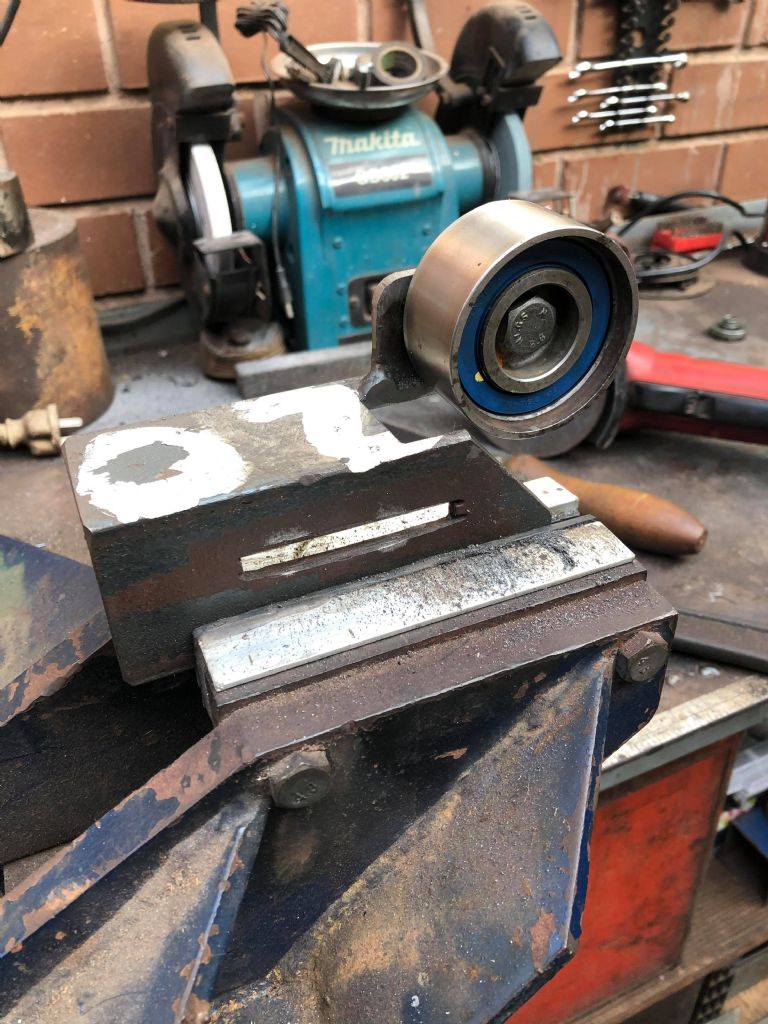

                                            I wanted to share a few things I made.

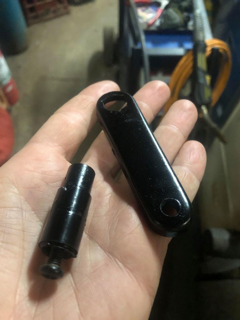

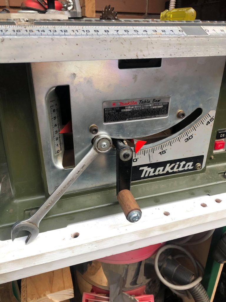

                                            I converted this old table saw from a door knob twist height adjuster to a proper crank handle. Lathe was so handy as I made a tight sleeve to go over the shaft which then uses a set screw to lock on. Even used the lathe to drill through the wooden dowel. Got to learn a lot about drilling and boring, although I think my tailstock is still out as my drillbits tend to 'orbit' when im drilling holes on the large side.

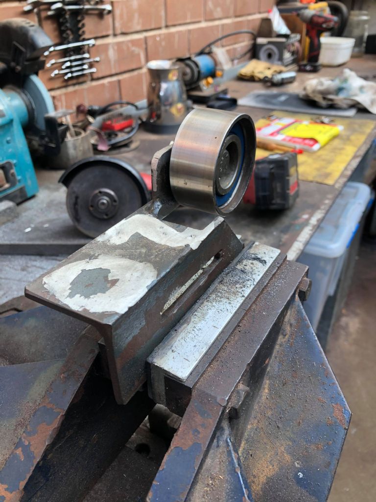

                                            This is the new belt tensioner to replace the old one that was making that much noise I couldn't hear the lathe rotate. 107590801_580296339512562_2306813154290893693_n (1).jpg106279683_3233511523358629_6769114184429982558_n.jpg

                                              On my lathe the part of the peg that goes through the bull gear slot is square so once the spindle is assembled you can't reposition it.
                                              I found a couple of photos of the bull gear, peg and the end of the pulley. As you can see the slot in the pulley is not a precision thing. This is what the peg is rattling in.
