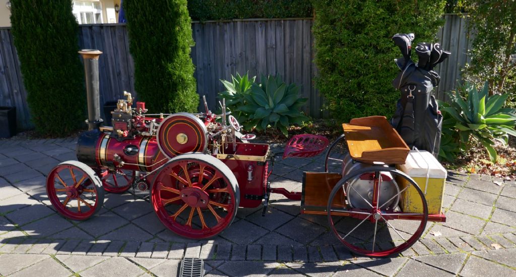

                          As already mentioned, the size of your model depends on the size of the original engine. I have a 6" scale Ruston Proctor SD which is about the size of a 4" Fowler 4NHP engine and took 7 years to build.
                          The capacity of the lathe in workshop should not be the limiting factor for your build. You can get the larger parts made elsewhere. I only have a 9" x 20" Southbend lathe (4 1/2" swing) and the flywheel is 15" diameter, which I did on a bigger lathe owned by a fellow club member.
                          I found that the majority of the machining was a milling operation and not turning.
                          Build of my engine found here: **LINK**
