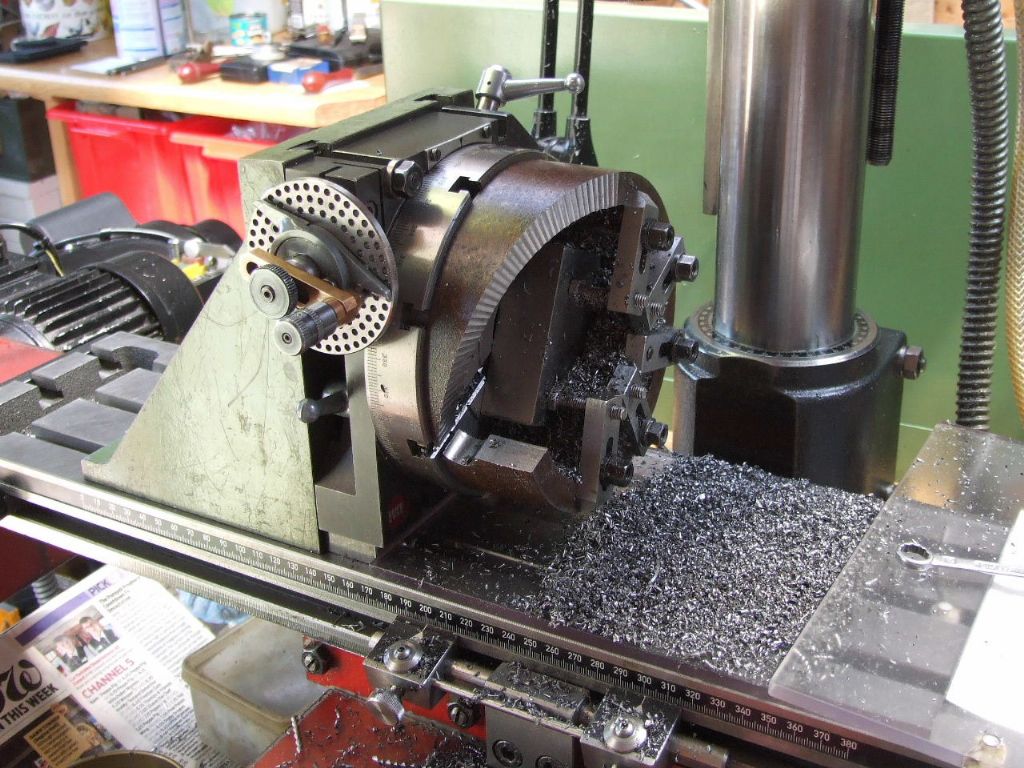

      I thought I would share another project with the forum. This involves garden engineering. The rear gates to my property are substantial things and originally the largest gate would open fully and run parallel with my boundary. Due to the lane surface now being higher than it used to be the gate will only open 120 degrees.
      While I could have had the hinges for the gates cut off and welded back on higher up, raising the gates this would allow cats and small dogs to come under the gate. Thereby creating another project to stop this.

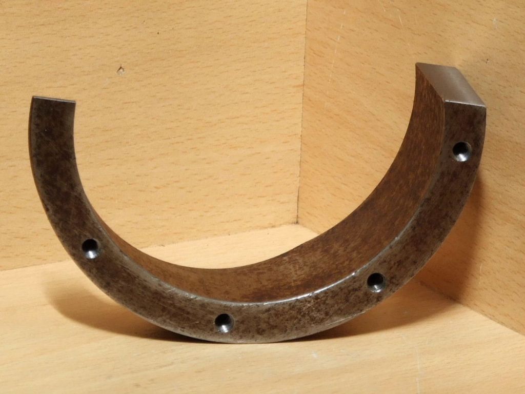

      In the end I have decided that if the large gate could rise as it is being opened by about 40 mm then this would make things easier as only one gate needs modifying.
      Thus the FB 2 was pressed into service this week making the cam to raise the gate.
      The piece of thick wall pipe is 140 mm diameter and 13.5 mm thick. The picture taken this morning was yesterday afternoons work. Hand finishing this morning finished this part of the build.

          That's the EMCO rotary table and 90deg angle plate doing the job? Just shows again what the FB2 can actually do! Presume that was co-ordinated rotary angle and X table position to rough mill the profile? How did you do the actual cut? Was it a Z plunge – if so did you use the Quill handle or move the entire head down in Z? Or did you sneek up to the cut in X only?

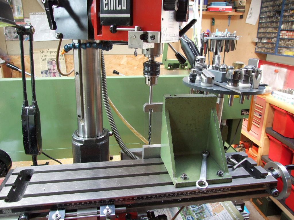

            I drilled a 6.5 mm diameter hole at every 5 degrees moving on the X axis at each location. This was the largest drill due to the centre to centre distance. You can see the plot position list, (not very clearly) under the spanner.
            This process was followed using a 14 mm slot drill, fed down manually using my fine feed on the quill. Finally the form was cut using a 20 mm slot drill, this cut was done using the powered down feed. I then set the rotary table over to correspond to a 2.5 degree increment and went through the same process with the powered down feed to take off the bits in between the previous cut. The last operations took just under an hour. The manual dressing to take off the peaks took about half an hour.

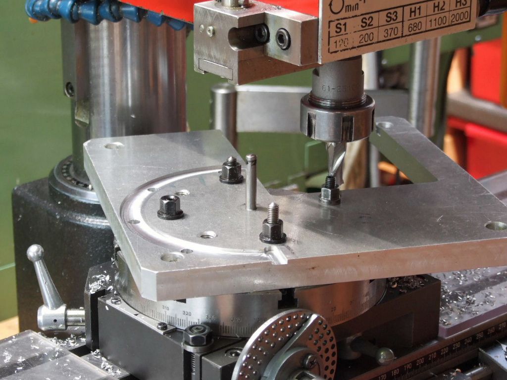

                  Yesterday was a good day, despite the 33.5 C workshop temperature. The mounting plate for the Cam is now complete.rotary table set-up.jpg
                  The profile of the plate was an old jig base salvaged during my Toolmaking days, this includes the four counterbored holes in each corner. The various mounting holes and rotary table location holes were done earlier in the morning as was the rectangular pocket,
                  The extension handle for the rotary table is one I made years ago, it saves having to fumble around under a component for the table handle,
                  The last operation was to drill and tap an M8 stud hole, to clamp the mounting plate to the post.
                  Note how the job is dropped over the back edge of the table to gain room under the spindle nose and the workhead is slewed around to get to the job. There is not enough travel on the Y-Axis to allow the workhead to stay in its normal position.

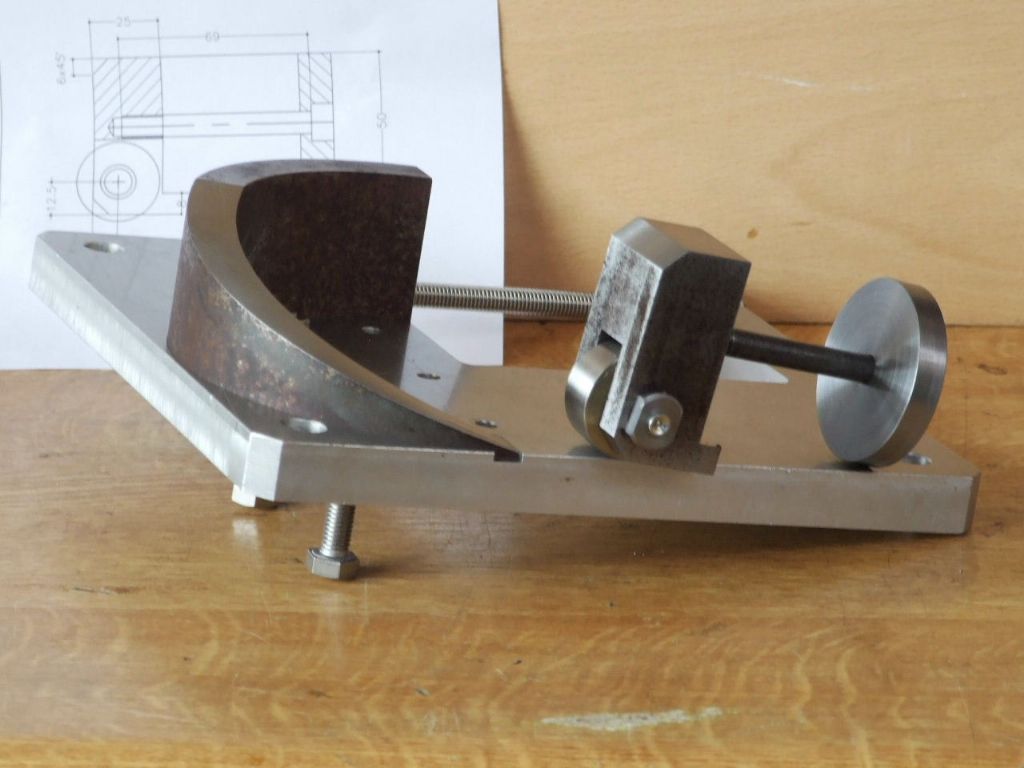

                    This morning I made the final piece of the jigsaw, note the grease nipple for future lubrication, if I can bend down to get to it?
                    Then began the fitting of the completed parts to the gate.
                    Well I hope you have enjoyed my bit of Garden Engineering, there is still things to do to finish the job off. Like putting some concrete beneath the aluminium base plate and extending the hinge pins. The latter is under way but I am waiting for the loan of a right angle drill to do this operation.

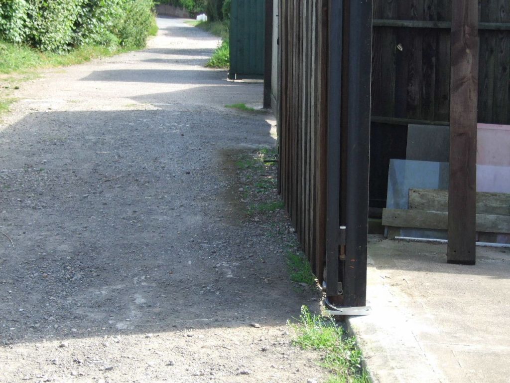

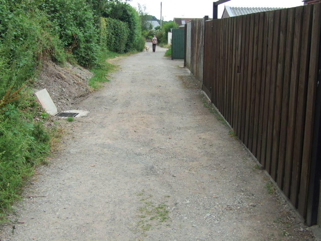

                      Very Neat! I would like to see a photo of the swinging end of the gate and what it had to clear in the lane…
                      You mentioned this need came about after some Council repairs to the surface. Hopefully they don't do that again! Although I guess next time you could put a 10deg inwards tilt on the gate post..
                      Nicely done.
                      Joe
                      #421625
                      Graham Meek
                        @grahammeek88282
                        Hi Joe,

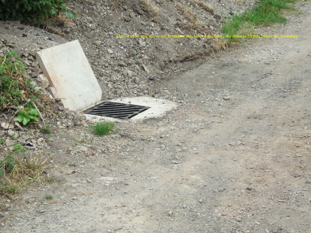

                        Until recently the slope or fall on the surface of the lane was towards the property boundaries on my side of the lane. The result of this is flooding to the rear of the properties. The repairs to the surface by sub-contractors over the years have added to this. The district council view is that water will flow up hill in this part of the Universe and into the french drain they installed but have no record of.
                        It does not help that outside my boundary is the lowest point in the length of the lane, that is both ends are higher.
                        For the past year I have been struggling to get anything done, however last month the County council installed the drain you see below and graded the lane towards it, but only in front of my boundary.
                        The result was my gate just clipped the far corner where the ground is higher. Why not just take this bit off? Well this is a public footpath, and to tamper with this surface carries a hefty fine. Not to mention a liability for anyone who should get hurt from said tampering.
                        Hence my solution, I doubt the council will be doing anymore repairs in front of my gates, this has been a costly lesson for them.
                        Regards
                        Gray,
