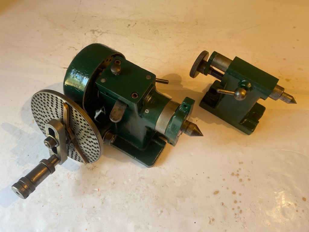

      Dear All, I would be grateful if anyone could help me with some information regarding a 4 1/2 inch swing Elliott dividing head. I recently aquired one and it has turned out to be a little[!!] beauty when cleaned up. Like most of these its change gears ,quadrant , sector arms and washer have long since parted company. Luckily I have had lying in the work shop for years a full set of 1 inch gears [rising by fours ] which I suspect originally came from a dividing head.I have made a new handle and detent based on the one on my theil dividing head. I will base the sector arms likewise [unless I can find an original set somewhere]. I have the plates ready to drill and the steel for the Banjo. However i should like to know the centre distance of the 2 parallel slots on the original banjo and Ideally a source of the spring steel 'c washers'[dont know the correct term]. I have tried all the usual sources and second hand suppliers to no avail. Can anyone let me know the dimensions and a supplier,
      Thanks in anticipation Ian
      P.S have got a manual from ebay which applies to7, 8,10 and12 inch swing but no mention of 9 inch swing model

          Ian, have a look at the forum on the homewokshop.org site for a post dated 23 jan. titled Elliott 3 1/2 dividing head. The repondent Peter turned out to have the full kit for a larger head, 4 or 5 inch so can give dimensions for scaling. I don't think the spacing between slots has a material effect unless you are trying to be authentic.
          What size taper is in the nose MT4?
          What is the C washer used for?
          Does anyone know if the Elliott/Victoria style plate lock (a pin on the rear) was intended for compound indexing as I have only seen double sided plates mentioned in connection with a Cincinnati head? A few extra locking holes in a standard plate could add extra range with minimal effort.
          I take it you know the standard set of gears listed for the tables in Machinery Handbook, B&S and Elliott data are 24,24,28,32,40,48,56,64,72,86,100 though a 60 is also used for 201 divisions. The 86 gear is ony used for the 106 train so of limitted value. Of course the ratios can mostly be produced with other gears too but it is amazing how they managed to work all the tables out to use the minimal set of gears before computers were invented.
          If you are interested I have transferred the Victoria differential indexing tables into Excel for convenience.

                  It is actually not very hard to work out a setup for any desired division with a differential dividing head. I covered how to do it in the article I submitted about four years back on converting a Vertex BS0 head.

                    Dear Bazyle [and others],thank you for your replies.Sorry for delay in replying but only just had time to get in the workshop to check that the spindle was indeed 4mt.You know how it goes ,your sure it is 4mt but as soon as you state that it will turn out to be 41/2 mt. IT IS 4mt with the nose 2"x10tpi.The "c" spring clip I referred to is used to keep the sector arms in place on the spindle and add some downward thrust to stiffen.The set of gears I have is as you state, only has one 24T They are 14 DP,1 inch bore with a single keyway. The one original plate I obtained is 9 rows of holes with one hole in the other face for the locking pin which I took to be used for compound indexing.I have now registered with homeworkshop .org and are awaiting their approval.I would indeed be interested in the excel tables as have just bitten the bullet and set up computer and internet in shed! Thanks again for the info,
                    kind regards Ian

                                  #474046
                                  OneManEngineering
                                    @onemanengineering
                                    Guys just uploaded couple of pictures of the revival of this nice piece of kit. Please have a look at my album.
                                    Also I will upload some footages as well after I finished editing. Youtube link will be provided…
                                    I have to say I am pretty pleased with it.
