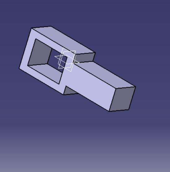

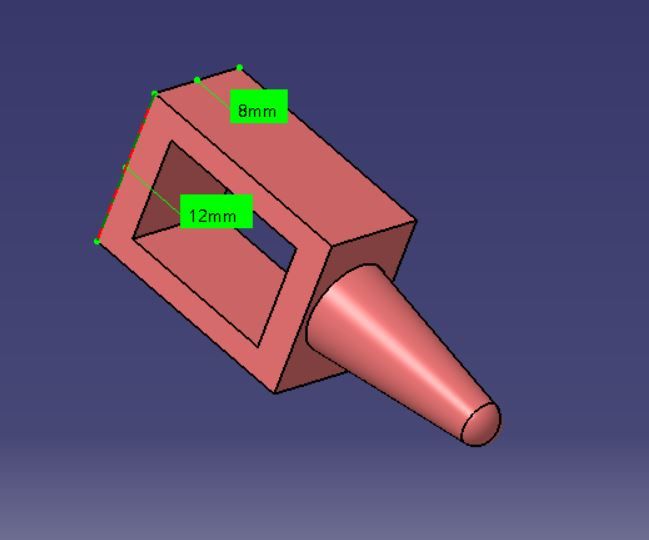

      As a novice is there an easy way to centre a rectangular shape in the 4-jaw. I have to machine a taper on my tender spring buckles. I have the basic profile laser cut as shown in the first picture, with the taper in the second. Thanks in advance.

          Place in 4 jaw with packing plates to cover the open sides. Set one face of the job to vertical. Wind in the cross slide to touch the job preferably with a DTI, but can be done with the tool tip, and set dial to zero then rotate chuck through 180 degrees and touch the job again. Note the difference and adjust the chuck jaws to move half of the difference. Repeat for other sides. Colin

                Once you have the first one set in position, the subsequent parts can be positioned more quickly if you release only two of the four jaws, remove the part, insert the new part and then tighten up the same two jaws again. Thus the two unmoved jaws act as fixed datum surfaces. Of course this assumes parts are identical in size. If there is some small difference, the necessary small adjustment will need to be made, but still quicker than starting from scratch.

                        Thanks for all the replies. I had worked out that the method was as per Colin's response, but was concerned about the problems that Dave highlighted. Just worked out a possible helping hand though. Use my Wixey angle gauge to set the part parallel/perpendicular to the cross slide before attacking it with the DTI.

                          As you have a lot of them, set it up on an angle plate on the faceplate. With the angle plate level you can set the height with a pin In the tailstock, same diameter as the thickness of the part. Get the first one then central and you can get the Have a loose clamped stop ready along the side and fix it when all is in place.
                          The result is only having to set up once, all the rest will be positioned by the stop.
