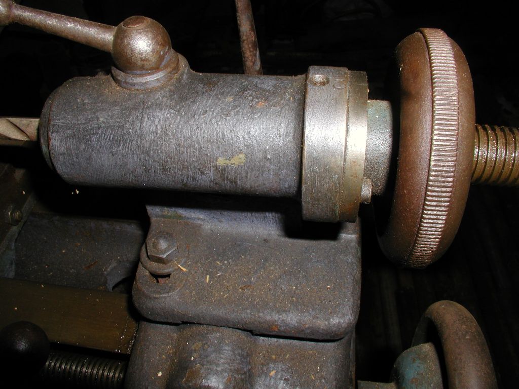

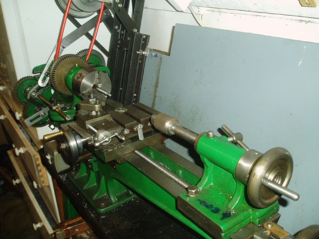

          Hi
          A 125 micrometer dail dail fitted to my  drummond flat bed lathe .

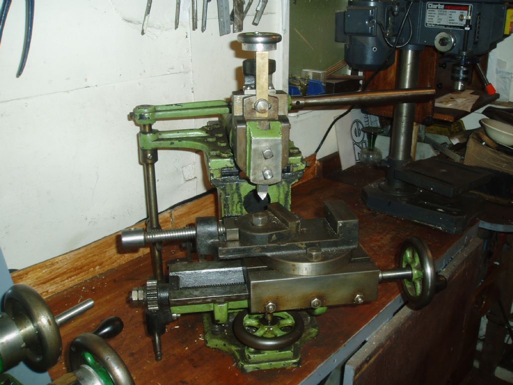

            I’ve got a bearing on my cross slide leadscrew now, and am just finishing off a milling spindle which is on a mini 180 degree turret holder with a unimat style forward/reverse headstock system for drilling/milling from weird angles, and am doing a headstock spindle locking mechanism this weekend.
            Drummonds are kewl.

              Hi Andy
              Drummonds are Kewl !!!!!

                That looks like an ML4 tailstock to me.
                Not a Drummond IMO.

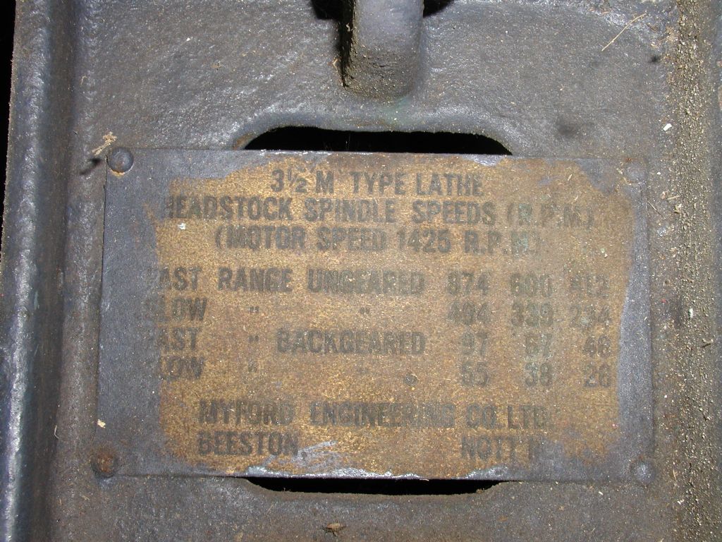

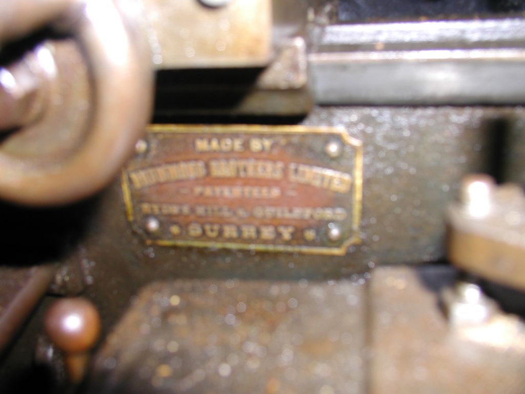

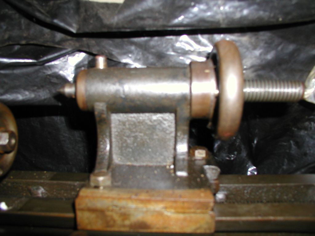

                      Hi,
                            well just to get you more confused, top pic Myford, Bottom pic Drummond.
                      The manufacturers plates are below each.
                      Sorry for pic quality, but they are under raps at the moment and a bit hard to get to.
                      Regards Nick.
                      P.S. The Drummond one is the same type as Nobby’s one.
                      Edited By Nicholas Farr on 16/01/2011 15:01:55

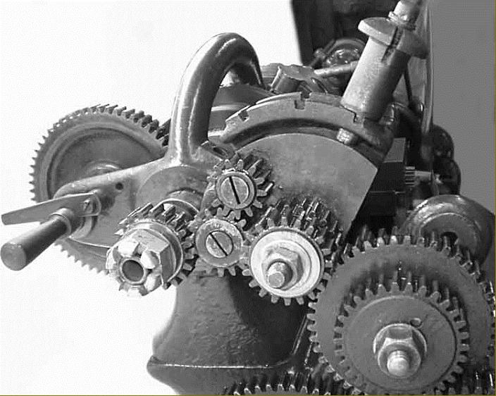

                          I’m afraid that you are mixing your models and ages.
                          Nobby’s is a 1903 – 1912 model, commonly known as a Pre A type. This was the first full production model of the 3 1/2 in flatbed lathe. It did not have a designation, but earned the Pre A type name when Drummond brought out the A type Roundbed in 1908.
                          Ady’s is a 1925 – 1940s M type.
                          In 1912 Drummond brought out a new model lathe, completely different to the previous Pre A type. This was the B, recogniseable by the strengthening loop casting on the headstock.
                          In 1925, Drummond brought out the M type which is really an uprated B with a stiffer headstock, so did away with the loop on the casting. They also added a rack and pinion for moving the cross slide along the bed but be warned…turning the handle clockwise moves the cross slide TOWARDS the headstock!
                          B and M parts do not fit the Pre A, but many are interchangeable between the B and M as they used the same bed, such as cross slide, topslide, tailstock, and changewheels.
                          The M tailstock is recogniseable from the screw adjuster at the back for offsetting while the B type is a plain ‘slide and hope’ type
                          In 1942 the Ministry of War Production told Myford to take over the manufacture of the Drummond M type so that Drummond could concentrate on their larger lathes.
                          Myford used Drummond-made parts until they ran out, and used the Drummond serial numbering system too…for a while.
                          By the end of the war, Myford had added a changewheel guard made of cast iron and went on to ‘electrify’ the M with an electric motor mounted on the back of the stand.
                          Myford brought out their new model 7 in 1946, but carried on supplying Ms until the late 40s/early 50s.
                          There are NO interchangeable parts between Ms and 7s! The beds and headstocks are completely different, as are changewheels. The T slots on the cross slide are slightly different dimensions and spaced differently too so topslides don’t fit except with a bit of engineering.
                          For a full account and some brilliant photo essays on the Drummond lathes go to Tony Griffith’s website as I mentioned originally…in fact, everyone should visit as it is the most comprehensive machine tool archive in the world!

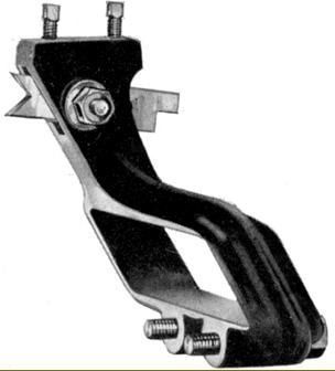

                              Does anyone have a casting for one of these please? Its from a Drummond M
                              travelling steady for drummond M reuired  either casting or ull item

                                Hi Martin,
                                There is a complete one on eBay right now, item number 182652846395.
                                They come up fairly regularly and are more common than castings

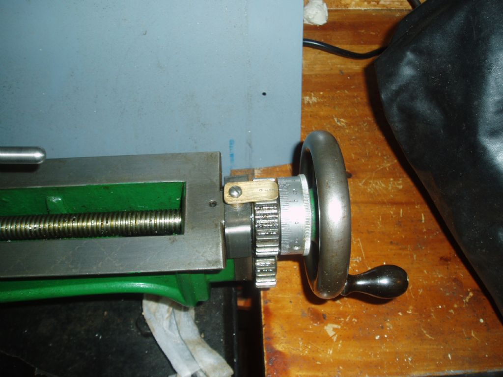

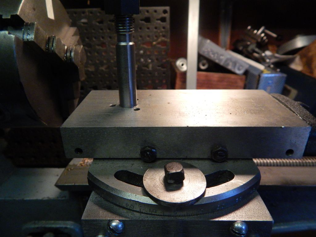

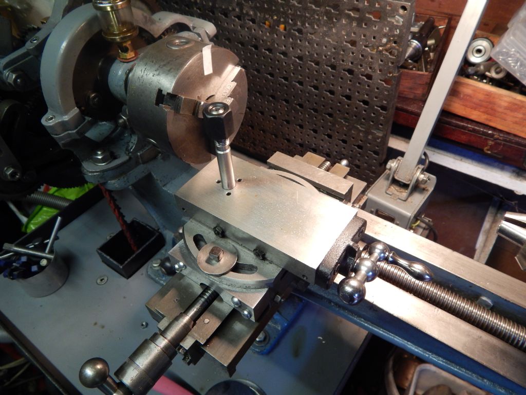

                                  Ta andy have been busy with my ml7 conversion. Its great and everying can be retro fited back to the original First try with all the parts expect gibb plate
                                  Edited By Martin Newbold on 17/07/2017 19:49:24
                                  #307625
                                  Martin Newbold
                                    @martinnewbold
                                    I still need a metric dial and gib plate but Myford Ltd are to busy in thier work shop to make gib plates at present
                                    heght looks great just need a gib plate

                                              I'm trying to figure out if you've used a Myford 'new' topslide here, and milled the top off it to improve tool height? Question is really how much you managed to take off? And what machining it involved?
                                              Cheers, Colin
