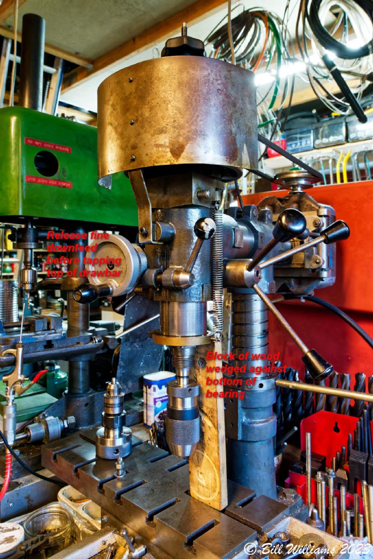

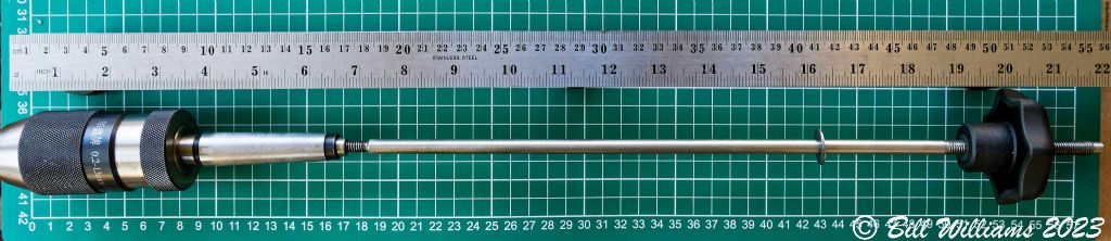

                    On My DW Mk1, I've used a length of 8mm bar, with the top few inches threaded as M8, and the very end turned down a bit to save damaging the thread.
                    The bottom end has been turned down to ¼" and threaded BSW.
                    Like Phil, I have a set of short stubs to suit my MT2 taper arbors, internally ¼"BSW, with some externally threaded to M10, and others to 3/8" BSW, as I've got both old and new tooling; mine however aren't Loctited in as I also use the arbors on the Centec,
                    One important point, is when tapping the end of the drawbar, be sure to release the fine downfeed worm first, to save damaging it.
                    I forgot once, and now have a very light tight spot where I've distorted something slightly; it's now wearing in again so gradually curing itself.
                    Also, rather than risking shock loading the main spindle bearings, I lower the spindle a bit and insert a length of wood between the end of it and the table, to absorb the impact.

                      Sorry not quick enough to edit post, so see added photo here

                        you are a gentleman and a scholar, the photo is very helpful. I will have a try at making one.

                          Sorry for misleading you initially, My Centec has a captive drawbar, and this makes the arbor self ejecting when you turn it anticlockwise; it's convenient sometimes, and a pain others when I need to change the drawbar as well as the tooling.
                          When you do make one, try and pay lots of attention to ensuring the thread is square to the material; if not, it will be hard to screw into the top of the arbor.
                          Start it off in the lathe with the die/holder against the tailstock or a thrust pad, or ideally a tailstock die holder.
                          If you've never done any lathe screwcutting, maybe this would be a good time to practice.
                          You only need to do the first few passes in the lathe, after which you can finish to final size with a die.
                          If you know all the above then my apologies, but it might help someone re-visiting this thread in the future.
                          I'm fortunate in having a Coventry/Herbert die head so I used that for making mine.
