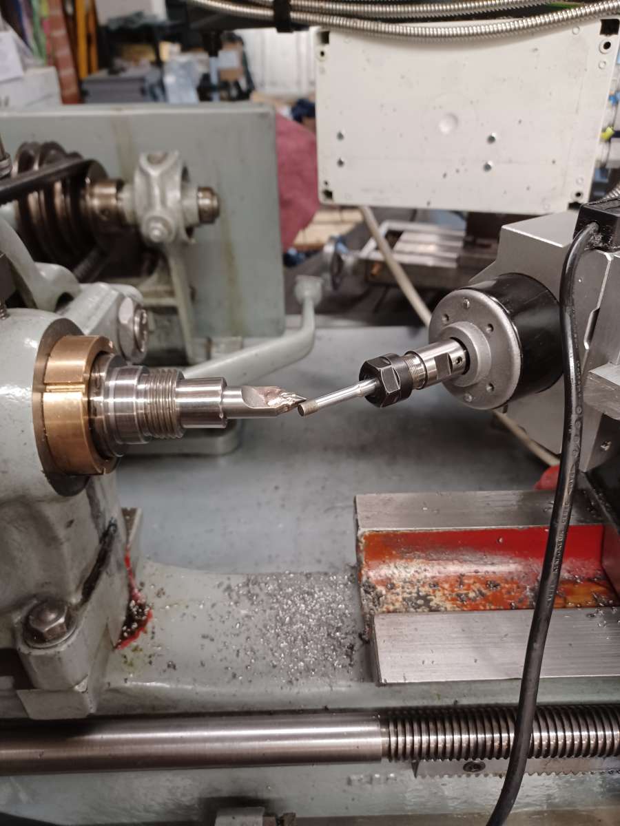

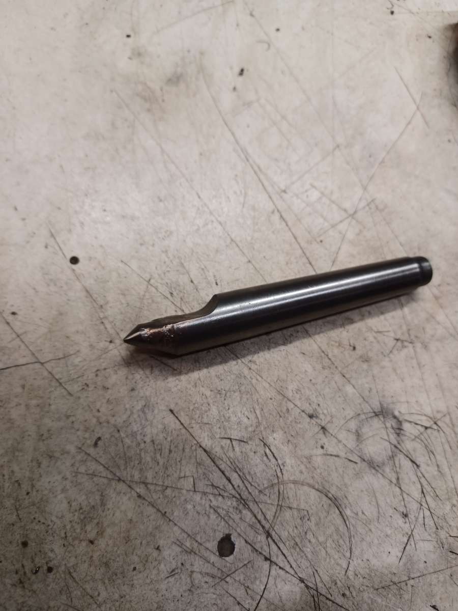

                                  On my tailstock centers I have a live centre which is hardened toaround 50RC which is made from silver steel.  I have a toolpost grinder which is used to grind the tip after it is disembled for grinding. My fixed centre from new was fairly soft and kept picking up on jibe so i drilled the point out and insreted a round piece of tungsten carbide wuichwas brazed into place. This was also ground to a nice point with my toolpost grinder and a diamond grinding point. The carbide doesn’t pick up or wear.

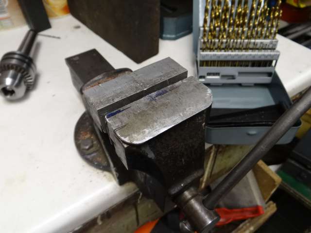

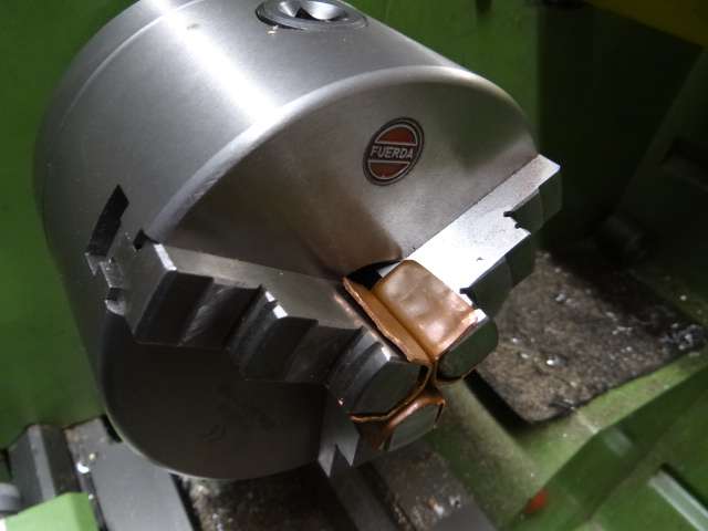

                                          Building on that thought, I usually prefer work-holding to be a bit softer than the workpiece.  For example bench vice jaws tend to score  jobs, so I usually put a pair of DIY aluminium protectors on before gripping anything.     In the same way, I occasionally slip Copper protectors over lathe chuck jaws, less often because the Copper reduces accuracy.
                                          DSC06906DSC06907
                                          So I don’t mind fixed and live centres being on the soft side.  They’re less likely to damage the job and are easy to resharpen etc.
                                          Another thought: Bevel has written off two live-centres.  Maybe they were poorly made from a bad batch.  Or could it be they were forced too hard into the job?  The tailstock only needs to be wound tight enough to support the workpiece.
