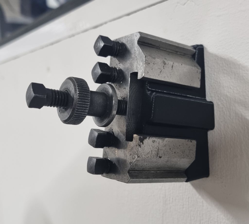

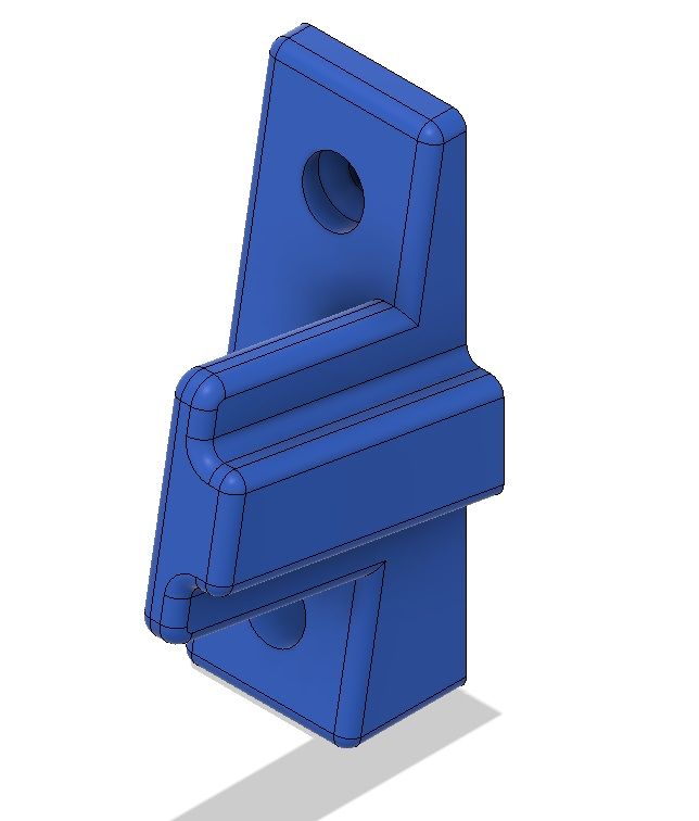

      I have built a workshop but didn't really want to just put my Dickson tool holders on a shelf, I had seen various designs & a supplier of a pre-made one, then a friend pointed me in the direction of a 3d-printed holder that sits on a bar. Using this as inspiration I thought I could design something that I can screw to the wall. I decided I would make them as individual items so I can just print more as I want. Here is the end design.
      I printed one, only to find that not all the dickson (style) holders were the same, so some didn't fit. A quick change and here is the first one attached to the wall.
      I now need to print another 10, at about 2 hours each it will take a time! 2 more are printing as I type, I could have got it to print more in one go, but I don't want it running overnight really.
      Having done this I may make more special storage for other lathe accessories, such as allen keys, chuck keys and chuck jaws, all good for learning 3d-cad, this time may be Solid Edge so I can compare that with Fusion360.
      For those interested the design was complete in Fusion360, the hardest part was working out how to put in the screw-holes perpendicular to the back, then put the counter-bore from the front, but not at an angle. After a bit of looking at web-pages I realised what I needed was to create a plane from the back, offset forward, draw on that and make holes from there, simple once I realised that.

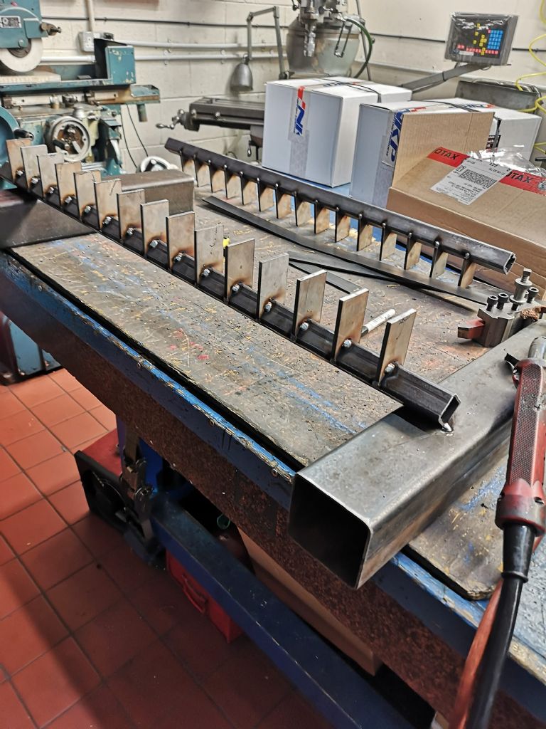

            This took about 20minutes and £5 worth of material:
            and

              Simple but effective Nicholas. I keep mine on a shelf attached to the splash back at the minute.

                      I did look on Thingiverse, there was nothing that I liked, there are some there but I felt they would take up a lot of wall space as the holder would be along the wall rather than perpendicular to the wall. The are a few designs to hold indicators in the toolpost though that look interesting.

                          Oldiron, I would have had to get some material in to do that job or cut up a largish sheet, so for me it was easier to design & print, also a good exercise in CAD, even if a simple one. Before I moved I did use a aluminium u-channel screwed to the wall, they then hung of that, it worked but 11 holders took up quite a bit of room.

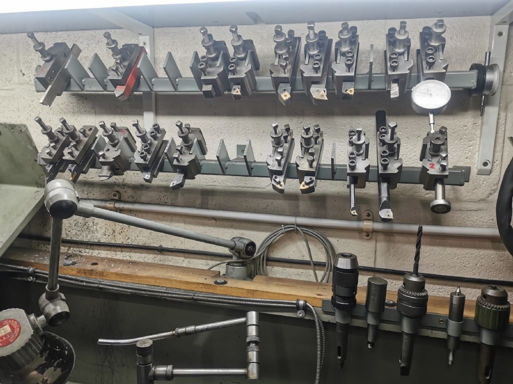

                              This is how i did my Colchester Master i have similar for my Harrison M300 just smaller

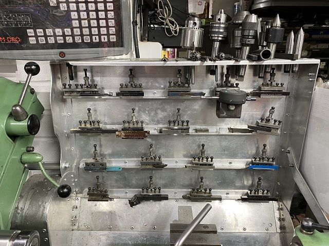

                                Here's my solution..
                                Just a slot in shelf bracket screwed horizontally to the back shelf.
