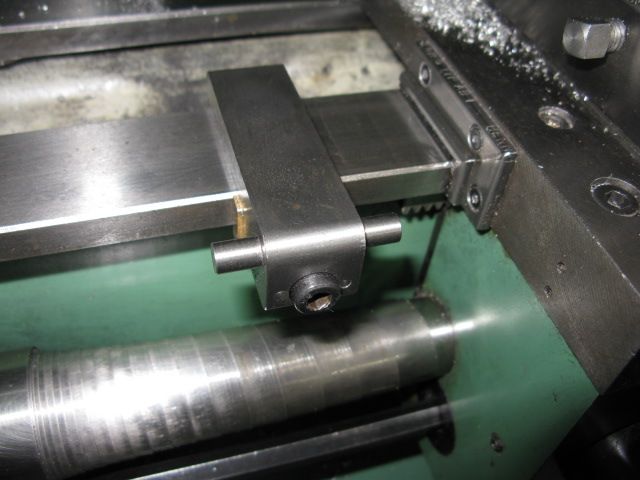

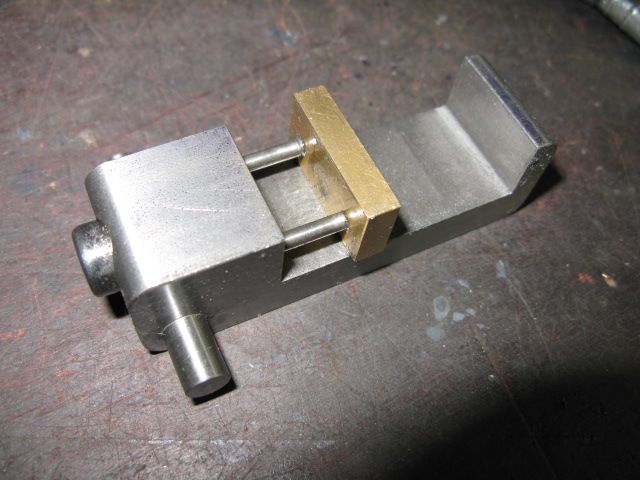

                        The evolution of my lo-tech carriage stop on the Myford ML7. Its main use has been when cutting the lines on graduated dials etc. Different length lines are achieved by use of the topslide, doing all the short lines in one go-around, then all the medium length "fives" and then all the long "tens". But also handy for a stop when turning.
                        stop parts
                        stop new
                        Like most carriage stops, it is not designed to be crashed into under power feed. You disengage the halfnuts just before and finish the cut under hand feed. Even many friction drive feed lathes will overpower the carriage stop and either move it or damage the feed mechanism if crashed into. Drummond M Type had the solution, a dog clutch on the leadscrew operated by a knock-off bar with adjustable settings along the length of the bed.

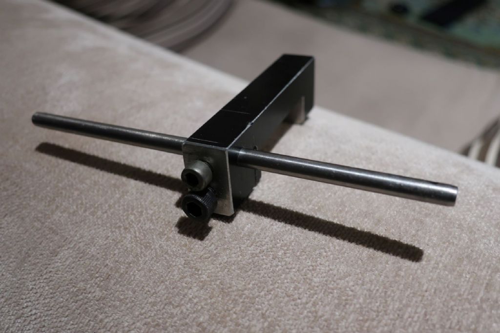

                          img_0274.jpgHi Mart , This is the saddle stop made for my 254 which has a similar non gap bed style to the atlas, fairly easy to make and has proved invaluable since I bought the machine, due to the type of bed wipers on the 254 I wish I'd made the round stop rod a bit longer on the right hand side as swarf builds up in the gap ( I do a lot of cast iron). The 254 has a safety feature in the apron in case of a jam up under power feed, but if the atlas is not so fitted the round stops could be made as one rod passing through the main body with a brass shear pin. The one I made for my ML7R was like Hoppers rigid and I never had a problem with it over many years use.img_0273.jpg

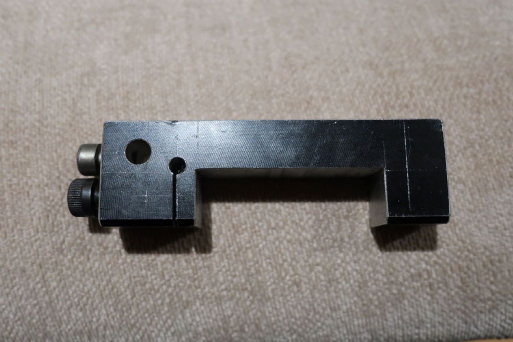

                            Just found a picture of the one for my ML7R in my album, good lathe I miss it in some ways!001.jpg

                                    Posted by Dave Wootton on 09/02/2023 08:29:00:
                                    Hi Dave,
                                    Have you got any sketches/drawings for the 254 version, I can't see how it clamps to the bed and clamps the round rod with only one caphead.

                                      Hi Duncan
                                      The round rods are turned down and press fitted into the block, so they can't move, the adjustment is the whole block sliding along the bed and then being clamped using the cap head screw. works the same as the Boxford and Colchester plain bed stops. I've never felt the need for a micrometer version or anything complicated,I did have a Boxford with a micrometer stop but never used it other than as a plain one. In use I admit to using the shank of a drill or piece of bar between the stop and saddle to set the distance, or using the top slide dial for short lengths, not exactly high precision but good enough for most of the things I make. I recently had to make 30 screws with three diameters on them and milled a simple step gauge out of a piece of bar to act as a spacer for the stop which worked well. I'm afraid I never make proper drawings just sketches, if its of any interest will dismantle and put some pictures on this evening.

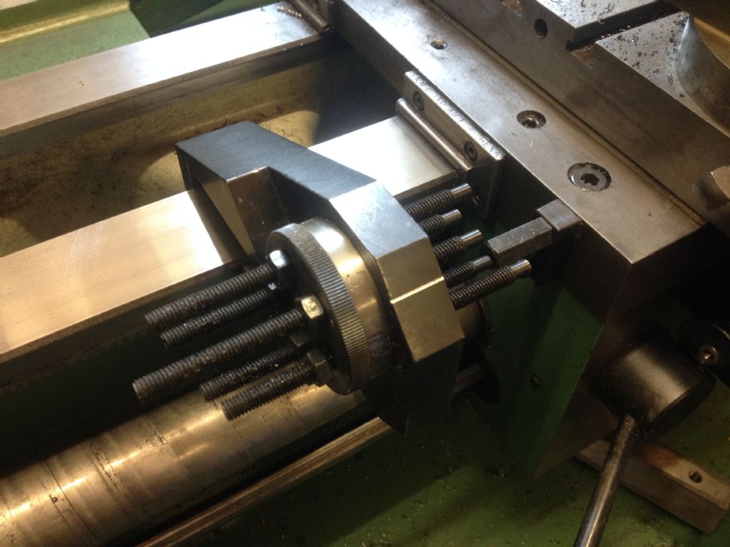

                                              This is the "push" type on a 254. I cannot understand why there is a gap between the bracket and the bed.

                                                  Another variation. Sorry 'bout the awful contrast.. ..a couple of collars so that you can insert calipers / pins / blocks between collar and body adds usefulness img_2073.jpgimg_2072.jpg

                                                      Diogenes, I like your simplified version with the hacksaw slot instead of a separate moving piece. Very clever in its simplicity.
