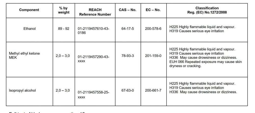

                The highest ethanol content that is legal in CA is now 76.5% or around 150 proof. Its just the strict laws in CA regarding all sorts of solvents. Nothing wrong with using bioethanol. I use it in the UK in preference to the horrible stinky purple meths. I used to but industrial meths from achemical supplier but the bioethanol is cheaper and just asgoodfor my purposes.Burning the purple stuff always gave me a bad head , probably due to the pyridine in it,which also causes the unpleasant smell in most purple cloured meths in the uk. .
                Typical makeup of the stuff im currently using is in pic. Around £5 a litre , burnsclean ,i use it in a spirit lamp and also for dissolving shellac and other resins.

                            Methanol is added purposely to denature ethanol. You dont usually make methanol by fementation but it does contain some small quantity. Yes it would mostly be removed by distillation at around 65 centigrade. Safe enough for use as fuel, making moonshine to consume  is a rather different matter and to be safe more complicated chemistry is needed.

                                As for the MEK in Mark’s table I had a couple of friends who were tasked with cleaning painted on numbers off some lockers in a poorly ventilated locker room so they could be repainted in the correct order (following rearranging). They were found slumped on the floor after the MEK they were using overcame them, luckily they seemed to suffer no permanent effects.
