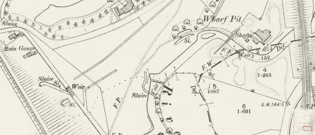

            Funny you should mention coal mining because old maps show a number old coal shafts in the area around the dam. Worse, the 1898 OS Map shows 'Wharf Pit' about 500 feet away from the dam. Very likely coal was extracted from underneath the dam long after it was built…
            Subsidence due to coal mining can be 'quite interesting'. Most modern coal mines extract all the coal in a strip and allow the roof to collapse safely behind as the coal face moves forward. Depending how deep the seam is there will be subsidence on the surface but it could be small and take a long time to appear. Or rapid and and obvious. Older coal miners left large pillars to support the roof and, when the mine was exhausted, would rob coal from the pillars as they retreated back towards the shaft. Dangerous work that left the mine in a dangerous condition; after the mine is abandoned the weakened pillars are likely to collapse causing trouble above, perhaps several decades later. There was an incident at Lindal in 1945 were a steam locomotive and driver both disappeared entirely into a coal mine closed in 1919 when the workings gave way…

                  The dam owners had to buy the coal seams below the dam, to prevent it being removed!
                  As an aside, similarly, there are about a milion(?) tonnes of coal that was never extracted below Bolsover Castle – although I don’t think anyone had to buy those seams.
                  Each seam was extracted by modern machinery that cut very little extra, with the roof collapsing in very close behind. I am(was!) 1.75m tall and could just stoop low enough (not to have to crawl) along the ~250m coal face supported by hydraulic supports a few metres behind the face (just sufficient space for the cutting machine to pass by) – that was when I was fit! Several of our visiting group (of about twenty) had to crawl on hands and knees along the whole face! I think we were about a mile and a half from the winding shaft and had a high speed ride from the face back to the shaft on a conveyor belt. A day out to remember.
