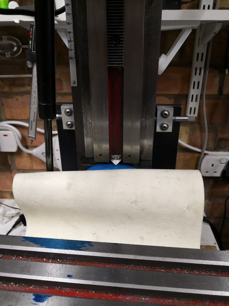

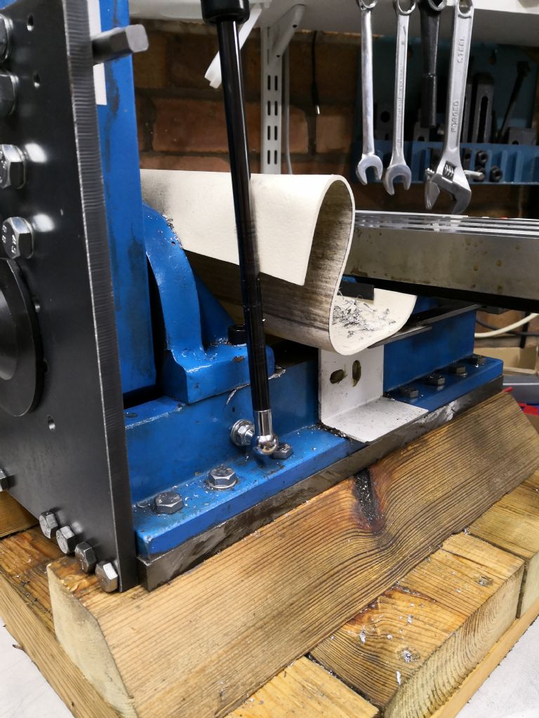

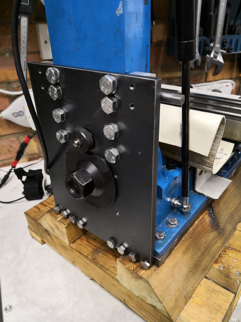

          Neil seems like we have similar ideas this is the back of my 9512. On my mill the back of the column is not level with the bottom of the base. So I added a base plate to give the required protrusion and hopefullh add a bit of stability.
          Base plate
          I've added these blocks and screws near the top of the additional plate to accurately tilt the column left of right with a find threads they work really well to dial it in within 0.01mm over 100mm then the rear bolts are tightened to lock it in place.

            I can tilt forward/back by pushing the head up against the table with a clamp screw before tightening the rear bolts also. So I have the ability to adjust the column but need to measure it accurately first.
            I have also thought about using a normal not reference Square and rotating 180degrees, make another measurement and if the 2 measurements agree then column is out, if both measurements show a taper then the square is out this is how I believe my squares are not square! But also added in there is some movement of the square and the table as above is also not flat…

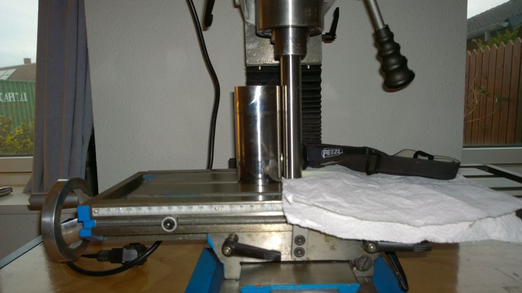

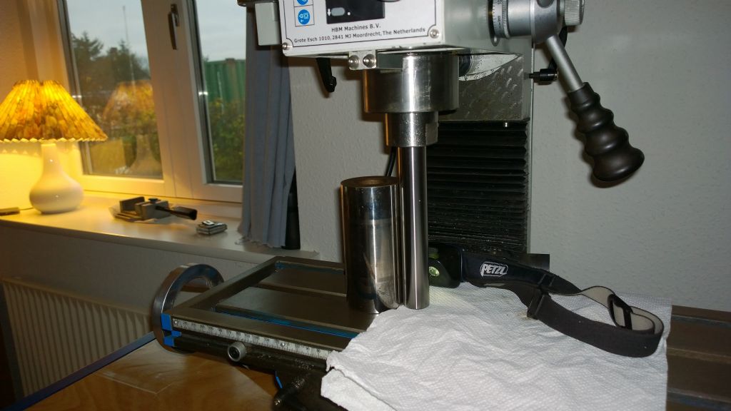

                            TramSystemCheapoPosted by Niels Abildgaard on 01/12/2018 19:08:09:
                            A borrowed diesel piston pin with one end on mill table and my trusted MC3 testbar in spindle of milling machine and a light-source convinced me that my mill was OK.
                            Only problem is that test bar has no pull in thread so I was always prepared for drop down.
                            It did not.
                            some pictures
