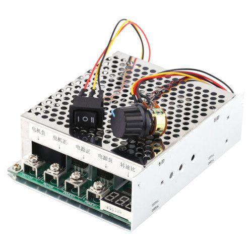

      I,m not too bad with electrics but a bit dull when it comes to electronics and would appreciate some advice….is it possible to connect and operate an identical pair of DC motor controllers from one speed potentiometer..?
      The controllers come wired with a potentiometer which has 5 cables,  if I wire the two sets of 5 cables to one pot will it work..?
      Also the controllers are wired with 3 cables to a double throw reversing switch, again could they both be connected to a single switch..?
      I wondered if it would cause problems between the two controllers or not work at all or even cause damage to the controllers.

          I'm no motor control expert, but electronic basics would indicate that the two circuits would need to be kept isolated. This is easy though, you just need a Double Pole Double Throw (DPDT) switch and a dual gang potentiometer. The latter being two pots on a common shaft. Both cheap and easy to source.

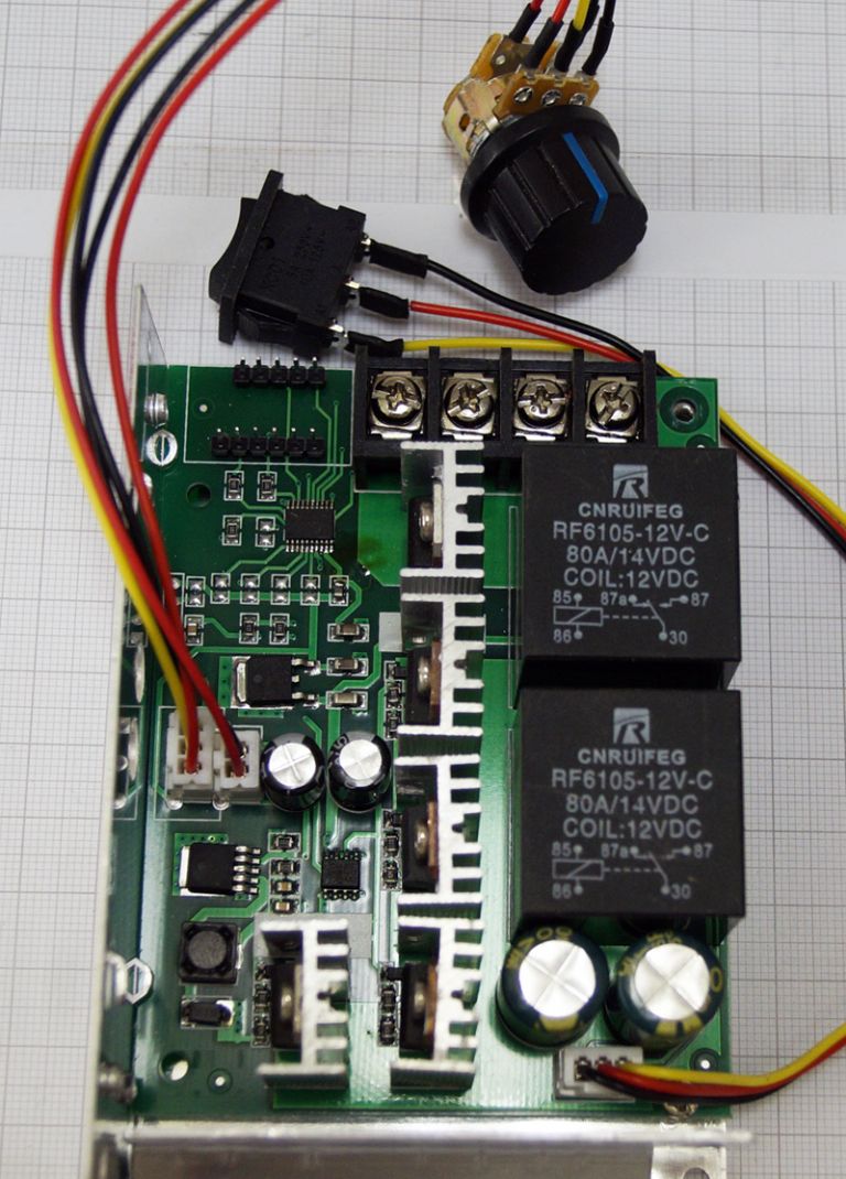

                            Can you provide details of the controller model?
                            The more advanced conntrollers actually use a 0-5V (or similar) control voltage which is generated by a potentiometer a 5V supply. If thi is the case you could use a single pot with 3 connections (common, 5V and variable) to one controller and two (common and variable) to the other. If they are cheap ones using a RC circuit then you will need a dual potentiometer. Make sure that it is linear NOT log or "audio" taper. The matching between sections would normally be better than 5%.

                                        Now I've looked at those budget controllers I concur with SOD. Without getting them on the bench and having a poke around at the circuitry to find out exactly how the pots are connected into the gubbins it might be better to stick to two pots on a common shaft.
                                        As these controllers are PWM devices I'm sure it could be done in the way I suggested with an Arduino but it would take a little R&D to avoid letting out any of the blue smoke.

                                              Thanks guys, I agree that the simplest option is a dual gang pot and providing any output difference from the two controllers is reasonably small I cant see there been any problems. I have been searching and found a lot of 100K dual pots but I still havnt found a 100K linear "switched" dual which is what I will need.
                                              Brian, a picture below of the controller should you be interested, it means nothing to me but you no doubt understand it.
