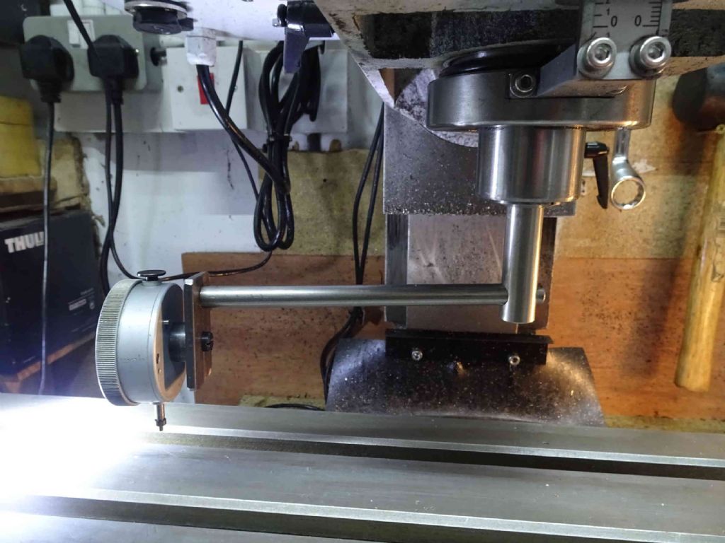

                  Iain Downs
                    @iaindowns78295
                    IanT – that looks an interesting design, but I think it's overkill for tramming.
                    Here's what I made
                    It's a 16mm bar with a 10mm hole cross drilled in and a set screw in the bottom. The indicator on the end is a micron indicator I won from ebay a while back, but it's easy enough to mount any indicator on it.
                    The trick with tramming is that the operation is entirely symmetrical, so whist there may be droop due to poor rigidity, it will be the same on both sides.
                    I used this today to re-tram my mill which had gone well out of tram (by 2mm over 330!) probably because I hadn't properly tightened the head last time and some dig-ins due to an odd material. I appear to have improved that to 7 microns over the same distance which is better than I expected. the majority of that was due to tightening up the head bolts!
                    Iain
                    #513169
                    Clive Foster
                      @clivefoster55965
                      Iain
                      Simple and effective. Nice job.
                      Pretty much the sort of thing I was going to make to tram my Bridgeport head based on an essentially the same design I found somewhere. Then I thought "Hang on, I've got that co-axial indicator. If i point the long bent probe out sideways it will do pretty much the same thing!".
                      The rest is history but a co-axial is floppier and inherently less accurate.

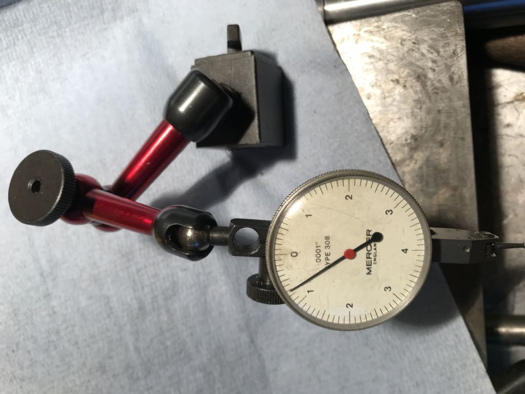

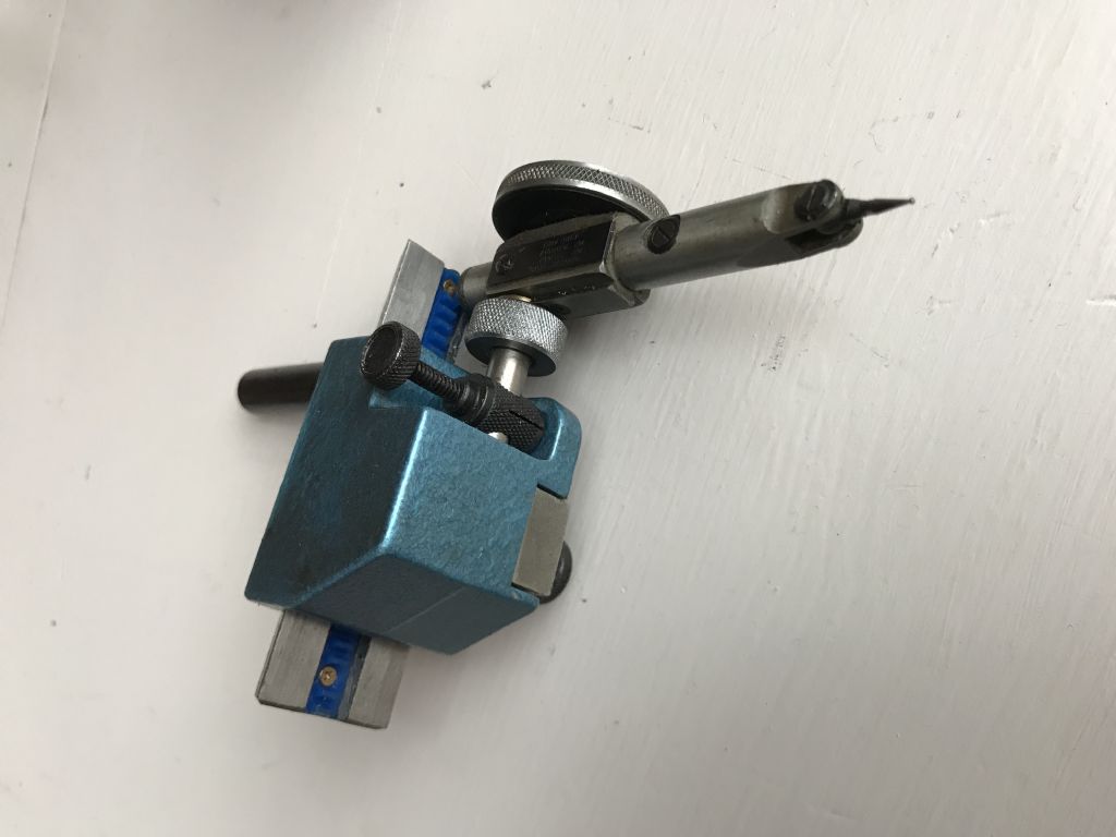

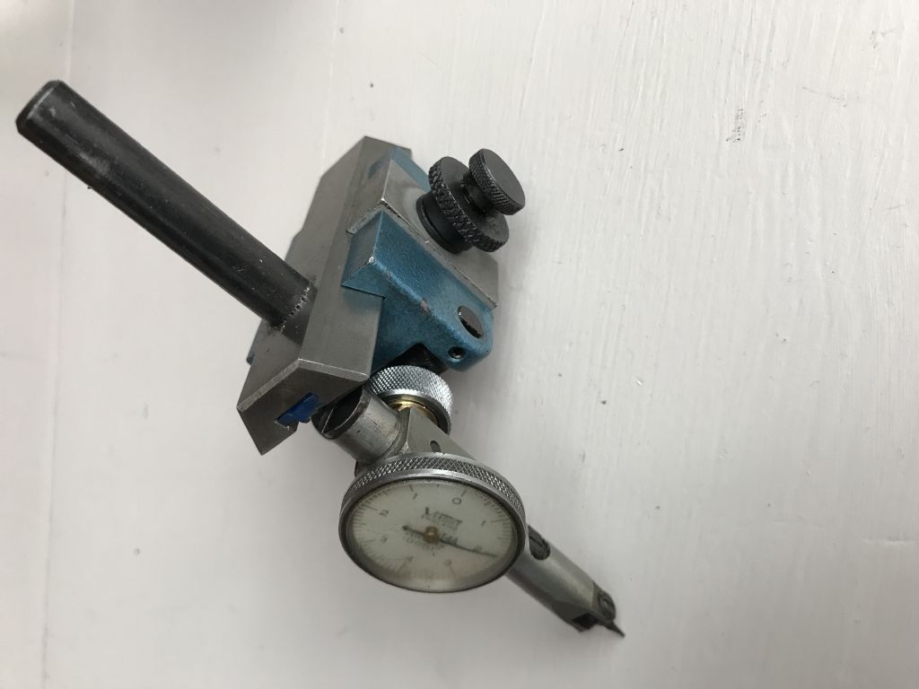

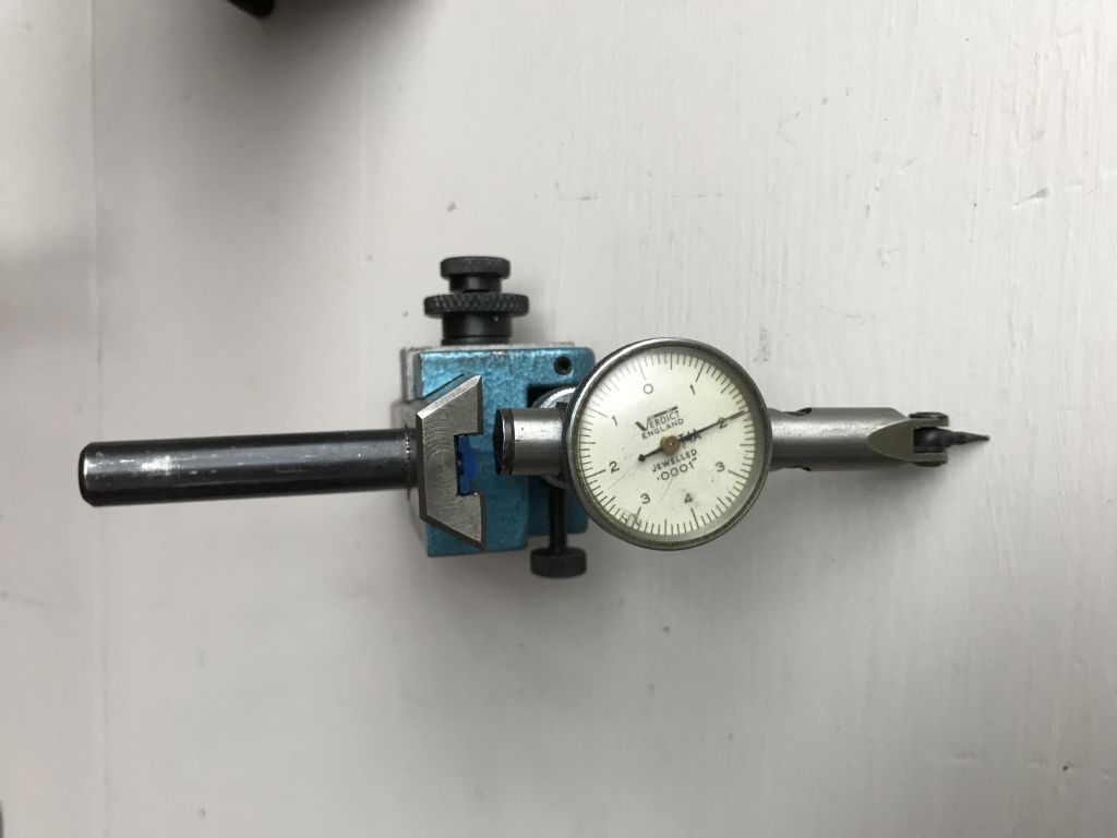

                      Oily Rag
                        @oilyrag
                        Below are photo's of the Hole/spigot centre finder I mention in a previous post. I can't remember where this came from but suspect that I bought it in the States during a visit whilst working there about 20 odd years ago. I thought it was a dinky little piece of kit and has proven to be accurate, easy to use and robust.
                        Here is the Mercer 1/10th division large dial dti I generally use with it

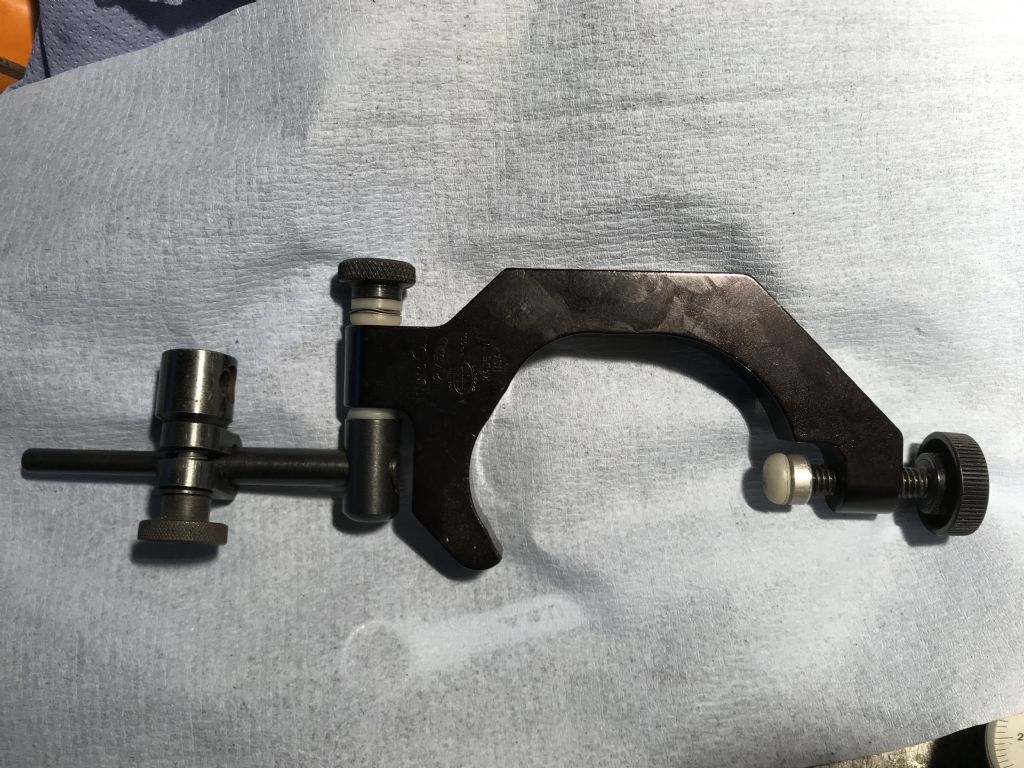

                        And for tramming I use an 'IndiCol' clamp which goes on the vertical quill. This Is used in conjunction with a large diameter (about 10" or so) outer bearing ring laid on the table to get over the Tee slots. On my mill the table, which can be swivelled and tilted, or just tilted for the standard table, has a taper dowel for setting to zero. Likewise the head which also swivels is also fitted with a taper pin to locate zero, This makes re-setting a straight forward procedure. I do occasionally check after moving either but there has never been any inaccuracy as far as I can witness with the kit I use here. Here is the IndiCol:-
