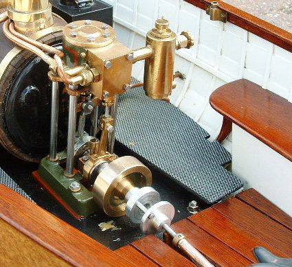

                        MichaelR
                          @michaelr
                          Posted by pgk pgk on 03/03/2018 14:07:52:
                          Thinking lazy…I wonder if one could et away with an expndd metal sheet bedded onto steel plate with a thin layer of clear epoxy?
                          pgk
                          I used that method on my model boat, bonded on with Araldite, then painted matt black then fine sanded the paint off the diamond ribs. The alloy diamond mesh was from a car body repair kit. Mike Checker Plate
