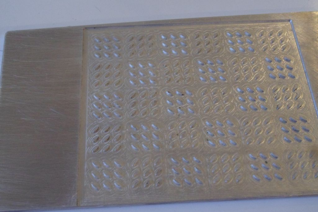

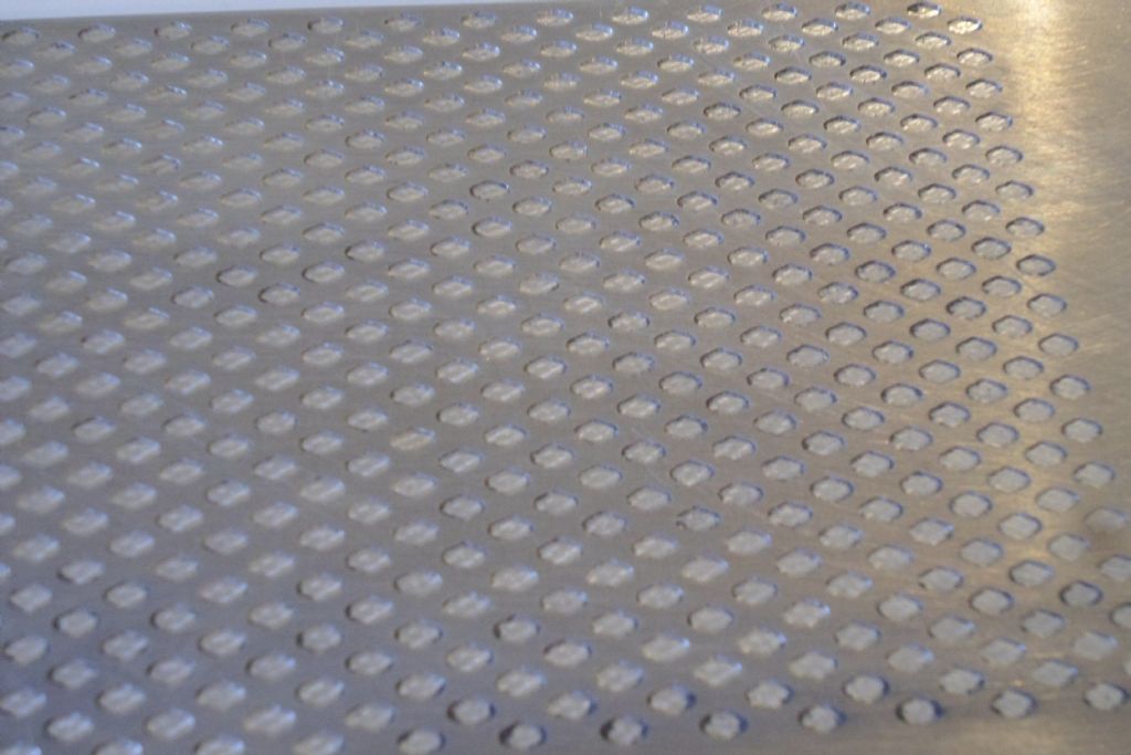

      hi all
      as suggested in previous thread have machined my own , diamond pattern not to happy with will try to machine with the diamond raised the other design iam happy with
      what do you think ?
      Edited By geoff adams on 07/03/2018 18:01:28

          Second one looks OK.
          Hope you CNC'd it and didn't do that by hand…
          #344903
            Of the two the second one looks better but as it is for a steam engine may look a bit too much like modern 5 bar "checker plate"
            The problem with trying to mill true diamond pattern in such small scales is the diameter of the tool leaves too big a radius in teh corners.
            You could try single bar plate as that is a bit more traditional and seen on things like grating covers and steel stair treads

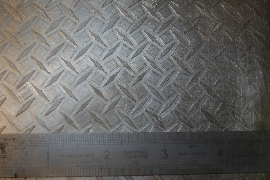

              tractor man done a drawing to your photo running on the mill as I type will post pics for your comments
              Thanks Geoff
              #345218
              geoff adams
                @geoffadams14047

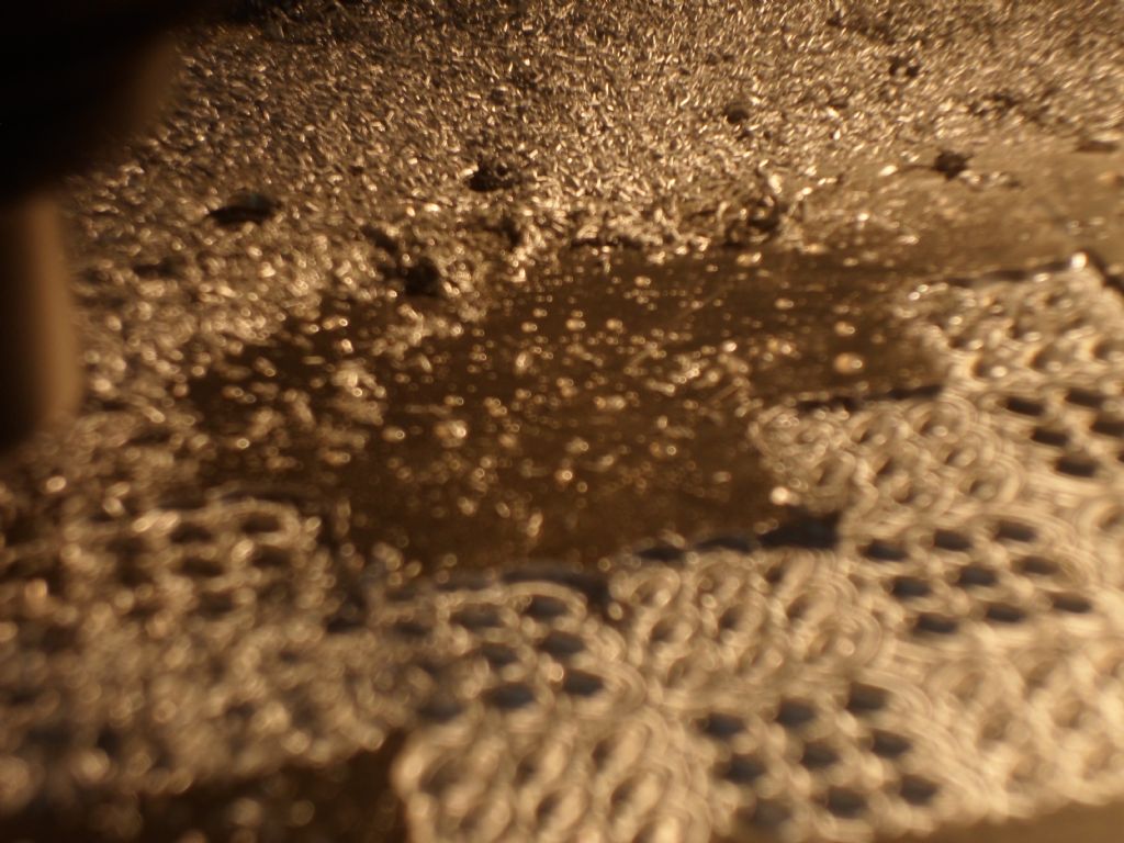

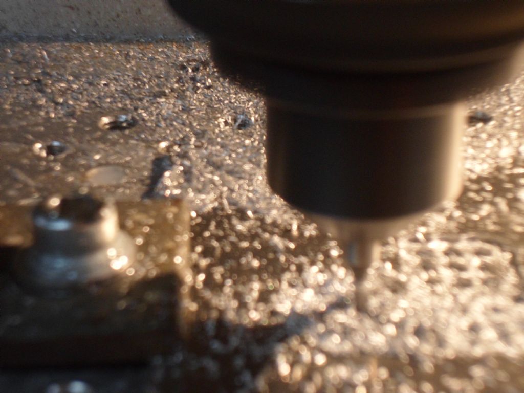

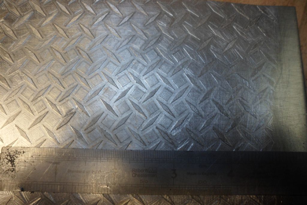

                sam_0315.jpgsam_0314.jpghi
                impressed with myself got pics from camera to my album without my boys help ( dad shown you how to do this its easy) not for me
                taken tractor mans photo and done my take on it machined on the cnc over 3 hours of machining gave up in the end and stopped machining dinner ready

                #345219
                geoff adams
                  @geoffadams14047
                  sorry jasonb photo
                  Geoff
                  #345241
                    That looks a lot better and more in period for a steam engine.
