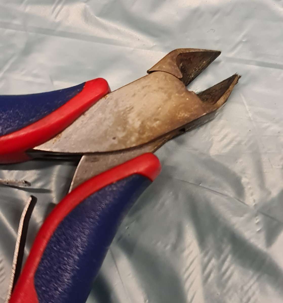

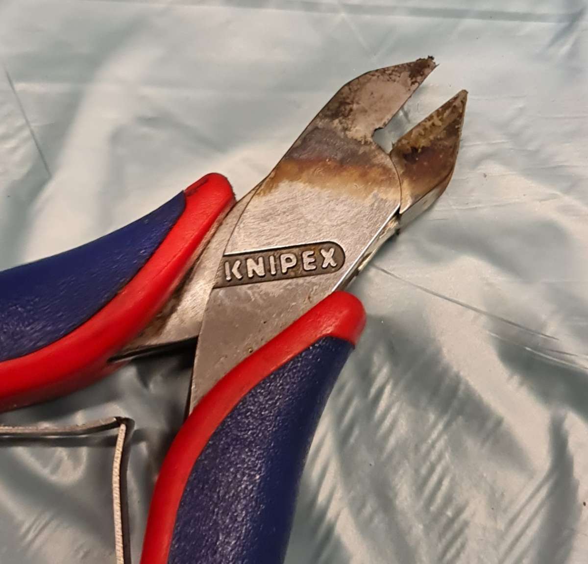

          On Fulmen Said:
          I really can’t recommend hydrochloric acid for this use. Sure it works, but it’s also good at causing rust on everything else around.
          Yes, I’m afraid you are right. I used these pliers to cut the bottle cap. And look how it looks after a few hours!!! It didn’t even come into contact with the liquid. Just from the vapors I think. The pliers were like new before…

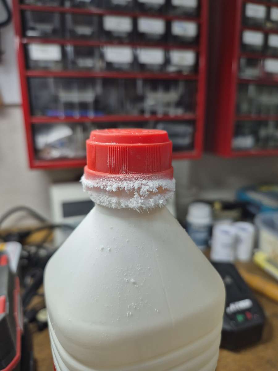

            There you have it. And yes, it’s the vapors. Hydrochloric acid is quite volatile and will leak out of any container. In old laboratories it was always easy to see where the acids where stored, anything metal around it was always corroded.

                                  Top of my supermarket hydrochloric acid bottle after a few months storage:
                                  20250608_121914DDefinately not good to keep near tools.
