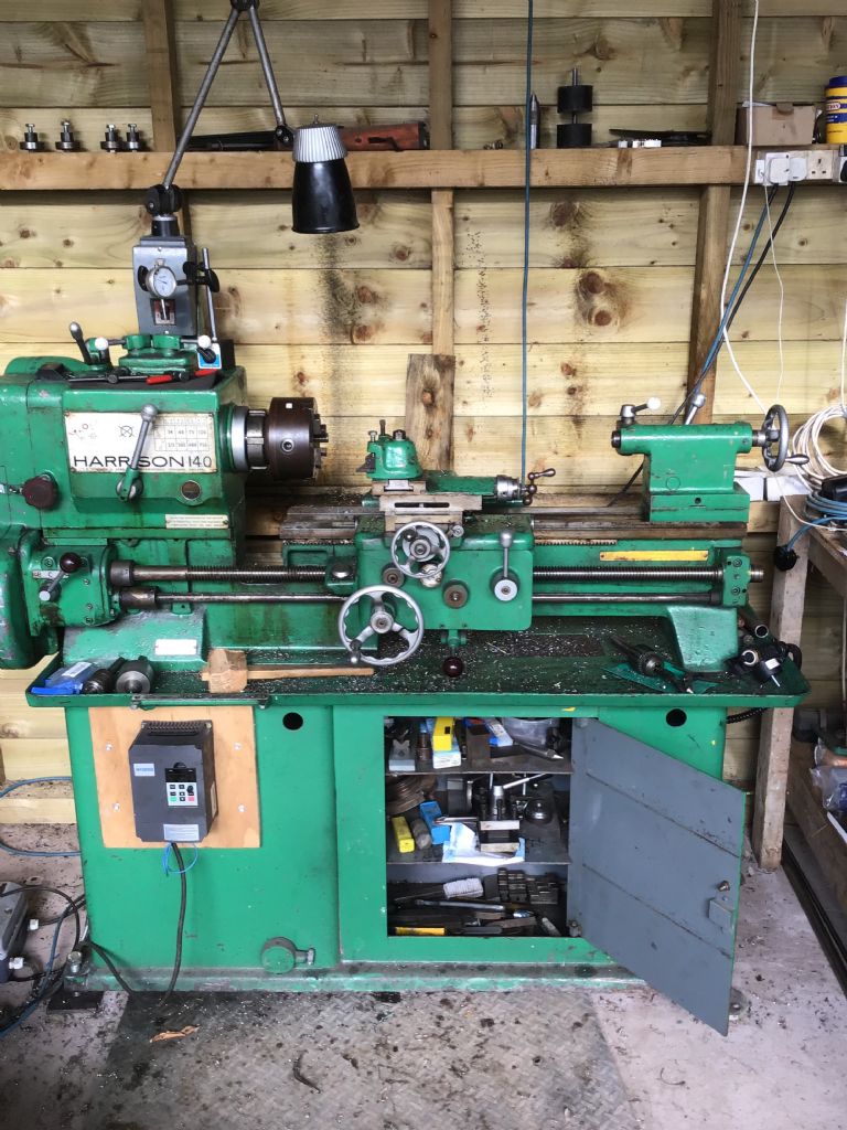

      Hi,
      I recently purchased a Harrison L140 3 phase lathe. I fitted a VFD drive direct to the motor (reconfigured to 240v) and have been using it to make some 35mm stainless shafts. I need to buy a 4 jaw chuck but don’t really understand what I need to buy. What is the easiest way to swap from 3 jaw to 4 jaw and back again. Does my current 3 jaw chuck have a faceplate that I need to match or is it easier to buy the 4 jaw with a faceplate and the specific thread to fit my lathe?
      Any advice is greatly appreciated.

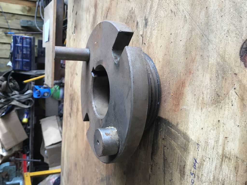

        #434152
        David Capewell
          @davidcapewell42676
          This was in the cabinet with the lathe.87da9650-00a4-4838-b7e7-42653d834cb5.jpeg0115cc72-5bdf-43b8-bd9b-53b4cbf052c1.jpeg
          #434192
          old mart
            @oldmart
            If your lathe uses a L00 size backplate, (check the size) it will cost around £100 for the plate. From the picture, your three jaw is fitted to a separate backplate, but as three and four jaw chucks vary so much in registers and bolt fittings, it would not be easy to get both types fitting on the same plate.
            How do you expect to stop the lathe in an emergency with only the VFD controls? The stop button is tiny.
            #434198
            David Capewell
              @davidcapewell42676
              Ah I see, I’ve just been doing some research on chuck fittings on lathe.com. It seems like quite the minefield. My VFD is wired with an E stop and isolator (grey box bottom left) it’s slighly out of view In the picture but when I’m using the lathe it is right by my feet so I can use this as an emergency foot brake. It’s a bit ‘Flintstones’ at the moment but I’ve got a 2.2kw motor to go on when I get chance and then everything will be wired correctly. 🙃
              #434200
              David Capewell
                @davidcapewell42676
                Yes, your right it is a L00 fitting…….thanks

                  homeandworkshop.co.uk have nice looking 10” diameter one £175 ,oops mistake, in edit, that one is a L0 not L00
                  stopping in emergency is easy with the clutch on these machines. Stopping with the vdf would be slow due to the ramp down timing, depending on how it is set.
                  Do ensure there are no switches between the vdf and the motor or you will blow it

                    When you do wire it finally I suggest that you put a box with decently large shrouded buttons for start & reverse along with a mushroom headed stop button just under the chip tray about where that round hole in the stand is. Buttons pointing out horizontally but not beyond the tray.
                    I did such with my old SouthBend Heavy 10 toolroom and found it to work very well indeed. Buttons easily found and always accessible. My Smart & Brown 1024 VSL has the factory arrangement with the buttons on an angled panel effectively running up from the inside of the chip tray towards the headstock with its right hand edge a little back from the right hand edge of the headstock. Perfectly functional and button visibility is better but, I feel, placement not so good as being a bit too far to the left.
                    Tromp bar along the front of the machine is better than a foot button fro the emergency stop. Probably not something I'd change if I had a fully working system but if installing "do it right, do it once".

                      What make and model VFD is it?
                      That L00 catch plate could be modified to use an er32 collet system for small jobs, like this one:

                          I must admit I was in quite a hurry to get the lathe running as I had some 35mm shafts to make for a job. I had made the first few on a Myford ml7 but it was taking too long. I saw this lathe about 3 miles from home and at the right money so I jumped into gear. Cutting key ways and roughing out is so much faster on the Harrison. The VDF was a cheap £80 one from Amazon which has an extendable panel which can be mounted in a more suitable position and has analogue inputs for controlling it via an Arduino or similar. When I have a quiet Sunday afternoon I’ll fit the bigger 2.2kw motor to the lathe and install some easier/more accessible controls and estops. The footbar across the front will definitely be on the list because if I get tangled up in my headstock then no one would here the screams over the generator!!
