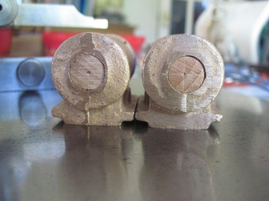

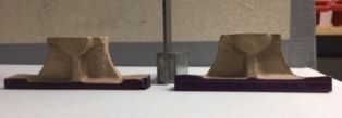

      The Above are castings of the bearing brackets for the Tina Mill Engine.
      Having practiced milling on my new mill by making basic clamps I am now ready to mill castings. Can experienced members advise me the best way to get a datum face on the castings before I set them in the milling vice. I think I need to make one face true before I start milling to give me a datum ( is this a true statement) easy simple methods to achieve this will be most welcome.
      Thanks for reading.

          What you really need is MEW 289 Milling for beginners that is about dealing with odd shapes and castings!
          Without the drawings and castings infront of me it's hard to be exact but I usually go over the castings with files first to remove any unwanted mould part lines etc.
          Next compare the castings to the drawing to see where metal needs to come off and how much machining allowance has been given, this will save you taking too much off the first surface and then finding you are short on the opposite face.
          At a glance I would make the bottom surface my datum and first surface to be machined flat (does not have to be to finish yet) I would hold in the milling vice upside down with the length of the casting along the length of the jaws, slip two equal height packets (drill bits, lathe tools, parallels) across the two jaws to support the work and set whet will be the upper bolting surface horizontal. Then mill the base flat, you should also be able to take it to width and length at the same setting.

              As Jason says, it all rather depends. First step is always to knock the lumps off with a file. A good next step is to mark the castings out, with (say) the base underside surface and shaft centreline. Also mark out the base in relation to it's axial position with the bearings and spot where the holding down holes will come. You will soon see where there is not enough metal (happens on commercial castings too often) and too much metal, and can adjust your marking out accordingly to get the best shot at the casting.
              I would then probably go for a preliminary cut on the under foot and the long side of the foot – not to size at first, just to give you square edges.
              On complex stuff it can be like knitting with fog to get a start. A dodge then is to cut card templates to actual size and sight them against the casting to get the best shot.

                  For your castings I'd do exactly as Jason advises and clean it up and then very lightly machine your reference surface. It's easy to assume that a casting has enough 'meat' all around and to try to get down to a clean surface on the first pass – and then you find that there is not enough left elsewhere to end up with the stated dimensions.
                  I've recently machined several pairs of cylinder castings for use in a published locomotive design. There wasn't enough metal to get smooth surfaces all around in either pair- so you really have to decide where to compromise or simply change the design. For these castings of yours (and any other castings involved) it will pay to look at the item "in the round" and make sure you don't have to adjust something before you start.
                  In the cylinders I had to balance the machining at each end-face because the friend I was doing them for had already ordered laser cut frames (to the drawing) and the cylinder cut-out is oversize to the available metal in the castings supplied. Both ends could have been cut back to clean surfaces if the frame cut-out could have been reduced. The design also specified a 1/2" bore but on both cylinder sets the core was already 12mm and the cores weren't central either (one cylinder was offset by nearly 3mm) so to bore & ream them to the given size was impossible.
                  The flanges need to be symmetrical to the body, so I always set-up based on those (rather than the bores). The final bore size (pre-reaming) on this pair was about 16mm & I obviously had to do both cylinders the same. I'm sure it will all pan out but with castings you really have to have a good look at them and think ahead a bit.

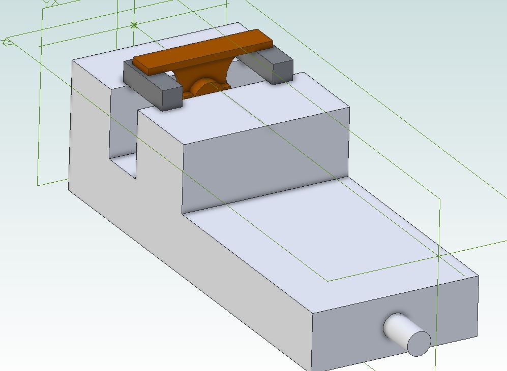

                      Something like this

                        Jason thanks for the CAD drawing that makes sense to me and I will adopt it and hopefully make changes as and when other castings need it. As for MEW 289. The one month I don’t buy it there an article that would be useful to me. I can’t get one anywhere at the moment so I’m hoping I can get a back issue next month. Thanks for your time and help it’s very much appreciated as a newbi.
