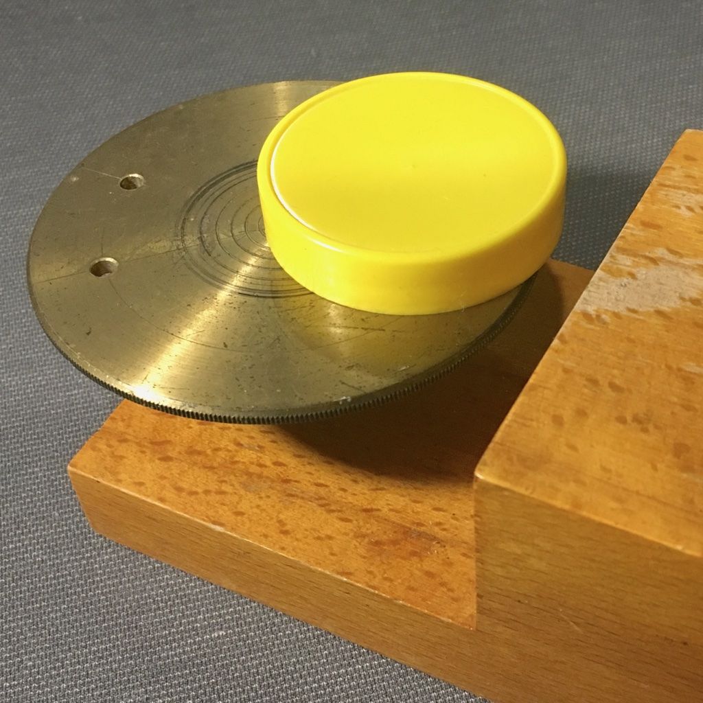

                                                      O.K. … I'm fed-up with searching for something whose name I've forgotten: So here is a 'Blue Peter' concept model
                                                      The Brass disc represents the nascent FacePlate, on the spindle of the Watchmaker's lathe.
                                                      The Mustard jar lid represents a Cup/Bell lap, the edge of which is loaded with compound.
                                                      … It is rotated by the auxiliary spindle [Dremel tool ?]
                                                      Hopefully that clarifies how the 'Catherine Wheel' marks get produced.
