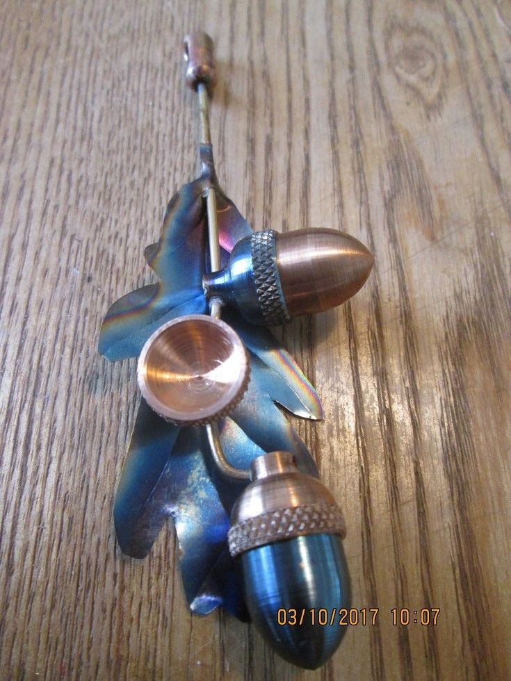

        I'm making some Christmas trinkets and will want to fix some titanium bits onto 1/16 brass stems.
        The Information Superhighway wasn't encouraging when I tried looking up soldering titanium – in fact it looks as if jewellers are using the stuff for clamps precisely because of its solder-resisting capability.
        Does anybody have any more hopeful tales to tell, or should I just reach for the Araldite? sad

          It's a bit like aluminium. It resists corrosion because it's a very active metal that reacts with atmospheric oxygen to produce a tough oxide on its surface. This isn't a good recipe for soldering.

                I've already made the bits, and the family like the iridescent blue oxide coat you can get by heating.
                Well, 297 views and 3 replies (for which thanks), all negative – looks like it's Glue Time! 😀

                    My cunning plan was to blue it first, then open up the hole I was gonna solder the 1/16" brass into to expose bare metal. Soldering temperature wouldn't be enough to affect the blue.
                    But I tried it on a bit of scrap titanium and a half-inch of the brass rod, and couldn't make it work. I wondered if there was some miraculous flux available that would get the titanium to tin.

                        Have you tried the old trick for soldering aluminium ? Scratch the joint with a stainless wire to expose the bare metal ? I don't have any titanium lying about to try.

                            A quick and short answer is NO.
                            Certainly not in the average shed.
                            Some general examples of the methods and problems given here…. **LINK**

                              Further informationon brazing options here at Johnson Matthey – Brazing Filler Metals – Ti-Flo Filler Metals.

                                Yes, it evidently can … see here: **LINK**

                                  Yeah, thanks for the research, but rocket science is getting to be the issue. Some of the other bits are PB102, which is why I was hoping to use solder to attach them as well as the titanium bits. I've got butane torches and multicore solder, and I think we're getting a long way outside the scope of those.
                                  There's a possibility of mechanical attachment if I make extra threaded holes for titchy grubscrews inside some of the bits where they won't be seen. But there's a leaf made of titanium foil to attach too, and I can't see an alternative to glue for that.

                                          I've used a spot welding machine to resistance Silver Solder 3mm Stainless Steel pivot pins onto Stainless Steel parts and I've used the same machine to weld Titanium threaded inserts onto 1mm Titanium sheet so I wonder if it might be possible to use one of the filler alloys (http://www.jm-metaljoining.com/products/ti-flo) listed for titanium for resistance brazing in conjunction with the correct flux?

                                            Thanks a lot for your thoughts, folks – if I'd had something more serious to make I'd've probably taken more of them up.
                                            In the end, the only soldered joint was the brass stem to the PB102 loop for the chain to go through – it's a sort of acorn/leaf pendant:-
                                            If it's liked by the family, I might make more of them.
