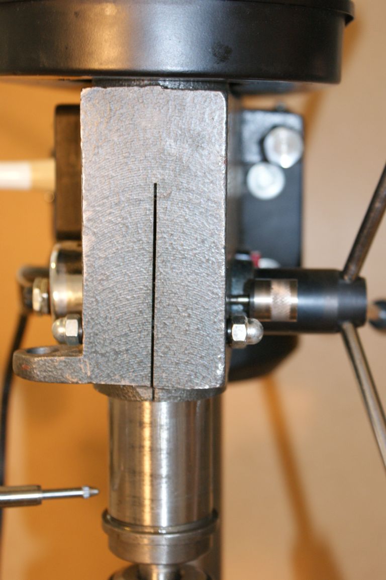

      Hello all,
      I own one of these:
      nutool pillar drill
      It has done me well for quite a few years and can make some quite meaty holes. However I am getting a bit tired of the slop that exists in the quill – there is around 20-30 thou of play and if you are drilling holes <5mm one has to consider what under-size drill bit to use to get the desired sized hole.
      Anyway, my question is – can I repair this or is this an integral part of the machine that is worn? I haven't bothered to take it apart yet as I wasn't sure what I'd be able to deduce.
      If it's any help the grub-screw and locking nut on the side has about 45° of free movement but is otherwise completely stuck.
      Also, as a side note, if you are having a feel around this machine, do not stick your fingers up the 3" hole that exists directly behind the quill whilst the machine is connected to the mains. It will hurt!

          Hi Thomas,
          The stuck grub screw that you mentioned is the cause of the problem. The screw has a square machined onto the end of it, which in turn engages into the keyway on the quill. The problem is that this limits adjustment considerably and means that it either locks up and locks the quill or it is left as is and allows lateral movement.
          I had the same problem with mine, you need to axtract the grub screw and file it so that you file the square corners off and bevel the head so that it can freely turn inside the keyway, that fixed mine and made it a really useful tool again, so much so that I ended up making a brass shoe that fits into the keyway and is engaged via a hole in the shoe that the grub screw locates into.

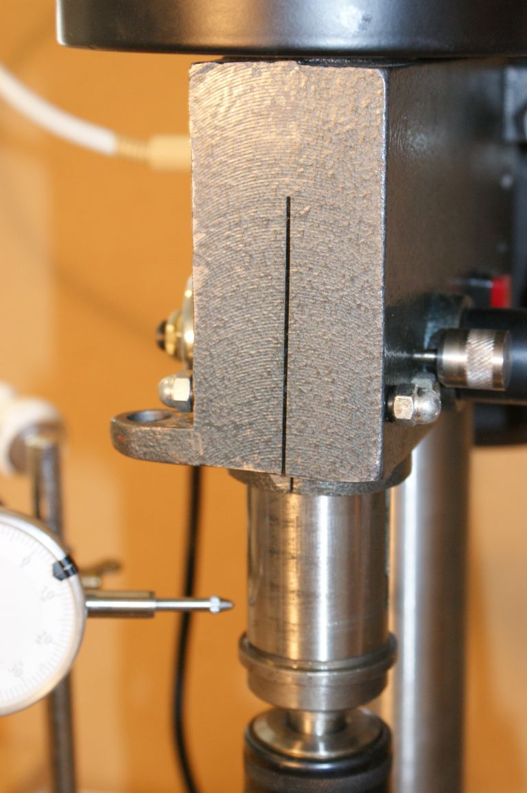

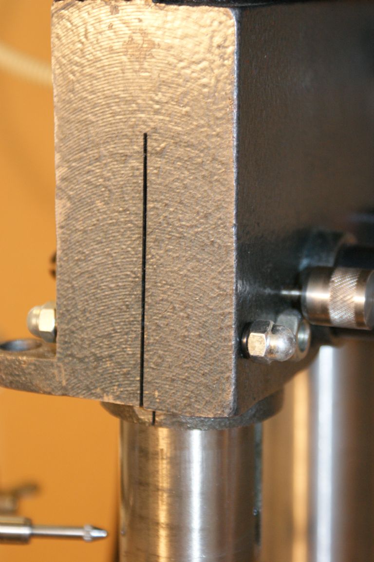

                                I did the slit modification on a small Chio drill press. In the Chio head, there were two journals that carried the quill. There is absolutely zero play in the quill now, and the machine feels so much better with one less thing to worry about.
                                The two domed cap nuts are lightly tightened to close up the slit.
                                The test dial moves a mile if I press lightly on the table with my little finger! That's another problem I have to deal with sometime.
                                I had no qualms doing this modification on a cheap drill press; there was not much to lose. In fact I would go so far as to say that you can't really go wrong by doing it.
                                By cutting a slit in the two journals, the quill vertical alignment will be slightly altered and the quill will move out of the vertical by a thou as the head casting settles around the quill in a slightly different location. There was a couple of millimeter of play in the quill before it was modified, so the vertical alignment change is not really an issue to me.
                                Correct me if I am wrong, but I think the slot in the side of the quill, that the screw/lock nut bears on is just there to stop the quill from rotating, and not there to take up any play? Any thoughts anyone?
                                Steve

                                                I mounted the dial indicator stand on the column, and took a few readings off the table.
                                                1 finger on table pushing down, light to moderate pressure = 0.05 – 0.1mm movement
                                                1 finger on table pushing down, hard pressure = 0.2mm movement
                                                2 hands on table pushing down, hard pressure = 0.6mm movement
                                                I initially mounted the indicator in the chuck and got worse readings. This is due to some flex where the column is attached to the base and also to the head.
                                                Whilst drilling and pushing down hard, I can often feel and see the table flexing. I'm pretty sure it is due to the insufficient small parallel ribs on the underside of the table casting. If the ribs were triangular, with the thick bit towards the column, then that would beef it up a bit and maybe stop it flexing so much. There is a mod to be had there!
                                                In conclusion, only use very light pressure when drilling.
