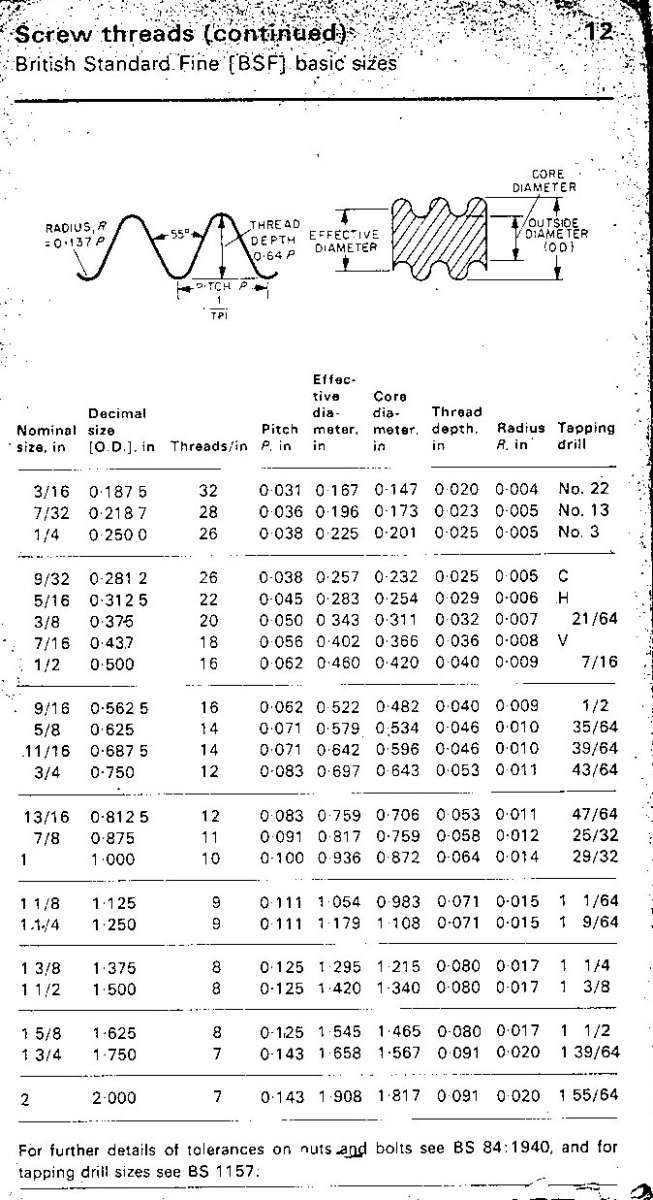

      I need two short BSF 11/16″ diameter bolts but can’t seem to find any (UK)  any ideas?

                Hi, plenty of charts showing 11/16″ BSF, but it maybe a non-preferred size though, which maybe why it isn’t always shown.
                BSF Threads
                Regards Nick.

                              My 21st edition of Machinery’s Handbook has 11/16″-14 BSF listed in the thread section on BSW and BSF threads just before B.A. threads. It also has the sizes for the hex heads and nuts in the relevant section but in those tables it does not list 11/16″ BSF, but since the hex on an M20 bolt is similar to the one for 3/4″ BSW/BSF I felt it would be suited to an 11/16″ BSF bolt.
