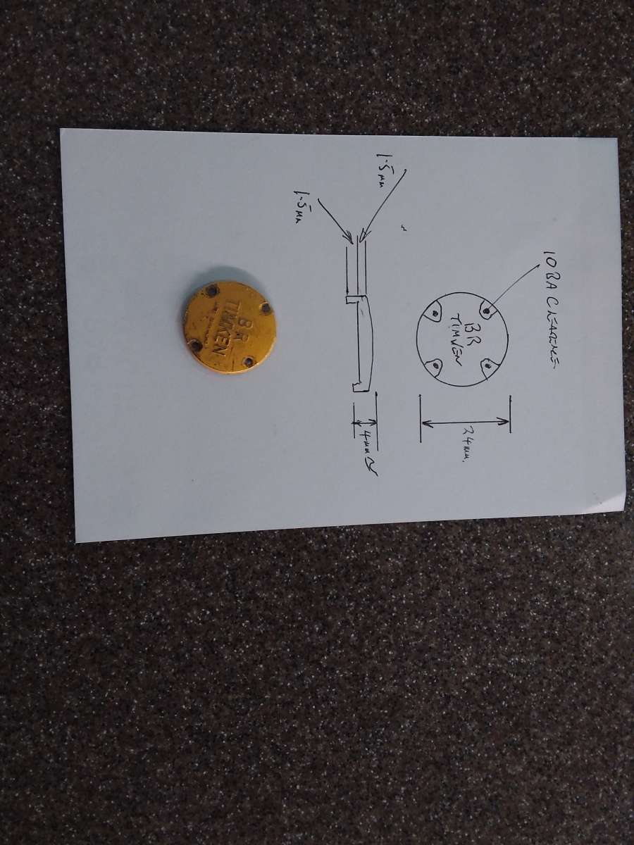

      Hi just starting out in 3d printing. Anyone got an SDL File for aBR TIMKEN axle cover. I have tried thingyverse, but unsuccessful

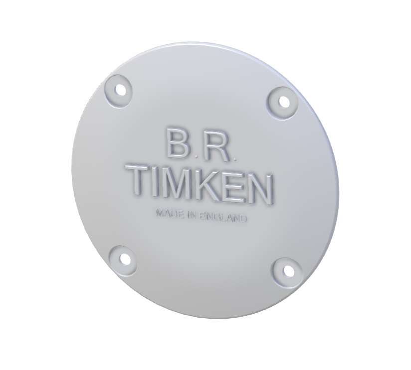

                  As you haven’t replied, I assume that you’ve found a suitable source file.  However, being at a loose end this afternoon, I’ve had a little play around with Alibre Atom and produced this:
                  GR Timken axle box cover
                  I think it approximates to the picture that DC1 referenced, above.  The overall diameter is 90mm, the mounting holes are 4mmØ and the counterbores are 10mmØ.  I have saved the file as both STL and STEP, too. The STEP file will print at full size on my printer in under 45 minutes, according to the slicer software with unmodified settings and can obviously be scaled up or down, if necessary.

                    Hi, John sorry for late reply, I am one of those folks with signing on difficulties. Now hopefully overcome. You are correct, I should have said STL file! This is the part I spoke of. Is an axle box cover.   What do you think?20240113_122920

                      Hi John, this is fantastic, scale for my 5 inch loco doesn’t quite fit?  At 90cm  seems big even for a full size loco. But we’ll done can you scale it down? As per my last message the ones I need are 24mm in dia
                      Cheers Philip

                        I only chose to draw it at 90mm diameter as an arbitrary size, just to get some idea if I could replicate it.  I’ll try to scale it later and report back.  What is the diameter of the recessed area on the back?  PM me the answer with your email address and I can send you the resulting files when they’re done.
                        My CAD – Alibre Atom – doesn’t allow me to emboss onto a curved surface, I’d need to upgrade to the Professional edition for that.  I could try to model it in Fusion 360, but I’m not so handy with that, so it’ll take a bit longer.

                          John a i t is shuch a flat curve you can probably get away with a straight extrusion but make it longer than needed. Then do a revolved cut with a curve slightly larger diameter than the solid which will cut the excess off the letters so they stick out the same amount.
                          Philip, your printer’s slicer software should be able to scale the file.

                            I originally did it that way, but the diameter is so small that it all got rather cramped.  I’ve redone it using Fusion 360 and saved the stl and step files.  When loaded into the slicer, the “made in England” text doesn’t appear!  Haven’t got time to investigate now, but I might have time to test print one tomorrow.

                              Thanks for this, much appreciated.  Recess is 20mm dia. My email is …………………………

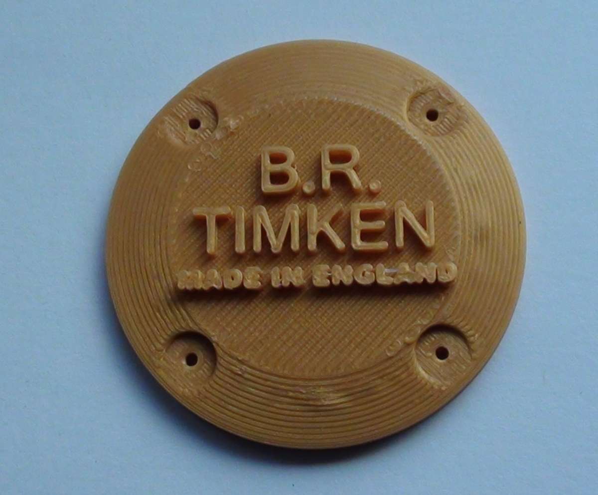

                                  To round off this thread, I’ve redrawn the whole thing entirely in Atom to attempt to get the very small embossed text to print.  After fiddling with numerous fonts and extrusions, this is what printed out with the “MADE IN ENGLAND” text at 2mm high in Arial Black font, extruded 1.6mm from the face.  Even with a layer height of 0.12mm, the result is disappointing in my opinion.  I guess some hand fettling would improve matters, but will take more time than I’m prepared to invest at the moment. Maybe using standard Arial font would make it less chunky?
                                  Test print
                                  Anyway, I’ve sent the files to Philip.
