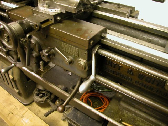

      Graham, Tony
      The P&W has two single tooth clutches, one for forward feed / screwcutting and one for reverse. There is no provision for reversing spindle rotation.
      Found another picture and clipped the relevant parts showing both clutches. The actual gear train drive path for forward & reverse is "complicated".
      Its arguable that P&W designed the whole machine around exploiting the single tooth feed clutches. The main drive clutch lives in an oil tight box on the back of the machine with matching holes in headstock and box so the drive gear on the output side of the clutch can poke through to meet the input gear on the main speed selection box.
      Control via a lever on the saddle which rotates the stop rod. Push down for forward, pull up for reverse. Stop rod is 7/8" diameter with appropriately massive clamps.
      Fine adjustment thimble on the left side of the saddle too. Its very convenient. Have to remember to stop the spindle with the main clutch above 300 rpm before using the single tooth clutches.

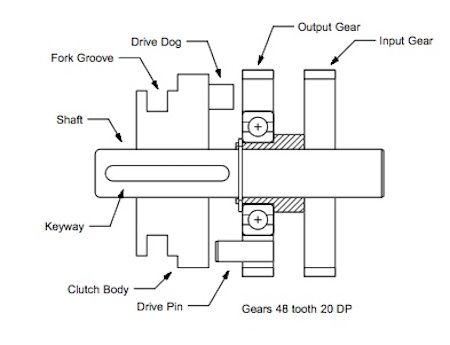

                    Tony, Graham
                    I'm struggling with similar space and output gear drive boss issues on the 1024. I have about 1" space behind the plane of the output gear and 1 1/2" in front of the plane of the banjo gear to play with. There is some upwards space above under a cover.
                    I have the 127 – 120 metric to imperial conversion gear pair permanently mounted so I only need to swop the spacer and gear order at the gearbox input to change. Headstock feed drive gear normally meshes with the 120 tooth transfer gear hiding behind the 127 gear in the picture.
                    I propose to use a concentric system with bi-directional clutch tucked over to the left of the picture. Something like this :-
                    Input gear and clutch body share a common splined or keyed shaft. Gear fixed, clutch sliding. The output gear is free running. The 127 and 120 tooth conversion gear pair will be reversed putting the 120 tooth gear on the outside to mesh with the clutch system output gear. An intermediate gear, not shown, will be needed to transfer drive from output gear to banjo gearing to avoid clashing with the 127 tooth gear which now lies on the same plane as the headstock feed drive gear.
                    Hopefully it will all sqeeze in.

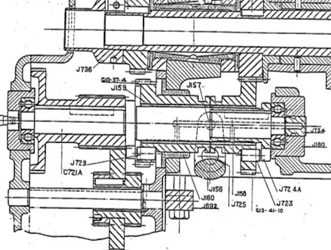

                    Graham Meek
                      @grahammeek88282
                      This is the cross section through the Maximat Clutch, note the one Dog gear takes its drive directly from the wider output gear from the headstock' This gear also meshes with the idler gear shown below to reverse the direction to the other Dog gear. (Shown in mesh).
                      The above are the elements necessary to make the dog clutch work on the Maximat.
                      Above are the two Dog gears, the Double sided Dog clutch and the output gear on the Clutch shaft. Only the Dog clutch is keyed to the Clutch shaft. Drive to the output gear is only achieved by selecting a direction with the control lever.
                      This connects to the stop rod which carries the stops.
                      These then are the elements required for a successful clutch.

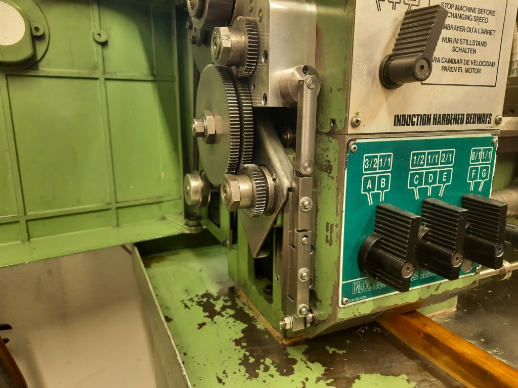

                            Above the two smaller cast iron gears and the Tufnol intermediary gear take the drive from the clutch output shaft to the new Banjo drive gear position.
                            As stated before the new Banjo drive gear position is on a common radius with the original Emco output shaft, taken from the screwcutting gearbox input shaft.
                            The photograph below shows the original shaft with the wide gear on and the new shaft at about 7.00 o'clock.
                            All the operating mechanism is hidden from view and goes under the headstock to the lever at the front.

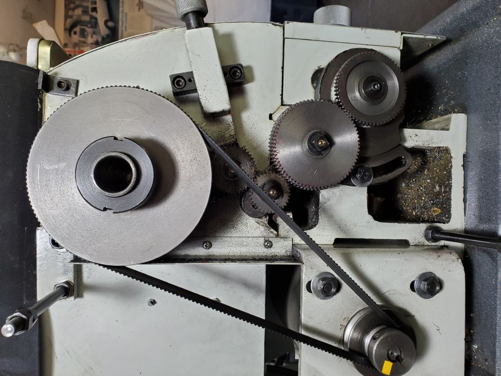

                                      I'm trying to understand how to adapt the Meek design to my Asian made 10×22 lathe. I've read many different adaptations but just seem to confuse myself more.
                                      Very very similar lathes to mine have had the clutch fitted to them successfully but my lathe has some differences and I'm not sure how to calculate the changes needed. The similar lathes that I have read about having the clutch adapted to them are the Grizzly and Warco lathes. My lathe is a Canadian "Craftex" 10×22 lathe with a bit different gear train in it.
                                      I'm hoping someone might be able to help me with what I need to figure out.
                                      I appreciate all the information and sharing you fine folks have done.
                                      Don

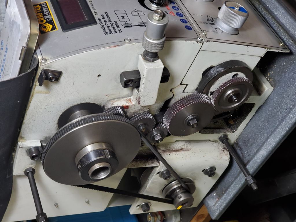

                                          #538087
                                          Don Pittman
                                            @donpittman39809
                                            Thank you for the guidance and information so far.
                                            I have read the Jim Schroeder article where he adapted the clutch to fit his Grizzly G0602 lathe. The G0602 lathe is very similar to my Craftex CX700 and I believe they are both built using the same castings/platform. I believe the Schroeder adaptation plan would be mostly correct for my lathe but……
                                            There are some differences between the lathes that would need to be addressed to make the Schroeder adaptation fit my lathe, but I do not have the mechanical mental ability and know how to grasp exactly how and what those changes would look like.
                                            My lathe came equipped from the factory with a reverse tumbler mechanism. Does this get superseded/eliminated with the clutch?
                                            My lathe uses module 1 gears as opposed to module 1.5 gears used in the Grizzly G0602. How and what do I need to figure out how to make changes for that difference?
                                            Here are a couple of pictures of my lathes gear train.
                                            Edited By Don Pittman on 04/04/2021 23:23:24

                                              Hi Don,
                                              The Tumbler Reverse Lever is redundant with a screw cutting clutch fitted.
                                              A lot of these machines have their heritage in the Emco Compact 8. This was adapted in the Far East to become the 918, which I am sure your lathe derivative is based on. I am also sure the photograph I saw of a screw cutting clutch fitted to a 918 will fit your lathe.
                                              I think the guys name is Brett Merkle? (I may have the spelling wrong, for which I apologise).
                                              He recently wrote an article in Model Engineers Workshop where he fitted a clutch to the main drive of this lathe. He is the man you really need to contact. Perhaps The Editor, Neil Wyatt would forward your email to him?
                                              I am sorry I cannot help any further than this.
