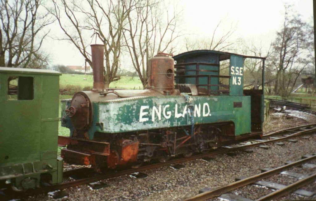

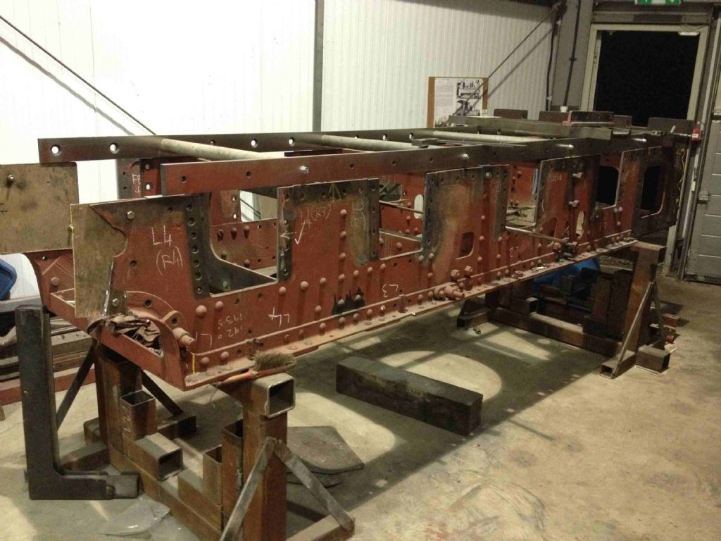

                          Perhaps I'd better explain a little. The loco is a 1916 WW1 Henschel which spent all its life after WW1 in Mozambique at the Sena Sugar plantation and was in use on a seasonal basis until around 1984. During its long active life it was extensivley repaired and welded many times but suffered from bolted components "working loose" and the bolted axle box horns are a good example of this.
                          The bolts were originally 18mm but we have had to ream the original holes to 3/4", 20mm and 7/8" also weld some depending on wear first, to make them suitable for a fitted bolt. As we need 32 bolts we plan getting a friendly cnc shop to machine them for us. The originals had a large size head and nut , rather like old Whitworth and we want to keep to that style. So these requirements rules out anything off the shelf. hence the question.
                          Difficult to gauge materials used at the time of the build but the horns and axle boxes appear to be cast steel. Another loco I have worked on which is UK built and 120 years old, also has cast steel axle boxes and connecting rods are like glass but have survived well so I can only think quite a lot was understood about using the correct materials in the right place.
                          We found this works photo of our loco in a book.
                          Condition when we bought it, complete but worn out!
                          Frames under repair showing the hornes and bolt locations. If you look at the frames carefully some of the welding repairs can be seen.
